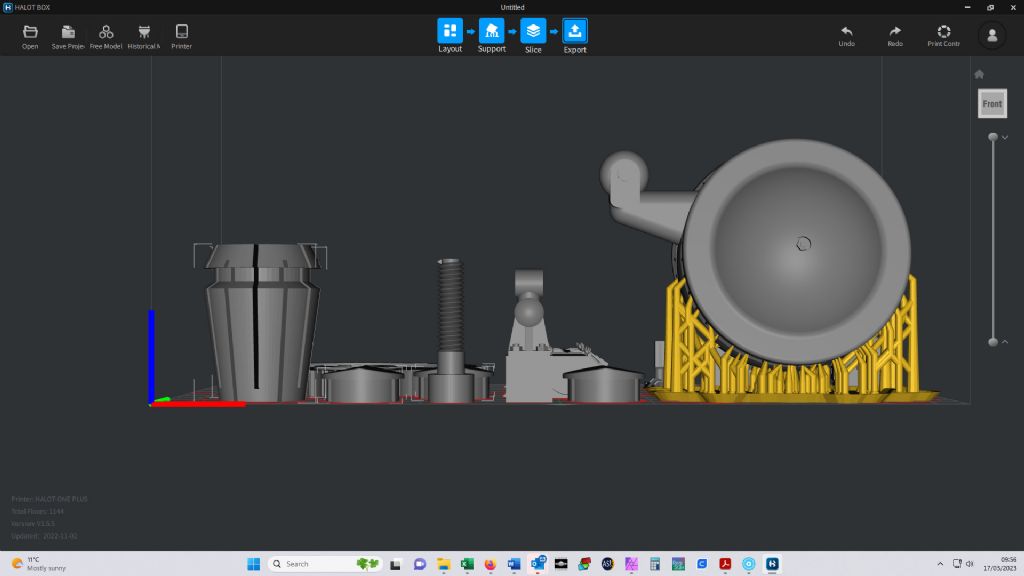

As with FFD printing, object files are designed in CAD and saved as STL files (STL also stands for stereolithography, although the files are used for both SLA and FFD). The STL files have to be processed ready for printing. In brief this means arranging the object(s) on the platform, adding support (so isolated areas are connected to the platform) and ‘slicing’ the object into layers.

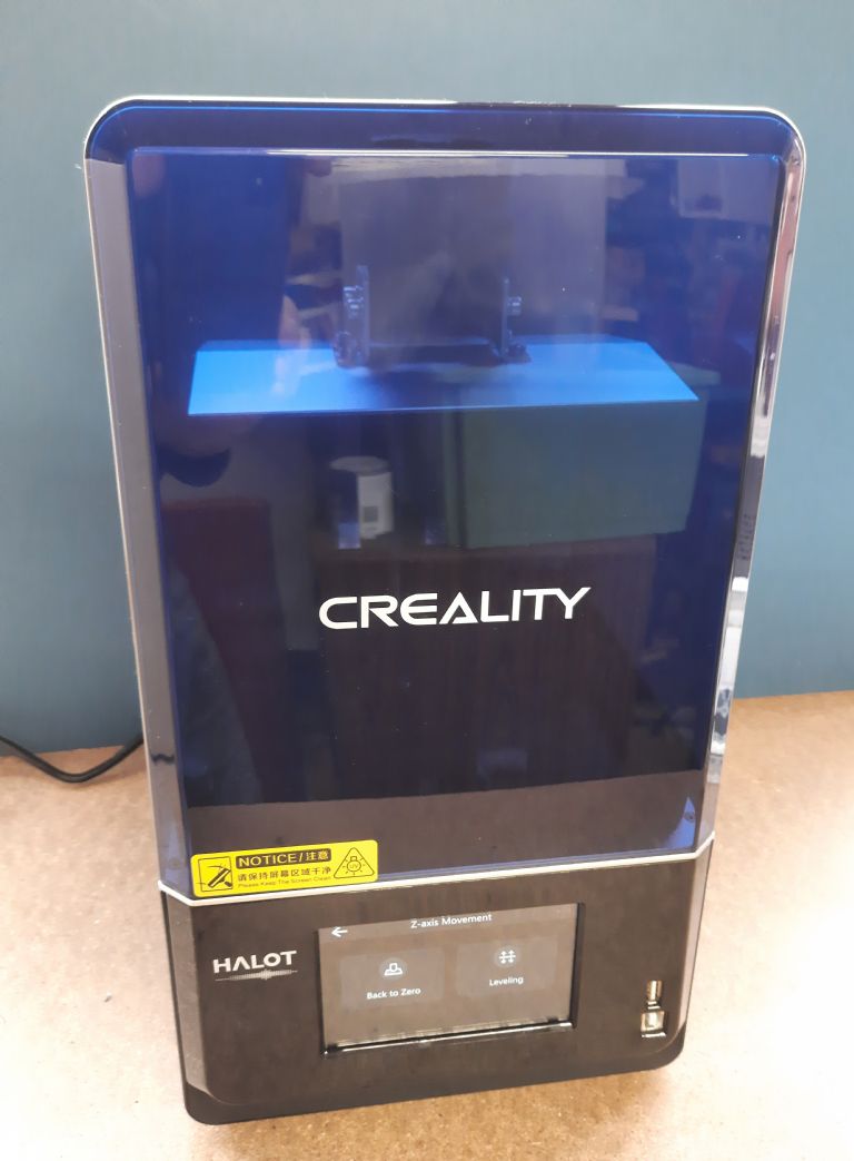

Unboxing the printer, I was impressed by the very high standard of packaging and the build quality of the machine. It is sturdy and well finished. Nothing was loose or sloppy. The instructions are mostly for levelling the build plate; for more detail you need to look at software on a supplied USB key, which includes a longer manual and a very useful introductory video. That said, the supplied information is rather like that supplied with a typical lathe. It tells you what the machine does, but just as a lathe manual doesn’t teach you all about turning, neither does the printer manual tell you all you need to know about 3D printing. I advise watching some online videos and visiting some tutorial websites before you try doing more than a basic test.
Remove all packaging, plug in and switch on the printer. The touch screen will come to life and try and connect to your wifi (this makes uploading prints much easier). You can skip this step and proceed to a very simple menu structure for printing or setting up the printer.
The next step is to level the print platform. This is vastly easier than with a typical FFD printer. Your raise the platform, unclamp and remove the vat and then loosen the platform. Place a ‘special’ levelling card on the screen and then the levelling button then brings the platform down onto the card. Retighten the four allen screws that secure the platform so that it secures the card. You now raise the platform again and replace the vat.

Preparing an Object
SLA can print much finer objects than FFD, the Halot One Plus has an X/Y precision of 0.04mm or 0.0016”, fixed by the resolution of the 4k LCD screen. The z-axis resolution can be selected from 0.01mm (less than half a thou) to 0.2mm. I decided to ignore the example objects supplied by Creality and print an object I designed some time ago that was too delicate to print well using my FFD printer. It is the first design I made in Alibre Atom, a small model of the 1945 Messerschmidt P1110/II jet fighter – a plane that never left the draughting office. I imported my STL file into ‘Halot Box’ software downloaded from Creality’s website (Windows and Mac versions are on the USB stick but I wanted the latest version). Halot Box proved very easy to use, being a visual system that will be familiar in style to anyone who uses Cura or similar software to prepare files for FFD printing. Having seen some advice, I set it at 45 degrees then used the default settings to add supports and slice the model. The default resolution is 0.05mm in the z-axis, roughly two thousandths of an inch. I saved my printing file onto the USB key.

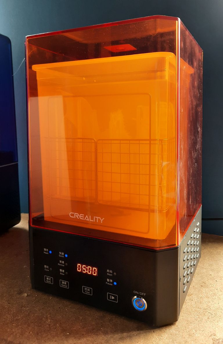

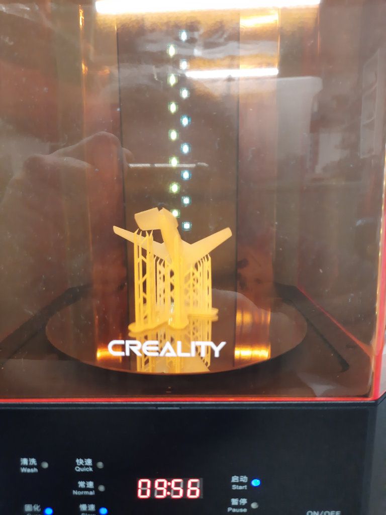

Creality had also supplied the UW-01 washing and curing machine, (about £110) <Buy UW-02 in Creality Store UK>. This looks like the printer’s little brother, except it has an orange hood. Again, a safety interlock requires the hood to be in place when the machine is operating. It has an external PSU, rather than a built in one, and has a control panel with touch buttons and a simple four-digit LED timer display. In washer mode a large polythene tank stands on the base, this has a magnetically driven impeller with a choice of three speeds. The tank is filled with isopropanol (500ml is enough for most models, but it will take a litre) and the model placed in a supplied basket (small models can be left attached to the platform). The hood is put in position and the machine run for two minutes for simple shapes or longer as required for bigger or complex objects. Once finished the model is drained and can be finally dried off with paper towels. The tank has a sturdy lid secured by four clips with an airtight seal so can be used to store the isopropanol. In time resin will build up in the bottom of the tank, the isopropanol can be decanted off for re-use and the resin left outdoors to set in the sun before safe disposal in household waste.
In curing mode, the tank is replaced by a circular mirrored platform on which the print is placed in front of the upright that houses two rows of UV LEDs (two different wavelengths). Once the hood is in place, the machine will rotate the object while bathing it in UV to complete the curing process.
It’s important to be aware that this is a bit of a luxury item – you can wash objects in a simple isopropanol bath and curing them simply by leaving them outdoors. Even under an overcast sky there is enough UV to cure a print in a reasonable time. That said, the UW-01 does make everything very clean and simple. I have discovered one invaluable accessory that I fortunately had to hand already - a very large pair of forceps. These are ideal for handling prints before the resin is washed off, or for picking them out of the tank without having to lift out the basket.

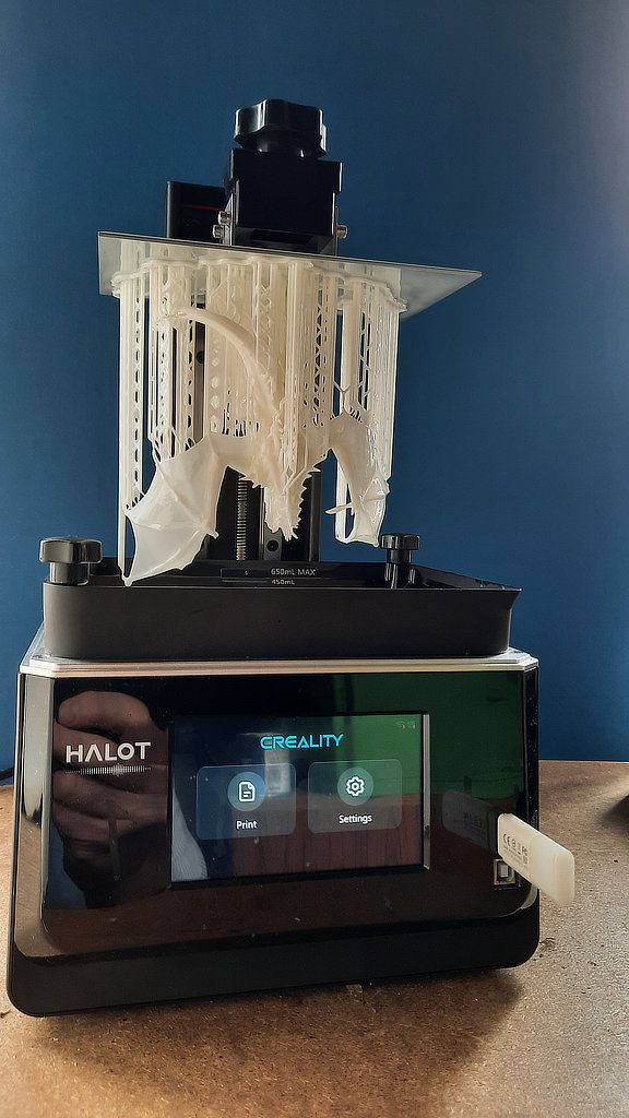

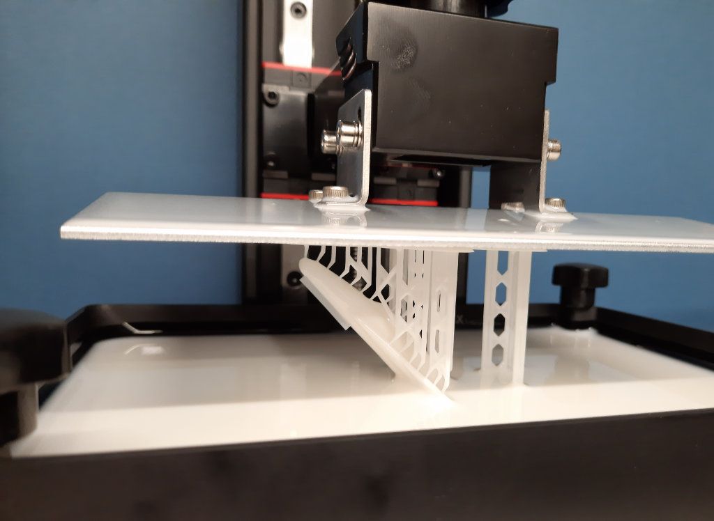

Removing the Support

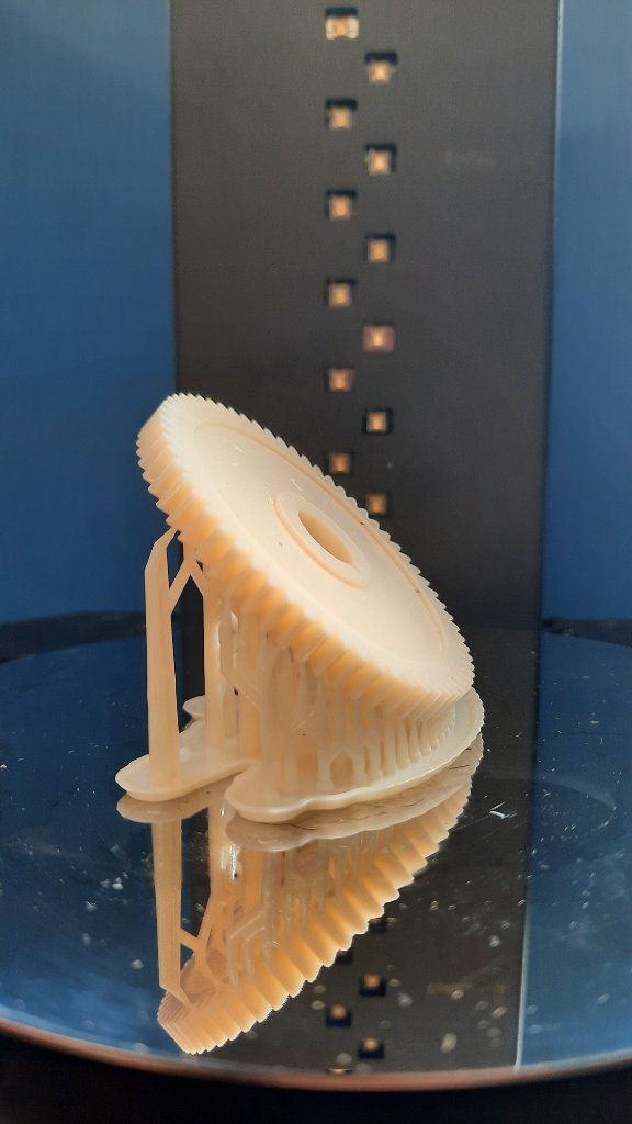

Once you have dried and cured the print can have any support removed (and you will discover that almost everything is best printed with support). Unlike with FFD support is usually in ‘tree’ form rather than a grid, also rather than stopping slightly away from the model to facilitate removal, it is fully bonded to the model. In practice the very small tip sizes used for support (typically 0.4 – 0.6mm) mean that the support is quite easy to remove, unless you choose to place it at a high density, or the object is rather complex. In these cases a sharp scalpel is the best approach. The ‘scars’ left by support are minimal – nothing like those left by FFD and easily sanded off or scraped flat with the edge of a blade.
A particular feature of the Halot One Plus is that it can print support structures down to a size of 0.1 – 0.3mm, Creality claim that even the tiniest and most delicate of prints can be supported without deformation.

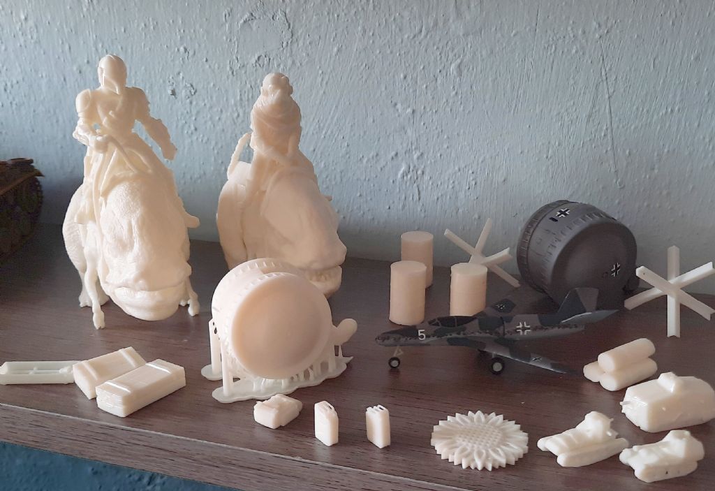

The Finished Print

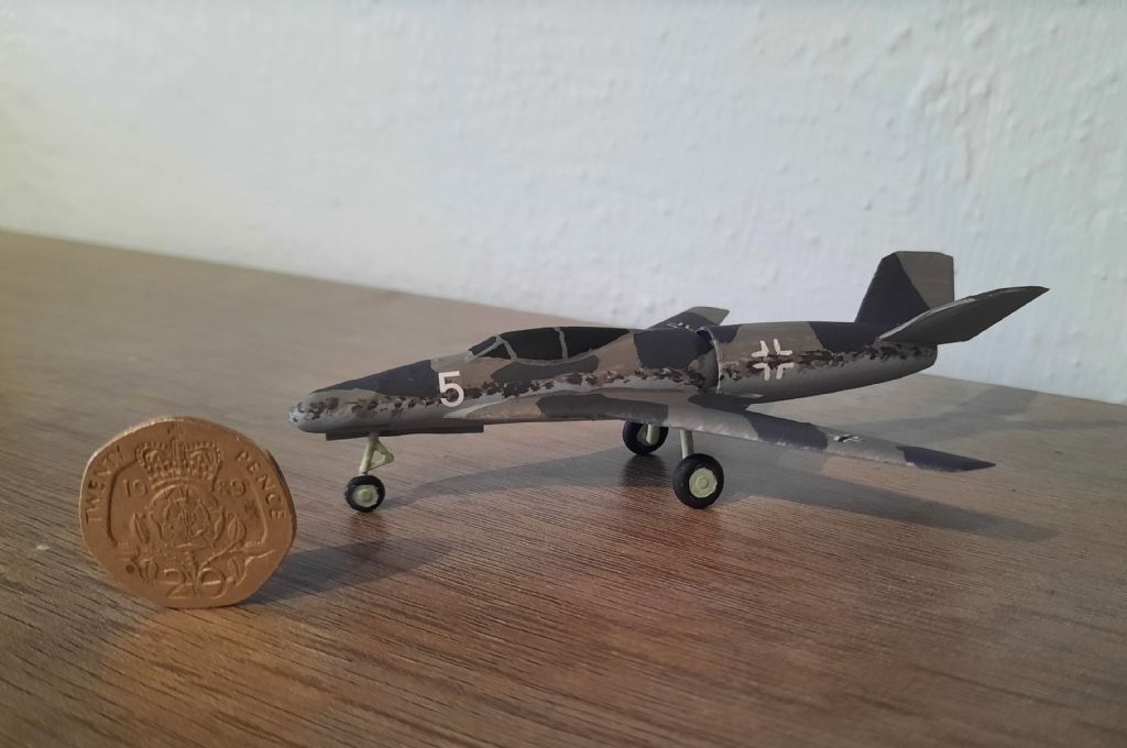

A good resin print will astound anyone used to 3D printing with a fused filament machine. The resin tends to smoothly transition between layers. The nominal 0.05mm/0.002” texture I have used by default leaves very faint striations, but the prints feel and look smooth. They are almost as crisp as injection moulded parts. Sometimes there are minor imperfections, I have had prints with a slight raised or sunken layer for no obvious reason, but even these marks are less obtrusive than the regular layer marks of an FFD print.
For my little model of the P1110/II, I was able to create undercarriage with legs about 1.5mm diameter and glue these in place with superglue - I now know I could have kept them integral with the print). The resin took acrylic paints beautifully.
Prints are dimensionally very accurate; Creality supply specialist resins for dentistry and one of their properties is very high dimensional stability. I tried printing an M6 cap head screw; an allen key neatly fitted and a standard M6 nut ran straight on to the thread. I am confident that smaller screws, such as M4 should be quite feasible.
I have already discovered some things that can go wrong. Large cross sections generate a lot of suction when pulled away from the base of the vat. They can break off, but fortunately the resulting lump in the vat can be easily released from the FEP using a built-in cleaning program that cures a layer of resin across the whole screen, this can be peeled away (wearing gloves) with any bits of failed model attached. If you have loose bits in the resin or just want to leave the machine empty, it can be filtered back into its bottle. Some mesh filter cones are supplied for this purpose and work very well. I have ordered a pack of these that should last me years. The emptied vat is cleaned with isopropanol.
Large objects are best printed hollow, to save on resin and weight and minimise the cross section of parts. Halot Box can do this with a simple function – just choose a thickness and click ‘hollow’, and it will do the job leaving a simple fill mesh of any desired density. Halot Box also has a ‘drill’ tool that you use to make air holes in the bottom of hollow object (which will be printed at the top) to stop them acting as ‘suction cups’. This approach is very effective at stopping parts from detaching.
Another issue is that flat areas, particularly underneath objects, tend to curl up unless supported all around the edges. One simple cure is to angle the part, this can also help reduce cross-sectional area. Other approaches are to increase the support density or just manually add extra supports (this is very easy) around the edge of the part. With circular parts, I found that the default support placement can miss the very lower edge, very noticeable when I tried printing a mini-lathe changewheel. Manually adding a support to the tip of each tooth solved this.
For working parts, the chief drawback with standard resins is that they are hard and inflexible and therefore quite brittle under load, particularly after they have fully cured (which can take weeks). When I printed some parts directly on the build platform, the larger ones broke when subjected to the force required for removal. Using a raft and support avoids this problem, as the raft is thin enough to have some flexibility and can easily be sheared off the platform with the removal tool.
This means that parts made with these resins are best used as decorative items (e.g. model parts) or to prove designs, not as working parts such as gears or levers. Tests by others have shown that FFD printed PLA outperforms a standard resin when used for gears. Incidentally, I chipped a claw off of a decorative dragon, I found that ordinary ‘super glue’ was able to attach a bit of support material as a replacement ‘claw’ which I then blended in using plastic putty. For a test I deliberately broke a delicate part and found that superglue gave an excellent repair.
