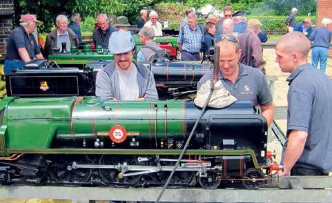

Steaming
1. Fire lighting
Some people use wood, some fire-lighters but the writer prefers charcoal soaked in paraffin or white spirit. On no account use methylated spirit - the flame is virtually invisible in good daylight and you will surely set fire to your charcoal tin with a burning shovel! Charcoal burns hottest, to give you a good fire quickly, and produces less eye-stinging smoke. Broken charcoal briquettes as used on barbecues can also be used to good effect in place of lump charcoal.
Check the position of the bottom row of tubes by looking through the firehole door and make a mental note of the level.
Feed the firebox a good layer of soaked charcoal to cover the grate about an inch deep. Fit the electric or other blower to the chimney and turn it on. Check the water level is okay, then set fire to a shovelful of soaked charcoal and feed it carefully into the firehole. You may need to partially obstruct the outlet of the blower with one hand to avoid the flames being extinguished by the strong draught. If the fire doesn’t take hold, try again, noting the last point and the fact that the lighting shovelful may need to be quite wet with paraffin. Allow the fire to spread around the charcoal for a few seconds before closing the firehole door.
Feed the fire with charcoal once it is well alight; it doesn’t matter if you feed dry charcoal once the fire is well established; this will minimise the white smoke and save you money. Close the firehole door after each addition. Continue stoking the fire steadily with charcoal until the top of the fire is just below the level of the bottom row of tubes, which you memorised earlier. Allow the fire to burn through, top up with a little more charcoal before starting to feed coal in small quantities. If you hear a lot of spitting and popping and are getting showers of sparks from the blower at this stage, the draught is probably excessive. It is better to reduce the draught and take a few minutes longer to raise steam than to stress the boiler by forcing it too hard. This is more important with larger sized boilers than say a ¾ inch scale, 3½ inch gauge Titch. Full size boilers have to be steamed very gently; as the firebox end could be very, very much hotter than the front tube plate area, causing immense stress to the boiler if forced. As the lighting charcoal burns away, continue adding coal to maintain the level of the fire. As soon as the boiler pressure reaches around 30 psi the electric or other blower can be removed and the locomotive’s own steam blower will take over. Be careful not to burn yourself as it will be very hot and careless handling could cause you to drop it on your engine. Leave an electric blower running for a while to reduce the amount of heat soaking into the unfortunate motor. Remember the steam blower operates via an adjustable valve which controls the draught; you will not need a strong blast to pull the fire up, increasing the pressure steadily. It is common practice to wave one hand over the chimney of a model to feel the draught intensity whilst adjusting the steam blower valve with the other. At this point you will probably become aware if the regulator isn’t closed as you may have difficulty in raising much pressure and unexpected steam may be issuing from the drain cocks, if fitted, or chimney. A quick adjustment of the regulator position is quite safe as long as the engine remains in mid gear.
As the pressure increases, maintain the level of the fire by adding coal, keeping an eye on the pressure as it approaches safety valve release pressure. Check that the safety valve opens at the correct pressure and releases any further steam produced and not allow working pressure to be exceeded. This quick DIY steam test is for the driver who wishes to continue his hobby without Divine Intervention! Note that larger engines are equipped with two safety valves, which should be set to lift sequentially; they should lift in order but the principle of pressure release remains unchanged.
Once satisfied with the safety valves, you will need to keep an eye on the water level, replenishing the boiler with the hand pump, steam pump or injectors as available on the engine. It is important to check your means of boiler feed at this stage before much water is lost. Of course the axle pump can only be checked whilst under way but these are reliable devices when compared with injectors in the smaller sizes.
It would be wise to blow down the gauge glasses, briefly, to clean them and check the water level resumes position quickly, indicating there is no blockage in the fittings, which could cause misleading water readings. There are single and three cock water gauges, the former, fitted to smaller locomotives need no explanation but the drill for the latter is as follows.
  • Close the two cocks in the passages communicating with the boiler and open the drain - the water should empty quickly.
  • Open and close the top cock with the drain still open - steam should blow through.
  • Then open and close the bottom cock with the drain open - a mixture of steam and water should blow through.
  • Finally close the drain and open the other two cocks and the water level should re-establish quickly.
The hand pump needs no further explanation but the injector is worth a word or two. Start the injector by turning the water supply on, then opening the steam valve. Assuming the injector picks up, the water flow can be reduced to just stop the overflow from dripping. Increasing the draught of the blower will help compensate for the steam used and the influx of pressure-reducing cool water. To stop the feed, turn off the steam and then the water. Be aware than an injector will not feed warm water so tank engines need a cold supply fed from the driving trolley. Injectors have a definite range of operation pressure and will not feed below and above a certain pressure.
Adjust the draught level to a gentle blow to maintain the fire and pressure without causing excessive waste by violently lifting the safety valves.
If you have a mechanical lubricator fitted with a hand wheel it is sensible to rotate it by hand about 20 turns, this will ensure the clack or non-return valve is primed with steam oil and less likely to cause a blow back into the oil tank.
Transport the locomotive to the running line and couple securely to a braked driving trolley and you are ready to climb aboard and start driving.

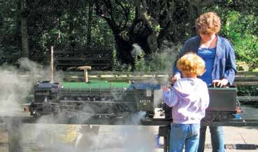

Starting out
Open the drain cocks (if fitted) and ease/wind the reverser into full reverse gear (if traffic conditions permit reversing), leaving the blower open for the time being. Release the brake and gently ease the regulator open and travel a few yards in reverse to clear the condensate from the cylinders. Close the throttle smartly if she slips, before opening again carefully. Starting in reverse reduces the chance of you receiving a hot oily shower and is particularly useful on smaller locomotives if drain cocks aren’t present. Change to full forward gear and start forwards, closing the drain cocks after say thirty feet. The blower may also be closed as the exhaust blast should now maintain the fire but with a light load a little blower may be required to maintain pressure. Only experience will tell. Be aware that you may have set off with a quantity of charcoal left under the coal fire – this will burn away suddenly under strong exhaust blast, leaving you short of fire. Once the locomotive is up to speed, the valve gear can be ‘notched up’ to reduce the distance the pistons have travelled down the stroke, before steam admission is stopped, economising on steam. Compensate for the reduced power by opening the regulator more. It is full size practice to drive with regulator wide and control speed by varying the cut-off once under way on the main line. This is usually impractical on our tracks but ‘notching up’ is still good practice and a source of driver satisfaction. It is wise to take it steady with your speed, as excessive regulator opening and the consequent blast will hasten the build up of ash/cinders in the tubes and smokebox cutting short your run.
Be aware the chimney should not be dry and should have traces of black steam oil – this will confirm the lubricator is working.
Keep an eye on the fire and water level, firing should be little and often to reduce the effect of black coals in the furnace. If you have an axle pump, check the position of the bypass valve. Closed gives maximum boiler feed and fully open gives none at all with an infinite variation between. Many locomotives are arranged so the end of the return pipe is visible under the edge of the tank or tender filler, so the action of the bypass can be checked visually. Aim to adjust the feed level to maintain a steady level in the glass. If your engine has a steam pump it’s merely a matter of opening the control valve and regulating to a suitable speed once the condensate has cleared. The operation of an injector has already been described. The writer finds the injector very useful whilst stationary on the smaller locomotives. However, although more challenging, it is quite possible on a 3½ inch gauge, whilst under way. It can be a source of driver satisfaction if you manage it on the move but this is routine with larger scales.
You can then carry on, subject to signals, coal, water and oil supplies. When coming to a stand you will need a touch of blower to maintain the fire. Open the drain cocks, place the engine in mid gear and apply the brake before dismounting. You will find that small locomotives can reel off laps without stopping, other than to replenish coal and water, if they are well driven and in satisfactory condition.
With the locomotive in continued operation you will need to oil round periodically and to check the level in the cylinder lubricators. Don’t go wild with the oil on the motion for it may find its way on to the rails. As mentioned above, the chimney top should show traces of steam oil if the lubricator is working correctly; should you end up covered in oil, take steps to reduce the feed. You will need to rake the fire periodically to break up any clinker that forms and to clear the ash pan to maintain airflow. Don’t go mad with the rake as anthracite is prone to shattering, choking the fire with small particles. With extended, hard operation such as found on a society public running day, it may prove necessary to take the locomotive out of service for a short while the smokebox is cleared of cinders and the bottom row of tubes are swept. Be careful where the abrasive ash goes – a piece of card can be used under the smokebox door to collect the cinders and protect the ‘works’ and paint. Do not use a bristle fluebrush to sweep the tubes while there is still a fire in the boiler - you will soon have a wire thing and a bad smell. Don’t ask how I know!
