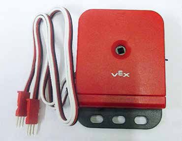

Photo 1:The encoder.
This project started out when I decided to build a clock. My 5 inch centre height lathe simply would not grip the 1⁄8 inch bar from which I was making spindles. I suppose I could have bought a smaller chuck but the whole thing seemed out of scale. I then saw an advert for a Cowells lathe at the right price. It actually turned out to be a Perris, so very old, but still in very good condition so home it came. Once I had replaced the sewing machine motor with a Parvalux it did the job fine but the leadscrew and cross slide dials were fixed and didn’t even have numbers stamped on them. Even if they had, the subdivisions are 0.025mm, which isn’t the handiest for mental arithmetic.

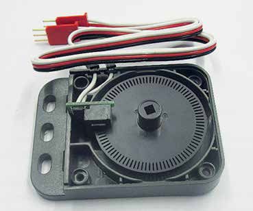

I really couldn’t justify fitting a commercial DRO system but I managed to buy the cross slide screw assembly taken from a Pultra (I think), at a very reasonable price in the club auction and grafted it onto the Perris. I resigned myself to having to make a new dial for the feedscrew when Paul found some rotary encoders on the Internet (ref 1 and photo 1). At less than £10 each I bought two to have a play.

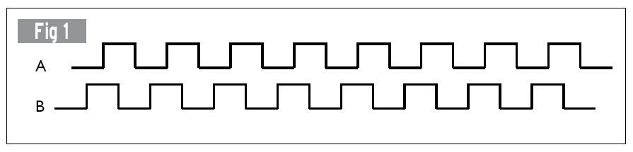

Taking the lid off the encoder reveals a disc with 90 slots and a sensor incorporating two optical switches (photo 2). These are arranged so that each sensor produces a square wave output and the sensors are displaced by ¼ of the distance between the slot centres so that the two outputs are displaced as shown in fig 1.
Each change of state (High to Low or Low to High) is called an ‘edge’, so it will be seen that each slot produces four edges. This is exactly the same as a linear encoder but bent into a circle. As long as you maintain the slot width and pitch, you could make our own disc with as many slots as you like (I haven’t actually tried this). The electronics then sorts out which way the disc is turning and at each pulse adds or subtracts ‘one’ from the current position count. Having previously told the electronics how many pulses represent 1mm (or 1 inch), the count is translated into position and displayed on the Liquid Crystal Diode (LCD).

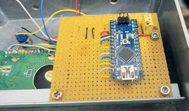

I would have set to and built a bespoke circuit board with a PIC but Paul introduced the idea of using an Arduino nano. This is a ready made board incorporating the controller and various other necessary bits of magic (these can be found for around £10 Ebay). Using this massively reduces the soldering and doesn’t actually cost a lot more than buying the components. Output is displayed on a Liquid Crystal Diode, type HD44780 (around £2 on Ebay for the large digit version but they can be hard to find; the small digit ones are even cheaper if you buy from Hong Kong). All you need then is a push button for the reset to zero and we also incorporated a toggle switch for metric/imperial select.
Power supply is from a 5V mobile phone charger and the die cast box came out of the scrap box (never throw anything away!). The internals and externals are shown in photos 5, 6 and 7).
