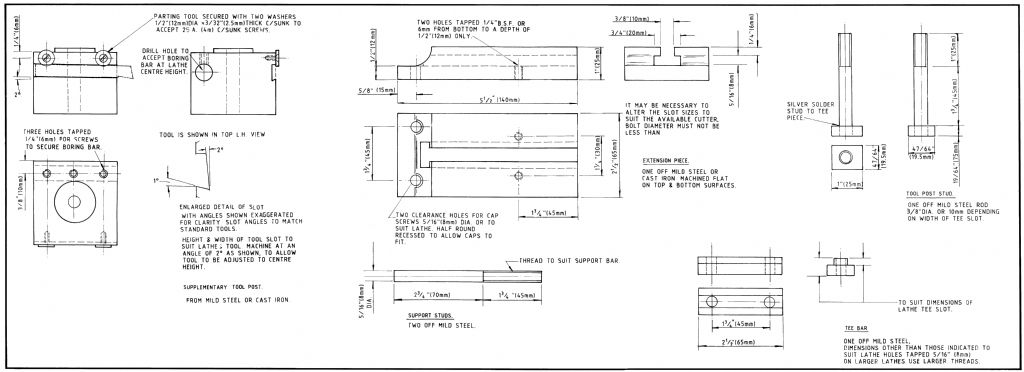

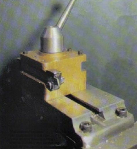

The rear tool holder, for multiple operations or rear parting off is not credited on the plan. I believe it was designed by Stan Bray who was the original editor of the magazine. It appeared in the autumn 1990 issue of MEW.
The full size plan is contained in these two jpeg files and accompanying pdf versions:
Swing Clear Toolpost Plan side 1
Alternatively, the plan can be downloaded as a series of overlapping printable Pdf pages which can be used to assemble a paper version:
