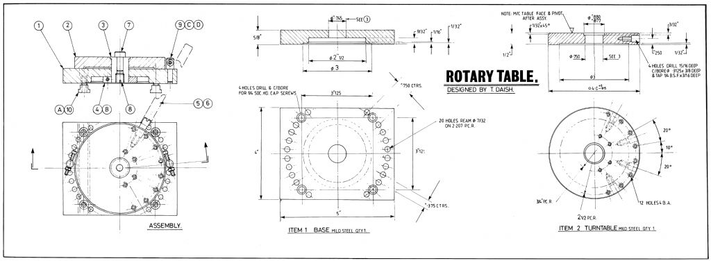

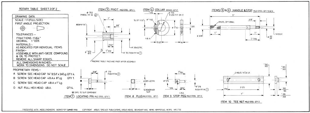

This simple but effective low-profile rotary table, designed by T. Daish, appeared in the summer 1990 issue of MEW.
The full size plan is contained in these two jpeg files and accompanying pdf versions:
