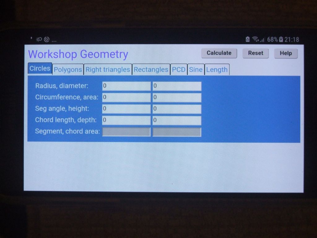

Geometry App
The Geometry app performs a collection of geometrical calculations often encountered in a workshop. The calculations and their required fields are described in the help text and are summarised below. Each type of calculation has its own tab:
  • Circles – basic properties as well as chords and segments. For example, finding the depth of cut when machining a flat of a particular width on a round bar
  • Regular Polygons with at least 3 sides. This relates side length, inscribed and superscribed circles, internal angles, overall height and area. Circular, square and hexagonal stock materials are often encountered and their relationships are important
  • Right-angled Triangles relates side lengths, angles and area
  • Rectangles relates side lengths, diagonals and area
  • PCD calculates the angles, distance across centres and distance across holes for a Pitch Circle Diameter situation. It can also calculate the list of coordinates based on the centre or one corner
  • Sine Bar is a simple version of the right-triangle tab and relates the bar length, the height above the datum and the elevation angle
  • mm-inch conversion includes fractional inches
The circles tab is shown in photo 1.
By default, all results are calculated to 3 decimals. This can only be changed by altering the code – look for the line “var dps = 3;” in geometry.js (see notes on source code below).

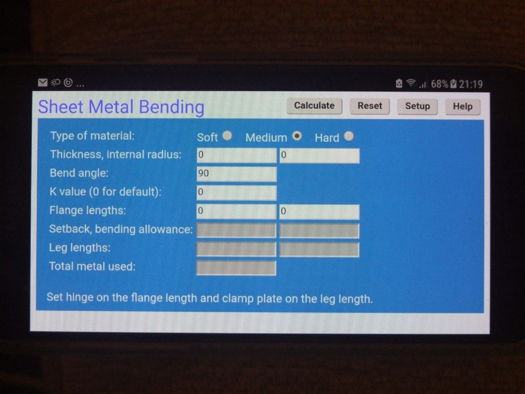

MetalBender App
The Metal Bending app calculates the position of the clamp plate and hinge for using a bending brake that might be found in the home workshop. This is not suitable for industrial bending machines.
The calculation requires a “K factor” that depends on the metal being used. However, this factor isn’t well defined and, in industry, can vary from one workshop to another. The app uses a table of commonly used defaults, but these can be updated by the user. The help page explains the calculation in more detail.
The main screen is shown in photo 2.
By default, all results are calculated to 1 decimal place. This can be changed through the user interface (on the settings page).
The app stores the number of decimals and the table of K values in local storage and should not need any special permissions. Data is stored in JSON format.
