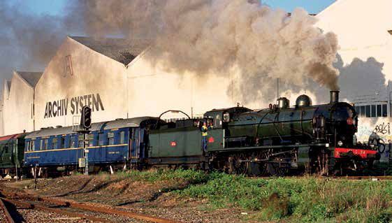

Recently put back onto its wheels after being jacked up for inspection and repair, 140C314 is a 2-8-0 tender locomotive built in 1917 by North British Locomotive Co. Ltd., Glasgow, works No. 21651, for the Chemin de Fer de l’État (photo 1). She is one of a longlived and successful class, the origins of which date back to the final years of the Compagnie des chemins de fer de l’Ouest (West Railway Company) as a separate company before it was taken over (‘le rachat’ or buyback) by the Chemins de fer de l’État (State Railways) on 11 November 1908.
Photo 1

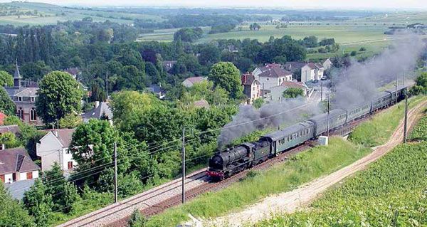

The CFTV’s example (photos 2 and 3) started her career as État No. 140-314, being landed at Saint-Nazaire and allocated first to Saint-Brieuc depot. Following formation of the SNCF she became 140C314 but remained in the Ouest Region (as shown by a figure 3 in a white box on the front buffer beam, just visible in photo 1).
As stated above, the locomotive is a two cylinder simple, with piston valves operated by Walschaearts valve gear and a bypass arrangement to permit freerunning when drifting. Plate frames were used although a number of cut-outs were used to reduce weight. The connecting rods and valve gear are of robust construction and the balance weights on the third axle are notably large as they seem to take up half the area of those main driving wheels. The locomotive is fitted with axle box wedges and compensated springing.

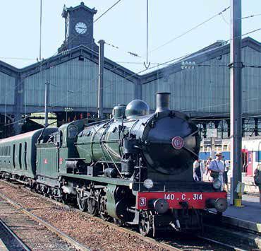

Photo 4: A run to celebrate 150 years of Reims Station.
The 140C locomotives were paired with a variety of tenders. That which has been normally coupled to 140C314 is 18C428 constructed by Marine- Homécourt in 1913. This double bogie tender weighs 21.6 tonnes empty and has a capacity of 9 tonnes of coal and 18 cubic metres (about 4000 gallons) of water.
During the Second World War 140C314 was requisitioned by the Germans, being returned to France in 1950. Following repairs which included a new ‘Nord’ type smokebox door and Coale safety valves, the locomotive worked until the 1970s. The locomotive was acquired by the CFTV in 1994 and, in addition to service on the CFTV, has also made occasional forays onto the SNCF main lines on special trains and for filming purposes (photos 4 and 5).
