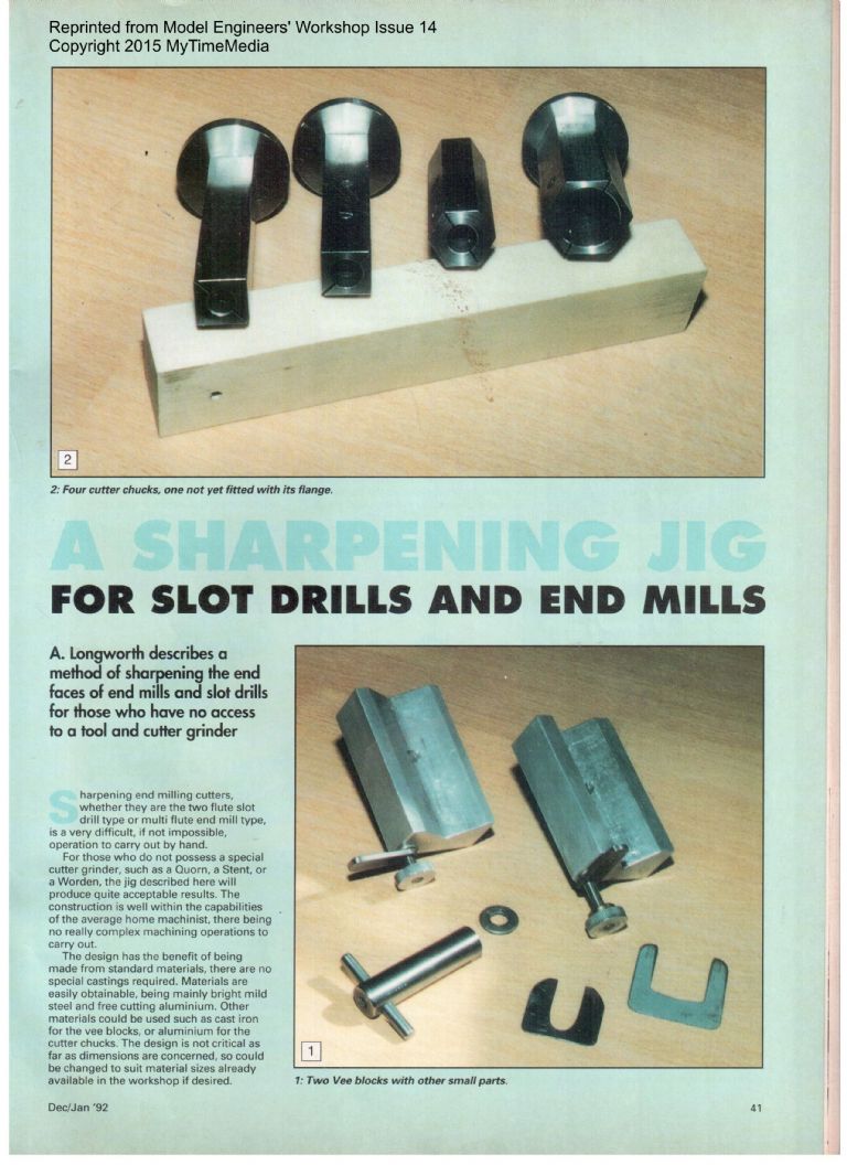

This handy accessory by A Longworth was first published in MEW 14, December/January 1995. The particularly clever aspect is a simple setting device.
Because the use of the device is not entirely obvious from the drawings, in a departure from the normal approach, you can download the four pages of photographs and description. Right click and chose 'view image' to see a larger version:
