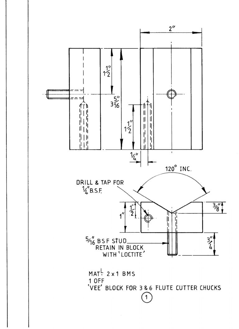

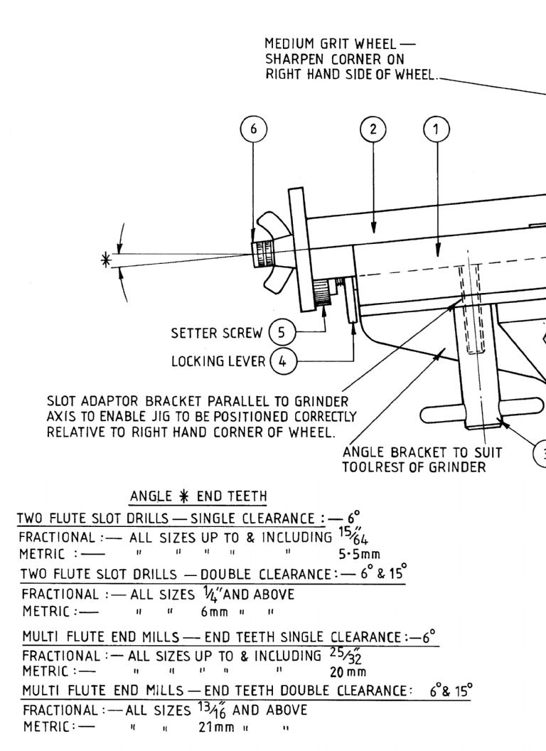

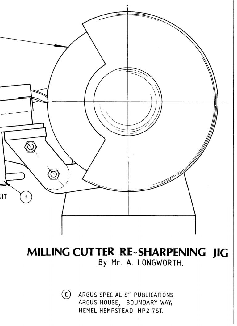

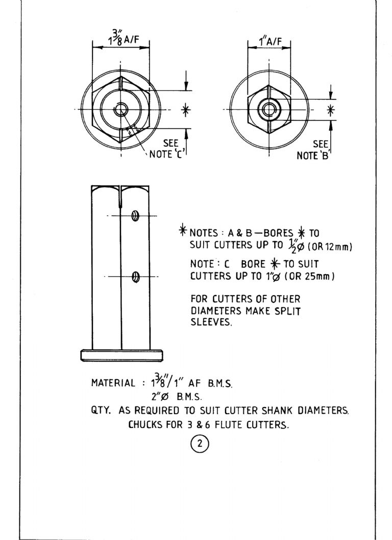

A. Longworth describes a method of sharpening the end faces of end mills and slot drill for those who have no access to a tool and cutter grinder. Reprinted from Model Engineers' Workshop number 14.
