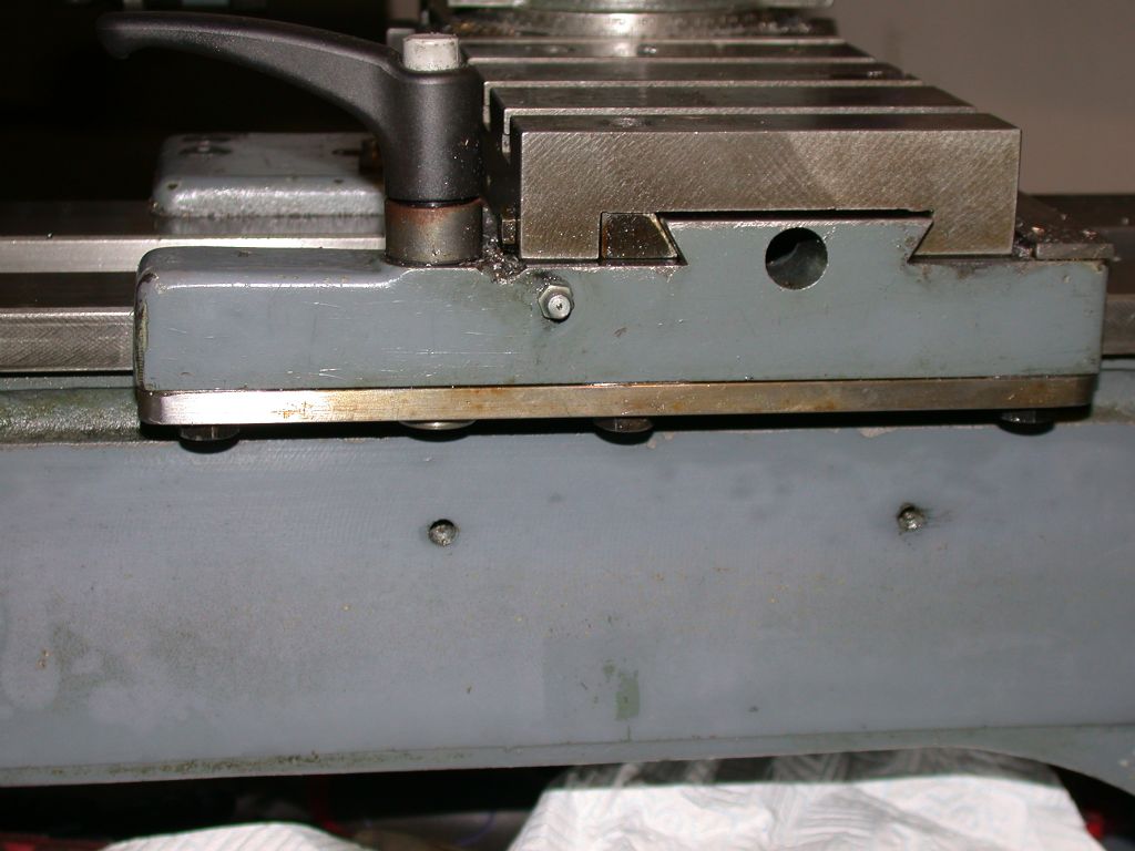

Hi just joined a looking for a little advice not long aquired a Myford Super 7 and today I was looking at the lub points and on the diagram I have it show a lub point (12) as front shear point and (13) as rear shear point but I dont have No13 on my lathe on the rear of the saddle I have the bolt to clamp the saddle and one other hole which appears to be tapped 7/32 BSF (I think) and does't look if the nipple should fir there anyway.

Look around the rear of the saddle, with the cross slide wound towards you (if you are standing at the front of the lathe) until it gives a clear view of the vertical face of the saddle. There should be a nipple about four inches to the left from the rear shear right hand edge. If thats where you have a threaded hole, it should be 2BA. Nipples are available from Myford.
Robbo07/06/2013 10:31:56
1504 forum posts
142 photos
To back up previous post, here is a pic of the rear of the saddle showing the nipple.
Happen to have a S7 in part dismantled state on movable cabinet, so easy to take pic.s7 rear saddle.jpg

Hi and thanks for reply must admit I've been looking on the top of the saddle will look tomorrow for the one in your pic thanks for posting

Harry, that other tapped hole on the top rear of the saddle is "spare". It's where they fix the coolant supply base when fitted at the factory. You can use it for what you like! Mine just contains a grub screw to prevent it getting full of gunge.

Hi Guy's many thanks for your replies have checked out the rear of the saddle as Robbo suggested there is a taped hole there but the grease nipple is missing, the hole is 2BA and quite deep about 1" into the saddle. the hole on top of the saddle could well be 1/4 BSFit is as suggested full of gunge !

Harry Please note it's an OIL nipple not a grease one
Roy
Robbo08/06/2013 20:57:59
1504 forum posts
142 photos
Can only emphasise Roy's post, it's an oil nipple, don't put grease in it, it won't get where it's needed and will bung up the oilways, needing a dismantle to clean it out.
About 1" into the saddle is right for the oil hole, at it's end it meets up with another hole drilled from the underside of the saddle, at rt angles to the first one. This 2nd hole is in the middle of a channel milled into the underside of the saddle, diagonally across the width, so the oil is spread over the full surface between the saddle and the bed.

Think we've beaten this one to death, but as I had the saddle off the S7 today thought I may as well include a shot to show the oil distribution.
Memory a bit faulty as to the location of the hole into the oil channel, but 'nowt new there.

Thanks for the pic shows the oild distribution well smiley
