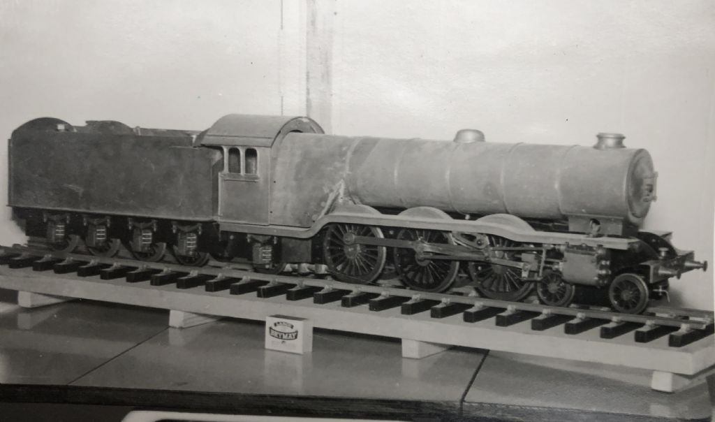

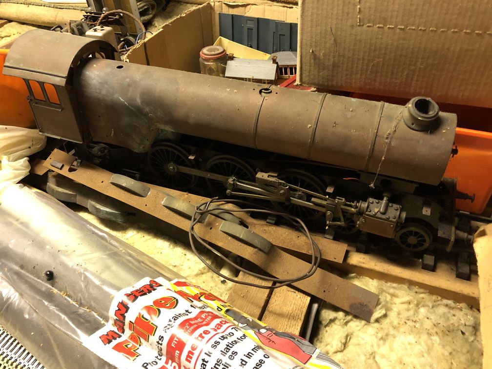

Possibly not the right forum, for reasons which will become apparent...but I'll give it a go anyway. I have inherited (most of) a B-L A1, construction of which was started by my grandfather, ignored by my father and now puzzled over by me. I say most of, because although I have the drawings, I haven't done a full itinerary but suspect there may be components missing. She is a methylated spirits burner, and the combination of that and the fact that I don't have all the skills required to complete the build have led me to the conclusion that finding somebody who might be interested in taking on a restoration project to get her to a presentable static standard would be a nice thing to do.
To that end...does anybody have any recommendations or desire for taking on a project like this? I'm not thinking about the cost yet - just establishing if it's feasible. I have read a fair amount of bad press about this particular kit but from a sentimental / non-running point of view, that's irrelevant.
A couple of photos...one taken recently, looking a bit worse for wear, the other in happier times (probably 50+ years ago):

ah.. a Gresley A1, the most beautiful of all steam locomotives...If I wasn't flat out building my 5" version I'd offer some help, I can certainly answer any questions you may have about the A1's if you desire to have her look more prototypical.
You could contact the 2 1/2 gauge association,s John Baguley who has worked on this model, in fact, he did do a blog on its progress some years ago which may help you. I'm not sure if he finished it? perhaps I should ask him, he's currently drawing up my ashpan for me in CAD.
I'm not sure of your experience in building things but you may find that you could restore this yourself, especially if only doing so to be a static model. Any questions I'm sure could be answered by fellow model engineers.
Here's a link to John FS page.. http://www.modeng.johnbaguley.info/locos/25inch/A1/A1-1.htm

I know John has worked on the Weise/Collin's Flying Scotsman design Peter (rather than the B/L version).
This engine is a meths-fired model (built to 1/2" scale - whereas the Collins design is coal-fired to 17/32" scale ). I have a part-built A3 based on the Collins design which was originally published in ME.
TEE Publishing used to do a little booklet on building/assembling this B/L engine - which was a reprint of the original directions.
Tony - If this loco was mine, I'd have the boiler tested and (if it can pass) then I'd restore it to full running order. This engine was designed for garden (scenic) running and we still see examples at Gauge '3' GTGs - so there are G3 Members around with running versions of this B/L engine.
In normal times, I'd invite you to one of our G3S Boiler Testing days and we could have a look at her for you - and hopefully things will improve as we get into the Summer.

This looks to be a good project, there are a surprising number of these B-L engines that turn up part finished or needing restoration, in fact there are lots of 2 1/2" gauge part finished's around, presumably started in the earlier years of the hobby, and abandoned when the larger gauges became more popular.
I'm rebuilding a part finished 2 1/2" gauge loco at present, and posted on here under " another president causing problems" , I can't help with the rebuild I'm afraid, but I have done some work on one of these in the past for a friend, so quite happy to give any advice i can if you PM me. Best recommendation I can give is to join the 2 1/2" gauge association, theres a wealth of knowledge and they are a friendly helpful bunch.
I think part of the criticism of the design comes about because they were not designed as passenger haulers, and were derided by model loco designer LBSC because of this,at the time he was building coal fired more powerful engines, but these make up into very good looking models with the right look.
The engine looks fairly complete and appears well built, if you do restore it yourself, take copious notes and photographs as you dismantle it, I put everything in such as screws and tiny parts in small envelopes and label them. Working on small sections at a time, say front bogie, or cylinders as assemblies helps to keep the work orderly. I have seen loco's where everything has been dismantled and chucked in a box, by the well intentioned restorer, tragically it found its way to the dustbin next. Good luck with it, it is a very worthwhile project.

Tony - Just to re-state that your engine was basically not designed for passenger/driver hauling - which is essentially the difference between the N2.5GA (who driver haul) and the Gauge '3' Society (who don't).
I am a member of both the N2.5GA and the G3S but would suggest that your engine is essentially a vintage Gauge '3' locomotive and is best considered as such. The G3S have their own Boiler Inspectors (I am one) who would be very happy to test your G3 engine's boiler without any pre-conditions or charge. We are very keen to keep these vintage models in running condition (and use) whenever possible.
The Gauge '3' Society normally holds Get Togethers (GTGs) throughout the warmer months and I'm very sure that there will be members at some of those events who both own and operate Basset-Lowke (meths-fired) FS engines who would be delighted to meet you and offer advice. Hopefully, GTGs will restart before too long...
Without wanting to cause any furore, you might also find that the BI's in some MES will be reluctant to test your boiler without at least your joining their Society and perhaps showing a degree of 'active' membership. This is understandable given that their services can be abused by people looking to 'trade' an old engine on eBay (preferably with a boiler certificate) and who have no intention of actually participating in the Society activities.
However, I do think that your decision on how best to 'restore' your engine should be (at least partially) guided by the condition of the boiler - so I'd suggest that this should be your priority.
