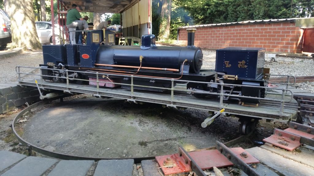

At the beginning of July this year I purchased a 3.5" gauge Garratt, based on the Darjeeling and Himalayan one of 1910. The loco has been designed and built by a fellow club member Jack Evans and is two 0-4-0 bogies based on Simplex with a mighty boiler slung between them.
The loco is fitted with two commercial oscillating lubricators, one at each end, the front one refused to work, but it was impossible to see if it was even going round given the length of the machine.

Here she is on the turntable at Derby SMEE, Morley.  A big engine for a 3.5" gauge, over five feet long.

Hopper31/08/2018 12:19:22
avatar
7881 forum posts
397 photos
What a beauty she is too! Thanks for posting the pic. I used to watch the full-sized later model Garratts shunting in and out of the yard at the powerstation I worked on in Zimbabwe circa 1980. Beautiful machines to see in motion, as I am sure yours is too.
