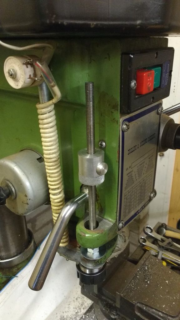

Does anyone have any neat ideas for a quickly adjustable drilling depth stop on a round column RF-20/25 mill please?
The 2 lock nuts on the 1/2" x 20 TPI threaded scale take an age to adjust and aren't thick enough to make into tilt-nuts. I suppose I could make two new thicker knurled tilt-nuts but if anyone has any better ideas they'd be very much appreciated please.
There is very limited space behind the threaded scale because of the quill-lock handle otherwise I had wondered about a sprung push-button lock engaging from the back onto the thread.
Many thanks in advance

On my square column Lux style mill I replaced the screw adjustment system completely with a simple D section rod having plain collar sliding up and down it. A wing headed screw locked the collar onto the column once set. The machine already had a simple ruler scale with 1/8" and 1 mm graduations printed on the front face of the head.
Theoretically less accurate than the screw system but the implementation on my mill was so bad that any accuracy gain from the screw was swamped by general flippity-flopping about. If I really needed accuracy I used to measure the actual travel and lock the collar hard up aganst the stop. Good excuse to get one of the cheap vertical digital scales.
I have seen devices where the collar is in two parts with a screw device for fine adjustment. The collar has a number of preset positions on the rod, a dimple for the screw tip would probably work here, and the calibrated screw device covers the intervals. Perhaps 1/4" to 3/8" or 5 to 10 mm on the screwed part. Overcomplication for little benifit here in my view but it can work well.

Just remembered that I had a picture of the modified depth stop on my old square column mill.
Obviously the head layout is very different to yours but it should be possible to do something similar by adding a plate with suitable slot to the front of yours. Laser print and laminate makes a good ruler scale for this sort of thing. Collar was actually a Tee nut shape running nicely in the slot. Part of the original system with an internal thread so it could be driven up and down the threaded rod by a knob at the bottom. I just drilled it out for the new rod. Going by picture it looks as if I may have just used a plain round rod with copper slug under the lock screw rather than a proper D section rod. From memory my front plate was around 2 or 3 mm thick. Made a good solid stop.

Perhaps you want something like this. Could use the existing threaded rod.
This one's for a Bridgeport but the principle is fairly obvious - spring loaded half nut. The BP has a sensitive feed trip arrangement requiring little force to trip so you'd need to either fit a beefier spring or lock it with a threaded element such as a wing nut for a machine like yours that requires a solid stop.
Clive's suggestion is similar - but without any teeth to grip, the (split?) clamp needs to be pretty strong. Depends how much force you think it needs to withstand.
PS - seems I was telling porcupines. In fact this Grizzly accessory seems to be for a Sieg(?) 6"x21"  mill, so perhaps more beefy than I gave it credit for.

Hi All,
Thanks very much for the ideas and suggestions.
I decided to follow Muzzer's recommendation in the end combined with a new M8 threaded rod. The old 1/2" one didn't leave enough space behind for the thread disengagement and spring and M8 is plenty rigid enough for a depth stop IMHO.
I haven't done anything about a scale yet but a cut-up cheap 6" steel rule glued to the front of the mill and a pointer joined to the threaded rod should be a lot more accurate than the original riveted to the threaded rod.
