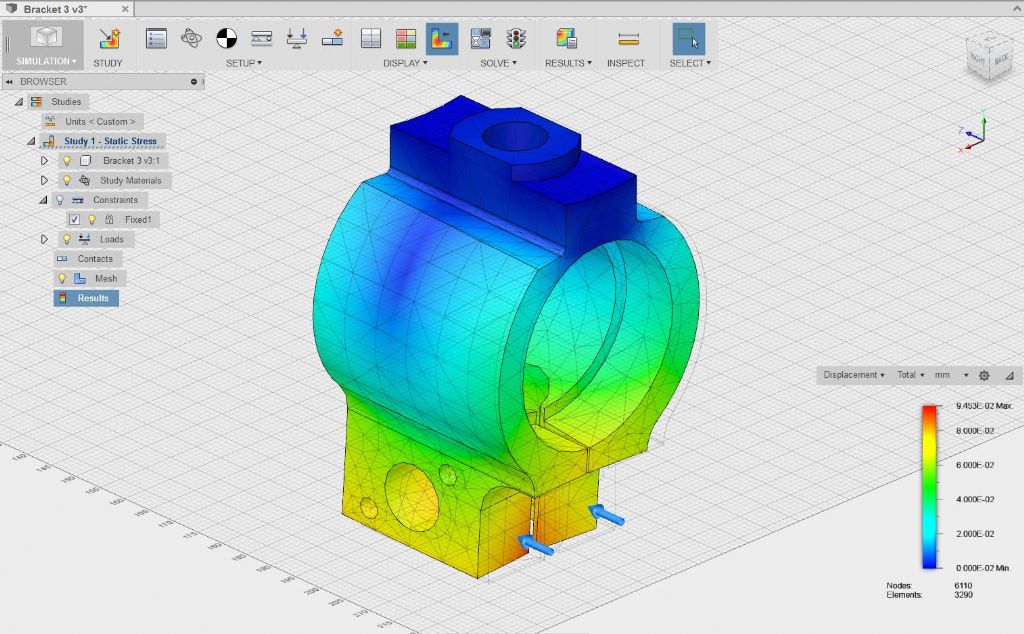

Without wishing to sound like a Fusion 360 evangelist, FEA comes free with (free) Fusion 360. In this case it's recognisably the same FEA that is part of Inventor.
Solidworks and Solid Edge also include a similar FEA but obviously they aren't free.
In each case you can go for static or nodal (resonances etc). You place the constraints (fixed features) and the applied forces, then run the analysis and then display the resulting stress, strain or displacement.
Here's one I did before Xmas on a bracket. I didn't finish the exercise but as a first look it gave me an idea of how it would face up to worst case loading.
Murray
Bracket FEA in F360
