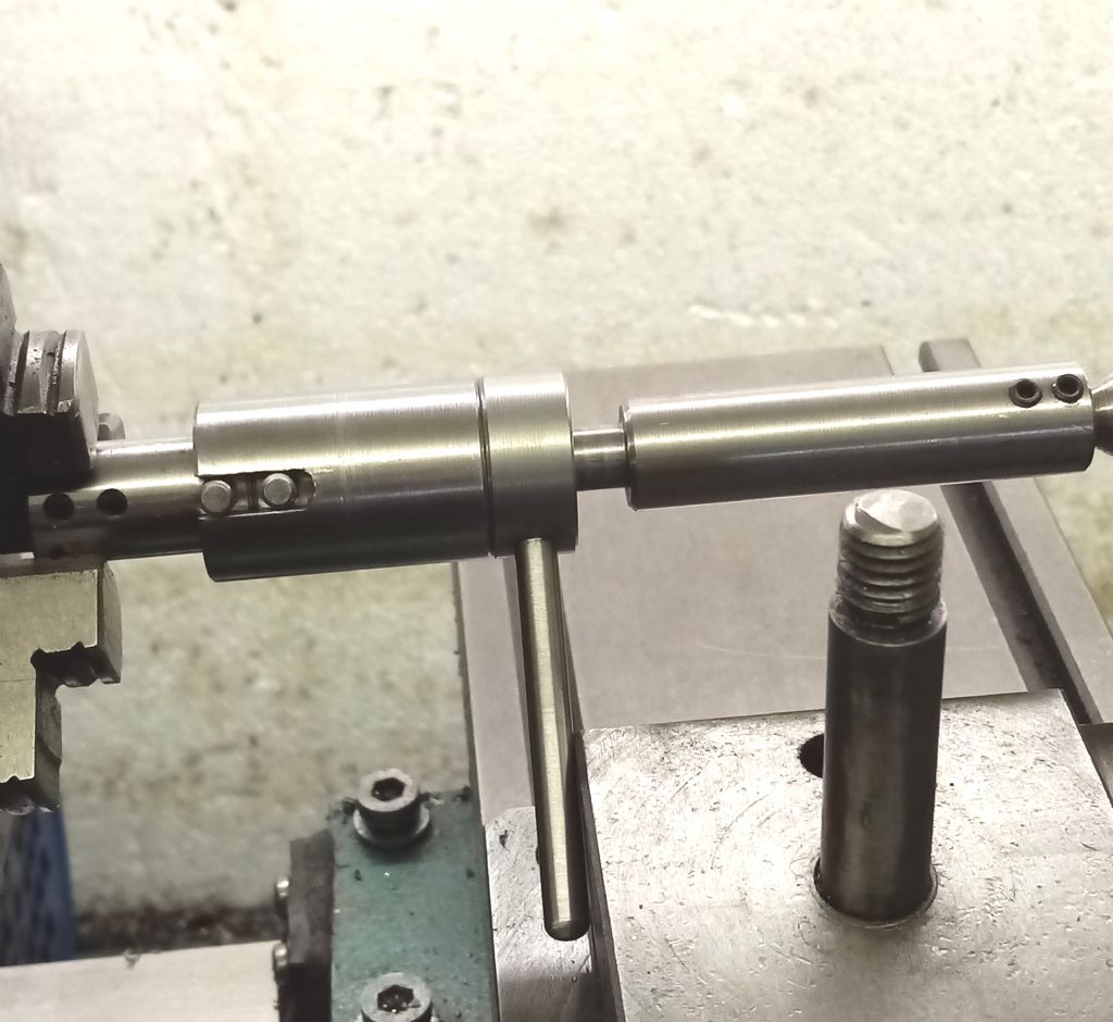

A couple of pictures of my take on a dog clutch for the cross slide feed, the slotted traveller is spring loaded with an internal compression spring keeping it pushed back and disengaged against the lever boss. To engage the clutch the lever boss is slid forward pushing the traveller to engage both pins for drive. I will have a stepped or angled slot on the motor mount for the lever to engage in maintaining the connection of the two pins.
I used the end of the top slide to keep the sprung traveller engaged, the lever will be held in a slot on the actual fitting to the lathe.

Forgot to add the pic of the parts that make up the clutch.

Mk11 version, a much higher torque motor/box and a modified dog clutch. The previous clutch with the internal spring and hand lever worked but it was awkward to use. So I have removed the spring and lever and drilled a pair of holes for a spring loaded 4mm ball bearing which locates the traveller in the engaged/disengaged positions. Just waiting for some 4mm balls to arrive, I had 2 but lost both to the workshop gremlins in no time at all.
