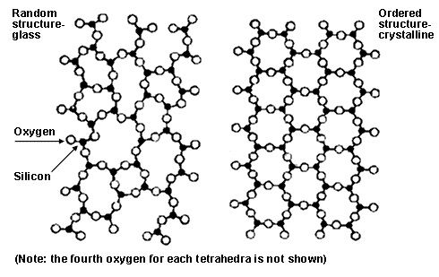

I don't think your assertion that glass is not a supercooled liquid is correct. If you look at the ternary phase diagram of the system Na2O - CaO - SiO2 (soda glass) there are a whole host of different compounds which can crystallise from it, most notably devitrite - Na2Ca3Si6O16. If molten glass is slowly cooled from above the liquidus temperature and held at or just below it, the mass will crystallise. The fact that it hasn't in your windows, is that the rate of cooling below the liquidus is such that the viscosity quickly rises to a level which prevents the atoms in the glass from migrating to take their places in a crystal lattice. Normally, a supercooled liquid is formed when the liquid is completely free of impurities which can act as seeds for crystal nucleation, and the system remains liquid below the liquidus temperature shown in its phase diagram. I would suggest that glass is in the same state - i.e. amorphous (non - crystalline) below the liquidus temperature.
As far as other materials (steel or wood for example) also becoming curved when supported at their ends, I would make the following argument.
I believe that liquid flow is the result of the elements within the substance rearranging themselves at an atomic or molecular level. This would be the case with an amorphous material such as glass. It would not however be the case in steel, where the rearrangement would involve crystalline components sliding past each other or wood which would involve the fibres sliding past each other.

Taking the first one - I quite agree that glass is amorphous, but that as an amorphous solid the molecules do not flow and rather than having a high viscosity as would be the case above the glass transition temperature, the molecules are joined together but not in a regular pattern.
Working at a more practical level - lenses and ancient glass objects would be expected to show some flow and windows would not only be thicker at the bottom but would exhibit flow over frames and the nails holding the panes into the frame, which I have never seen suggested. Hence I am of the belief that the thicker at the bottom concept is due to manufacturing rather than flow. The comment one sometimes sees that glass becomes more solid with age and very old objects are less likely to flow also appears to be at variance with the facts as it is the oldest building glass that is said to exhibit the most flow.
Referring to your second point, that the glass in your lab had to flow to change shape. You have explained how this cannot be the case with wood or steel but both of these materials do change shape and while I agree that it is not due to flow - I cannot agree that glass is a special case and has bent for a unique reason.
