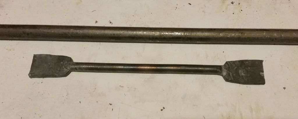

Here's another picture of one of the three forged handles on the loco. They were machined down in the middle from 10mm black bar then the ends forged using the oxo as heat. My connection is so slow I don't know if I'll manage the others of this today.Forged handles started.jpg

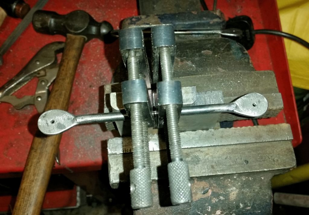

These are the jig used to bend the forged handles by smoking them up with the oxo and tapping them round and the finished job.Jig to bend handles.jpg

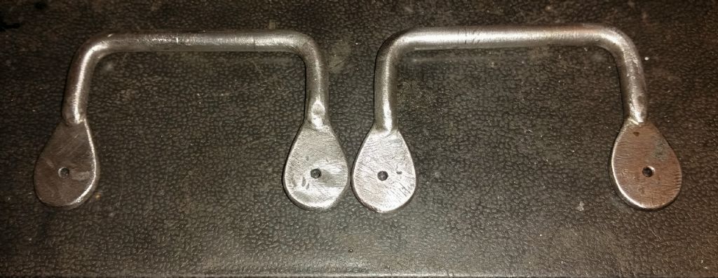

I couldn't get this in the previous post
