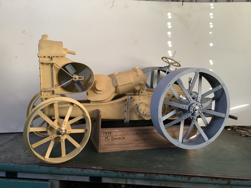

08/04/2021 09:24:29
Today I cast another front hub as a spare and to be used to set up machining operations. As they say “practice makes perfect “ and it doesn’t take much longer to make three than two when all the casting equipment is out. The photo shows milling the spoke flats making use of an adjustable angle plate and digital protractor. If all goes well one wheel should assembled by tomorrow night!
Fred.
06/04/2021 08:39:33
f3414bb3-b25c-4b91-8e1f-c69c0187d7cc.jpegIt did rain over Easter but not as much as anticipated. After many months of thinking and days of making the pattern for the hubs they have been cast today and I am now in the process of cleaning them up prior to machining the flats for the spokes to be screwed onto. The casting was a tricky operation and a process that you may not find in a book or commercial foundry as I used a cardboard mask around the outside of the pattern to pack the first box . It was then removed and the second box packed. With the pattern and mask removed the aluminium was poured in and you can now see the results. Both sides of the hubs have the flats machined at different angles (72 and 75deg) to accommodate the “dish” effect of the inside of the wheel. All this adds to the complexity but that is how the full size tractor was made and this is scale model and should be correct as near as possible. Thanks for the comments.
Fred.
