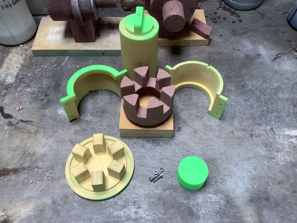

Development continues with the core for the water passage. I have tried to make this core using the resin sand but due to the complicated nature of the beast time runs out and the mixture hardens before I have a chance of finishing the packing. I am now trying the CO2 process as this gives me more time. The picture shows the packed core box, the plastic bag in which the core box is placed and then the CO2 is added in the form of the Sparklet cylinder and jig. The whole unit is then sealed up and the bag inflates with the CO2 and it is left to harden up. The first time I did this I hadn’t made the mixture strong enough and parts crumbled and so the experiments continue with the hope that I will succeed in the end. The changes in the colour of 3D printed core Cox is a result of continued modifications.
28/09/2021 02:13:07
This is the first half of the revised core and box for the water chamber and shows the castellated top. This leaves space for the water and the parts in between are for the cylinder head stud location. This was the easier half to make and the challenge is now to make the second half with all the ports spaces and supports.

This picture shows the results of some experimentation with the core for the water passage and proves that not every experiment is a success as the sand was not packed into the castellated sections tight enough Packing the core box in its present form proves a problem and a rethink is required to make sure the sand can be packed into all the recessed parts. This core has to fit over the core in the background and makes the space for the water to circulate around the cylinder. I may opt to make the core as two seperate pieces and glue them together but this will entail more 3D printing. While the printer is doing it job it gives me time to continue the design work on the injector pump and also the clutch unit - not much to show but work that has to be done.
Fred.
