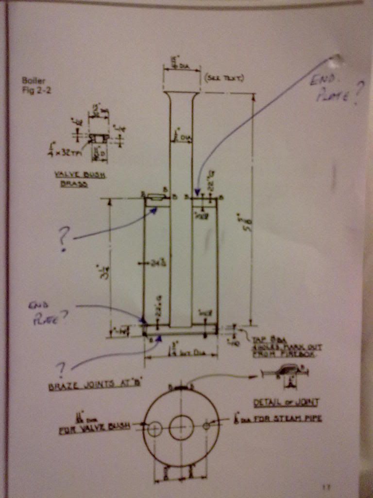

Hi , Yep i understand that but why are there two horizontal lines top and bottom ? isn't the end cap just one line with the flanged sides against the vertical sides of the boiler ?
25/01/2012 17:49:28
25/01/2012 17:45:39
Hi All ,
hare's a pic of the drawing of the little boiler for Tubal Cains 'Polly' :
[IMG]http://i5.photobucket.com/albums/y185/whitebeetle/002.jpg[/IMG]
I'm unsure about the drawing regarding the end caps.I have marked on the drawing what i assume are where the end caps are fitted but there is another line on the drawing top and bottom that i've marked with a '?'
Probably a silly question but is this another plate accross the bottom because i can't see any explanation of this in the text.
Any help appreciated
Chris
