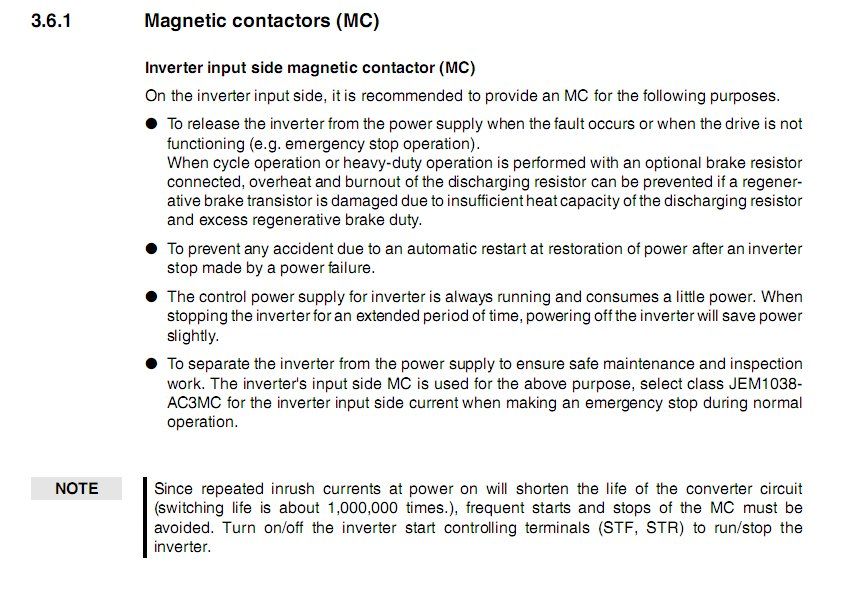

12/01/2017 23:53:58
I haven't fitted a contactor on mine by the way. I rely on the inverter and a switch. Mit list it as they do because this is often how things are wired, machine tools and conveyors etc. Metal boxed multipole isolator some where. A no volts switch, a contactor and a panic button plus any safety cut outs. People do wire the panic button to the inverter rather than breaking the supply and I understand some inverters say don't stop the machine by disconnecting the supply. I've not seen one though. The panic button wiring will vary according to the inverter. It need to stop the drive and prevent the start button from working. . Mit do a separate safety module but I haven't looked at the data so no idea what that actually does. Might be for something else.
What they effectively say is us a magnetic contactor to power the inverter, include a panic button and no volts type on off switching to the drive to that but start and stop the drive using it's controls. ie
What that means effectively is the usual no volts release switch and that it can be de activated by the panic button. They add a magnetic contactor because the inverter currents can be much larger than what these switches can handle. A NVR switch contains a contactor of sorts so the panic button can simply break the supply to that.
The current inrush when powered up will be there on all makes because of the capacitors in them.
If it sounds complicated I've heard unwiring even a simple Boxford that has been wired to the book can be a bit confusing. Most drop the lot.

12/01/2017 20:37:16
Going on my Mitsubishi inverter the emc mains filter is optional and only fitted if required. It has a built in emc filter. Lots do have now. They also show the fitting of an AC reactor in the mains line if needed. A lot of this is woolly because there are variables outside of their control In other words if the unit does cause interference fit a filter and maybe also a reactor.
They show a magnetic contactor in the supply and point out that this shouldn't be used to start and stop it. It can be done but it will shorten the life of the unit. They also show a current trip pointing out that allowances have to be made for in rush current . Effectively some large very high quality capacitors are being connected to the supply when it's powered up.
Later they give some numbers if the mains to the inverted is disconnected via an emergency stop to the contactor. Life 500,000 cycles dropping to 25 times if used for an emergency stop. (AC-1 rated contactor.) They then go on to mentioning what rating of contactor should be used on the motor side if that is used for an emergency stop. They also discourage doing this. AC-3 rating for any contactor there.
Most of the em noise from these units come from the drive to the motor. They stress single point earthing and shielded cable. Plus earthing of the motor and inverter. Optionally filters can be installed in this line as well. A simple one or one I wish I could get my hands on, a sine filter. (1hp if anyone wants to give me one.) These may be needed I assume on long feeds to the motor.
The earth current flow may have an influence on the rating of any earth leakage trip that is fitted.
They give minimum motor cable sizes based on a max drop of 2% over 20m.
Then comes sensible routing of the control cables. In other word keeping them away from the others. >= 10cm. They show shielded cable being used to the speed pot or current drive and also on the analogue speed output. Not on the rest though as all leads go to the inverter and represent 24v being pulled down with a current of 100ma max. I ran mine in a shielded cable.
Single point earthing in my case was provided by a slab of aluminium by the connection block so was pretty easy. No need to try and take all to a single bolt etc.
Most modern up to date inverters have a self tune facility buried in the menu and also motor modelling to help prevent over heating. Random switching too in some cases. That reduces noise.
They also mention that higher switching frequencies increase noise but tend to make the drive quieter. Really here they must mean noise power levels as I would assume that the switching waveform has the same rise times what ever frequency it is running at but I suppose they could play with that but doubt if they would,
indecision I did wonder but on my Meddings I changed the motor to a 240v. The main reason I changed drill was to get one with a back gear as on a few occasions I have wanted a lot more grunt at lower speeds. If I had gone the other way I would have wanted a more powerful motor - just as many do when they change lathes over to inverter drive from 240v.

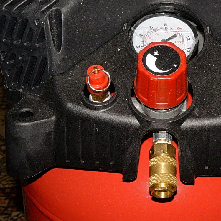

For anyone is mad enough to buy a hobby compressor that should give 100l/min at 4 bar and costs in my case a touch over £100 I've modified it a bit.
There was no filter or drier on it or output gauge. I was going to fix that with bent pipe and compression fittings. I nosed around and found Aroplus in Redditch. They stock a huge range of fittings for this sort of thing. Some items take a day to arrive but no min order and I could collect so no postage charge. Turns out it could be done with various BSP fillings.
The reservoir is vertical on this one so doesn't take up much floor space. The air outlet comes like this.
It's angled down which is why I though bend pipe.

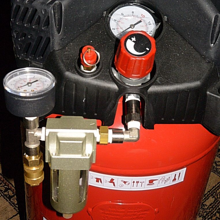

Finished up like this.
The fitting on the right of the filter is a breakable joint. Sort of nipple thing with an O ring on the nipple so can be rotated as needed and tilted a bit. The hole in the plastic to the left of the first shot will probably be needed to add a bracket to stop the stuff tilting when the line air line is pulled but it seems solid enough.
blushI aught to tidy up the ptfe tape.
Not sure if it's a mad purchase really. If I graft a twin cylinder pump and motor onto it total costs are probably lower than buying one like that. Actually it might save getting on for £100 and in any case might be ok anyway. It'll look a bit odd if changed but still take up little floor space.
