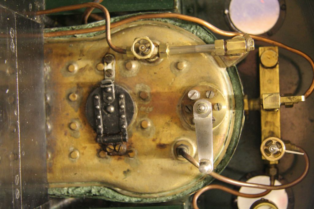

Thread: Water gauge problems
13/01/2014 14:26:45
Success at last!
I have sleeved the water gauge feed 'tubes' to the boiler down to match the glass bore, which I know is contrary to what you said, Julian, but it has done the job.
I had a steam up this morning, which was completely successful, the level being controllable throughout, with no problems at all.
So my thanks to you all for your kindly contributions, particularly about cleaning the boiler with the drain cleaner (sodium hydroxide) from Wilco.
Happy steaming,
Dave.

14/12/2013 20:58:07
I followed Julian's advice and reassembled the water gauge earlier this week. I tested it today (Saturday) on my short (80ft) track in the garden. Before steaming, I filled the boiler to half a glass. Annoyingly, at the beginning of the run, due to my glasses steaming up, I wasn't able to watch the gauge! When I managed to be able to see again, the level had fallen to the bottom nut, and stayed there as last time. I tried blowing down as Stick suggested, but it didn't help.
I continued running with the pump bypass valve closed all the time, and at least the level did not fall out of sight. I tried tilting the loco back during steaming, and the level did not change. As lunch was ready, I stopped the test after about 1/2 an hour, and let the loco cool down.
When the loco had cooled down , I tried tilting it back again, and the result was exactly the same as last time: the level rose to half a glass, and stayed there. To say I was disappointed is an understatement!
Has anyone any further ideas as to what I can try, please?
07/12/2013 20:59:16
I have stripped the water gauge today, (having just completed a decorating marathon for 'er indoors), and did not find any grunge in the passage ways in either fitting. I tried a piece of tapping size rod in the bottom fitting, and found it went along the side of the water space in the boiler rather than strike the inner firebox, so no constriction there. Also I found no extra amount of bush beyond the the inner face of the backhead plate.
What I also noticed was that the 'feed bore' of both parts of the water fitting was at 5/32 dia. This is 1/32 bigger than the bore of the 3/16 O/D glass. I have been looking at as many drawings of gauge glass fittings as I could find, and in all cases the glass bore and the 'feed bores' were the same. Could it be that the glass itself is the obstruction? And reducing the 'feed bores ' to 1/8 dia would be the solution. Or does this matter?
I am getting desperate! Please help.

07/10/2013 12:27:39
I have been rebuilding a 5 inch gauge Tich and fitted a new boiler. The loco has been steamed successfully numerous times, since January of this year (2013). The problem is that the water gauge always reads low, when there is, in fact, an adequate water level. The gauge glass itself has been increased proportionally in size for this 5 inch version to 3/16 inch O/D.
Recently, after a steaming, the water gauge showed level with the bottom nut of the gauge. I tilted the loco towards the rear, and on levelling again, the water level rose to just below the top nut and stayed there.
One thought was the top fitting of the gauge: this is a outside the wrappper, (as it is on Rob Roy). The hole from the boiler to this top fitting on LBSC's original drawing for the 3.5 inch version, is 5/32 dia. I have made the 5 inch version 7/32 dia. Is this hole big enough?
Any answers would be very welcome.
