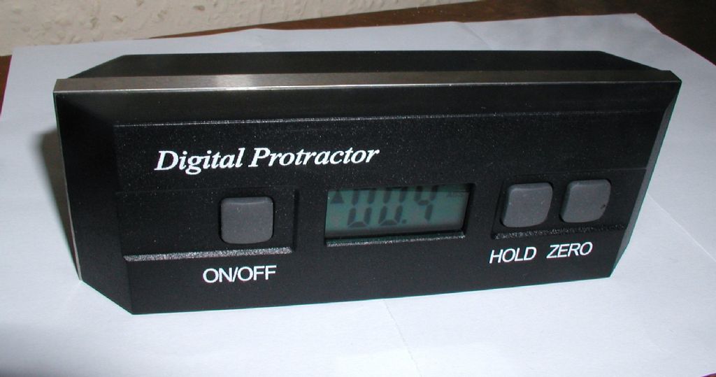

30/11/2010 11:15:08
Hi, with ref to John's post, 30/11/10, yes it is ideal to have the mill table level for a referance point to set up your work, but you can still do that if it isn't. The best way is to use an angle gauge or graduated precision level and read what angle your table is and then just add or subtract that to the level you want your work at.
I have one of these digital protractors, which you can set to zero at any level and then it will give you the direct differance at any other angle and there are little arrows on the left of the digits to show if it is up or down, but in most cases it is obvious.
Very handy and not terrable expensive, its resolution is 0.1 degree.
Regards Nick
