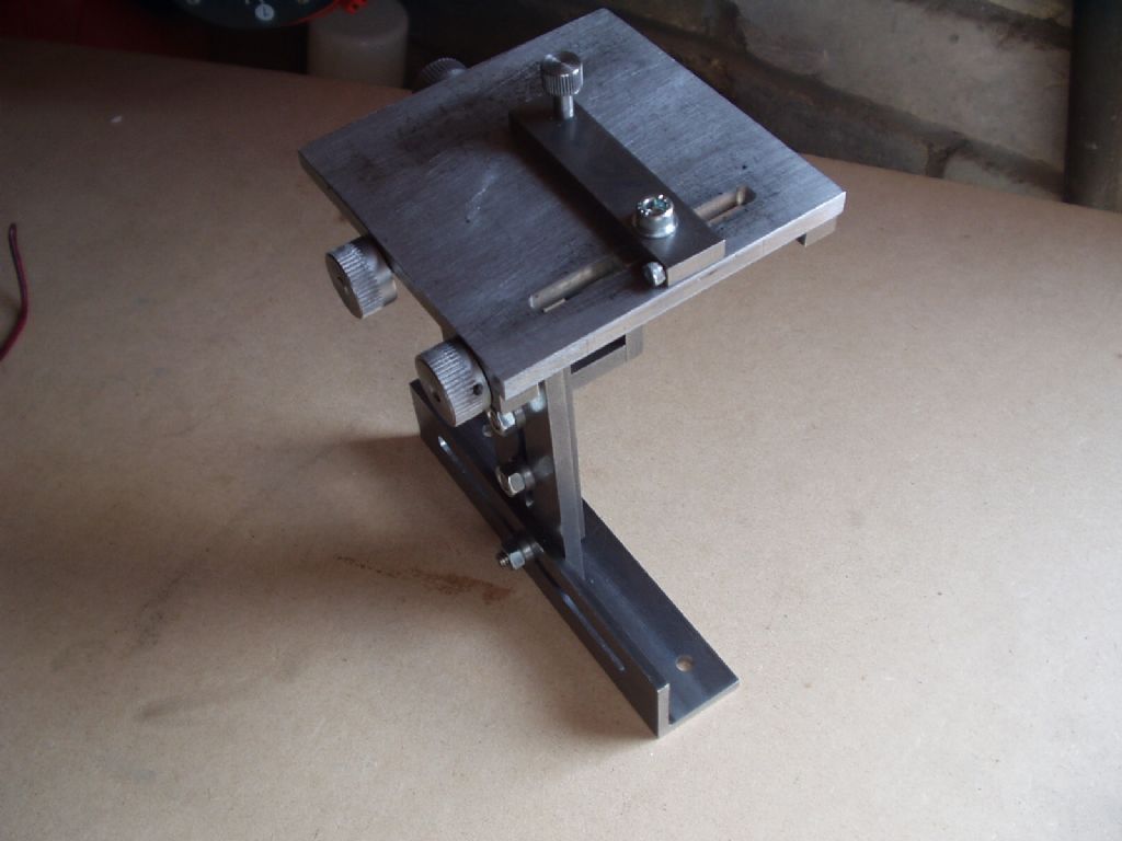

19/11/2009 21:18:29
Posted by meyrick griffith-jones on 19/11/2009 17:53:37:
More than anything else, it depends what you want to grind?
And what you want to make it on?
If you want to grind basic lathe tools, sharpen drills and do endmills, then the standard kits are fine - indeed perfect. Harold Hall, Worden Kennet.
If you want to start grinding tapers for reamers for injectors, or taps, taps for specials, cams for IC engines etc then you have to go for a Quorn or a Stent.
The Quorn you can build on a Myford if you have a vertical slide - the Stent I don't know.
I presume you have a dividing head that will do 360 divisions - or can get access to one.
Edited By meyrick griffith-jones on 19/11/2009 17:54:23
 OK, good question Meyrick.
Yes, at this stage I want to be able to successfully grind lathe tools, drills & milling cutters. Regarding reamers , taps & grinding cams I don't think so but maybe in the future ....?
So, that sounds as though its either Harold Halls's jigs or the Worden or Kennet.
regards
Ray
19/11/2009 12:19:48
Posted by David Clark 1 on 19/11/2009 11:09:09:
Hi There
For lathe tools, one of Harold's jigs would do fine.
For end mills and slot drills, I would buy a few from Ebay and use them till they are worn and then buy a few more.
You can buy an awful lot of tools for the cost of a set of cutter grinder castings and you can get someone at your local club to sharpen them for you or sell them on Ebay and buy some more.
I used to collect all the old cutters from work that they could not be bothered to sharpen and they all sold well on Ebay.
regards David
 Thanks for the suggestions David but maybe I should have said that part of the exercise could be the fun of building something too, hence my interest in the cutter grinder kits. I also forgot to mention the Wordon (?).
regards
Ray
19/11/2009 10:37:46
i have recently bought an old Myford Super 7 lathe and as a beginner I am attending a weekly engineering workshop course at the local college where we have access to lathes, mills etc. as well as a very experienced engineer to guide us through our projects.
It has rapidly become apparent that to get the best from the equipment the cutting tools have to be in excellent condition and sharp - something they are often not after use by the full time students!
So, what advice do you have re a cutter grinder for my home workshop to either purchase or build? So far I have found the Stent, Kennet & Quorn to buy castings/parts & build, the Clarkson to buy secondhand (Ebay) or I believe there is a simple jig to make in Harold Hall's book "Tool & Cutter Sharpening".
Any comments appreciated.
Chers
Ray
