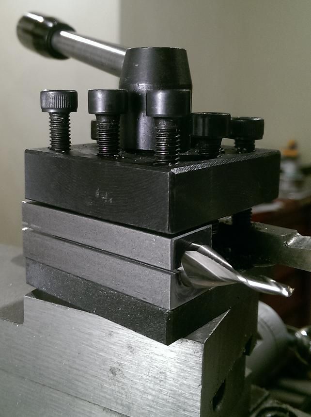

Okay, the 1/8" end mill as a boring bar worked well to square up the bottom of the hole and bring the diameter to 0.374"

18/09/2015 04:28:54
I decided to take the advice to use an end mill as a boring bar. Since I didn't have a way to hold the end mill securely, I made this tonight:

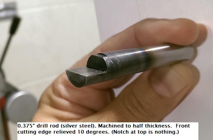

16/09/2015 18:25:01
Okay, like this. What's a good angle to relieve half of the cutting edge?

16/09/2015 16:32:19
Like this? I wasn't sure if the cutting edge should be relieved in two planes so the top view or the side view may be wrong.

16/09/2015 15:30:18
Thanks for all the replies.
chris: Yes, the cutting edge for that bit was honed with a diamond hone. It may look dull, but it's actually quite sharp. I didn't know about milling to greater than 0.5 x diameter. Thanks.
paul, jason: Ohhhhhh! I didn't think to use end mill as a boring bar. Great idea! I need to try this!
