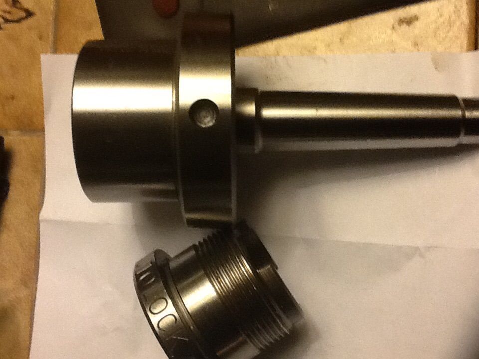

It appears that there are two forms of the large autolock chuck. The largest will take 3 different collets 3/4" 1" and 1 1/4". Plus three metric equivalents. The metric equivalents have a groove on the outer 'wings' of the collet. The one I have takes two imperial collets 3/4" and 1" only and the metric equivalents. The collets for mine are smaller in outside diameter than the large ones so are not interchangeable. The Clarkson chuck documents I have seen on the net don't mention my chuck. See Graham Wharton's post earlier for the part numbers of my chuck.

08/04/2015 19:30:40
As requested, the engraving on the chuck says:
3 MORSE TYPE S
BR PAT 915713
ENGLAND 1/2 BSW
Tim
P.S. If anyone has any of the 4 collets made for this chuck, do get in touch!
07/04/2015 21:04:45
Thanks for all the info guys. It looks like a medium autolock (didn't realise there was such a thing). I guess that the 3/4" and 1" collets for the medium and large chuck are different. Ho hum.
Tim

07/04/2015 20:22:04
iPads are not the greatest for this but .....
07/04/2015 19:56:19
Hi,
Well I give up. I obtained a Clarkson S autolock chuck and whilst it was on its way I bought a collet to go in it ( the chuck was just that, no collets or spanner). As you might expect the collet didn't fit - I thought I was getting a small model s chuck and a large one arrived. Ho hum silly me. So I got a 1 1/4" collet instead and blow me that doesn't fit either. The chuck is definitely a Clarkson and the outside dimensions match those for a large chuck. The collet looks like a Clarkson but is too big. It is also 32mm but that is another story. There is precious little data on Clarkson chucks on the 'net.
The chuck has an outer ring screwed on the body with Tommy bar holes, has a 3MT arbour and the number 40096 engraved on the back of the ring. The body is also engraved with Clarkson S and a patent number. The outside diameter of the collets needs to be 1 3/8 as near as I can measure it.
Before I spend any more money on collets can anyone tell me what I have got and what specification of collets I need to obtain?
All the best.
Tim
