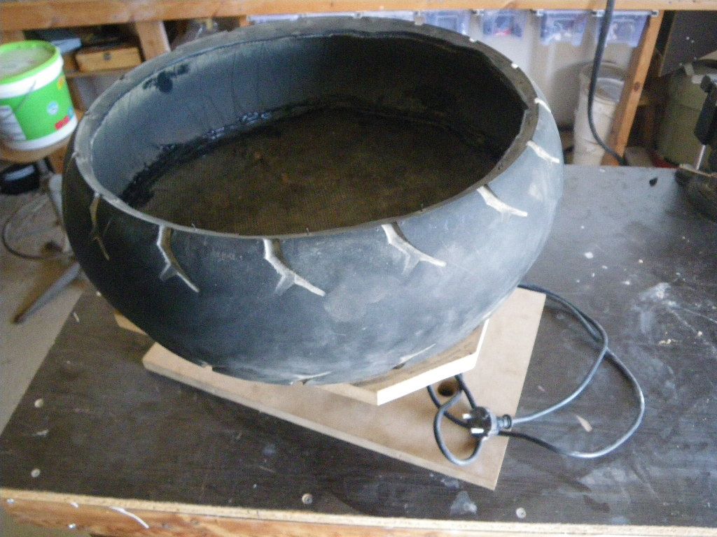

OK, Here are some photo's.
The tumbler is not finished yet, still want to add covers and I also need to add a central pillar inside the tire. So that stuff will rotate nicely.
Then I need to fill it up with medium and product and start to tune the counterweight and speed to get the right vibration going.

25/09/2012 07:00:57
Hey guys,
Thanks for all the suggestions!
These are more than enough ideas to go and test with.
I called the local nuts company to ask what they did with the walnut shells, but ran into a language barrier, I will try again when I have more time.
So, garden store, pet store and builders yard. OK, great.
All I need to do now is finish the thing so I can get a good finish.

24/09/2012 15:35:01
Hello good people,
I am building (almost finished) a vibratory tumbler using a rear scooter tire and an old electric motor from a car buffer machine.
I live in Cyprus and I am having great trouble finding the right material as media. I want to use the machine to clean and debur small stainless steel parts I am making.
Does anybody out there have a good idea what I can use? I was thinking of just trying sand with a little water. They also have a lot of granite grit here, will that do?
The problem of course is that I might be able to find the nice ceramic cutting piramids etc, but I will have to order on-line and the postage to the island just makes that far too expensive.
Looking forward to your comments and suggestions. Thank you in advance.
