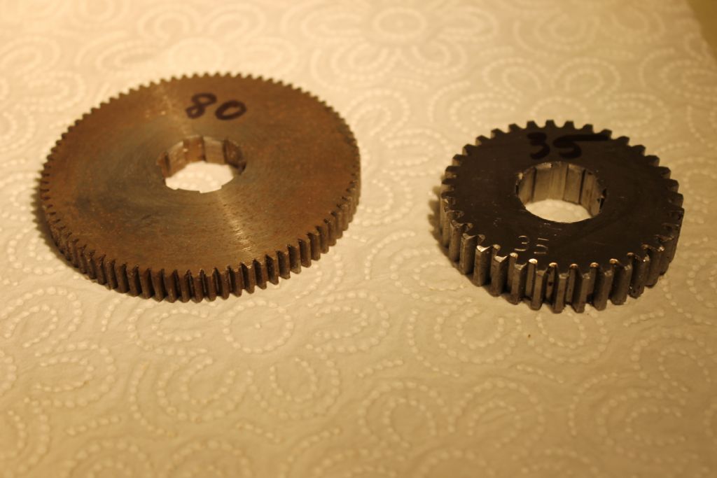

Thread: Identification of change wheels please
19/06/2018 09:42:55
Apologies, just realised I forgot to post my reply from Boxford re above gears - 'they are from a manual X10 lathe'.And a '5 Star Award' to Gary B at Boxford for going to the trouble of finding out.
Thanks to all again.
Jim
27/05/2018 15:43:19
Hi not done it yet.
Many thanks for the reply. When I checked several of this set the calculations came out between 25.2 and 25.5 with one at 25.8... I assume the deviations came from my measuring..Have rattled my memory I think (!) the set may have come from a 'shop which got a Boxford T series in the early 1980's. This would, of course, have been metric.
Jim
25/05/2018 20:52:54
Many thanks to all who replied, especially Thor for directing me to an earlier posting.
Using the number of teeth/diameter formulae the course tooth set is 16DP which, according to the late Sir John is ‘early Colchester’s, round head etc 16 DP splined bore, some 6 some 8.’
The finer tooth wheel I get a 25DP and has 6 splines.I have checked the net without success for possible user. Anyone have thoughts?
Jim
22/05/2018 21:04:56
gear change wheels.jpgCan anyone please identify these change wheels.
The course tooth set has a spindle hole dia of .875” (22mm ish), a wheel thickness of 1/2” and 8 splines– the set comprises 18, 30,33,35,42 and 45 (perhaps Colchester?)
The fine tooth set has a spindle hole dia of .900” (23mm ish) with a wheel thickness of around 9mm - not all are the same - and has 6 splines – the set comprises 40,42,44,45,52,56,60,80 and 96(?)
Edited By JimmieS on 22/05/2018 21:05:16
