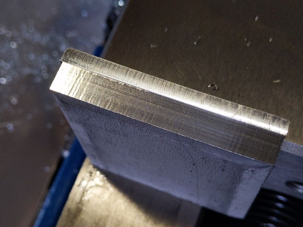

So here's the facing vs side milling. I'm happy enough with the face finish, those ridges are fairly even and the surface feels smooth. This is with a 10mm rougher (the side milling was with the 6mm HSS 3F I think).
The rougher doing side milling is better than the other tools, it's much more regular, but still has those vertical dents.

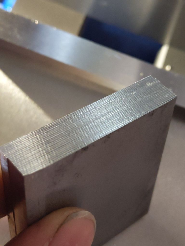

I tried climb milling and did get slightly more consistent finish, but still the reticulation. Could it be not enough flute engagement? Not taking deep enough cuts to keep a constant pressure causing the tool to bounce?

Is it possible to achieve smooth surfaces when cutting with the side of an end mill in stainless steel (316)?
I have been able to get very acceptable smooth finishes on the lathe, but the finish on the mill is very uneven - reticulated might be the right word to describe it, and difficult to sand out. I'm not sure if this is user error, chatter or perfectly normal?
I'm using as little tool stickout as possible in an ER32 collet, one was a 10mm the other a 5mm end mill.
I also tried eliminating the vice but had similar results with the work bolted direct to the table.
The only thing I've noticed is a knocking from the upper part of the spindle with it in neutral and rotating by hand, and some flex in the column of about +/-0.075mm at the collet pushing it by hand. No idea if either is normal or not.
Perhaps my expectations are too high?
Here are some pics
Another piece after a quick sand to see how deep the lines are.pxl_20230704_113744183.jpgEdited By s d on 04/07/2023 12:56:22
