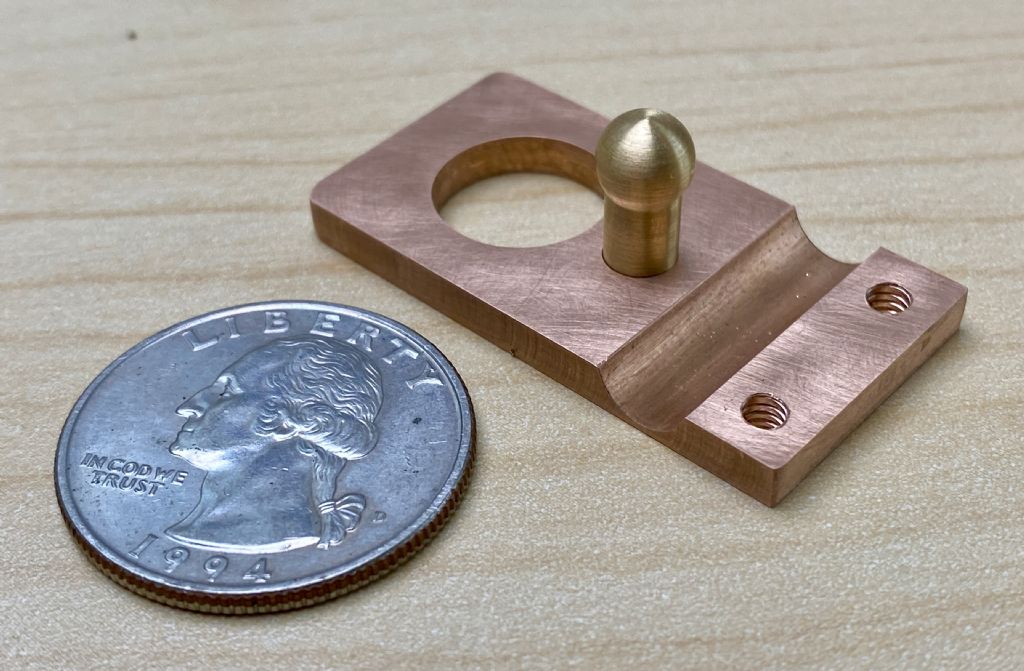

A little more progress: I've completed the stage, which takes the place of the plastic version seen above. It's made from 510 bronze, with a brass ball on which the micrometer pushes. I gingerly tested the flexibility of the hinge, and it will move, but I may have to thin it a little more - not sure yet.
I've decided to fit the "slides" (10mm glass windows) into little 3-D printed holders, which then drop into the 12mm hole. In the event that I get the lens-to-slide distance badly wrong, I can reprint the holders to adjust the slide's position.
Still left to do is create a few mm thick shim with a very slight angle to set the distance between the body of the microscope and the stage, and drill the microscope's body to accept the stage. However, I'll soon need to mount the lens, at least temporarily, along with a slide, in order to judge how thick the shim needs to be, and perhaps what kind of angle to set. Then I'll be nearly done.

Not really. I wanted to maintain at least some resemblance to the original, and a steady flat face is a virtual necessity due to the shallow eye relief. He got that part right.
I ordered a sheet of bronze this morning, and it came this afternoon. McMaster is amazing.
It's cold-worked 510 bronze, and it definitely has a lively, springy feel compared to the dead feeling of brass.

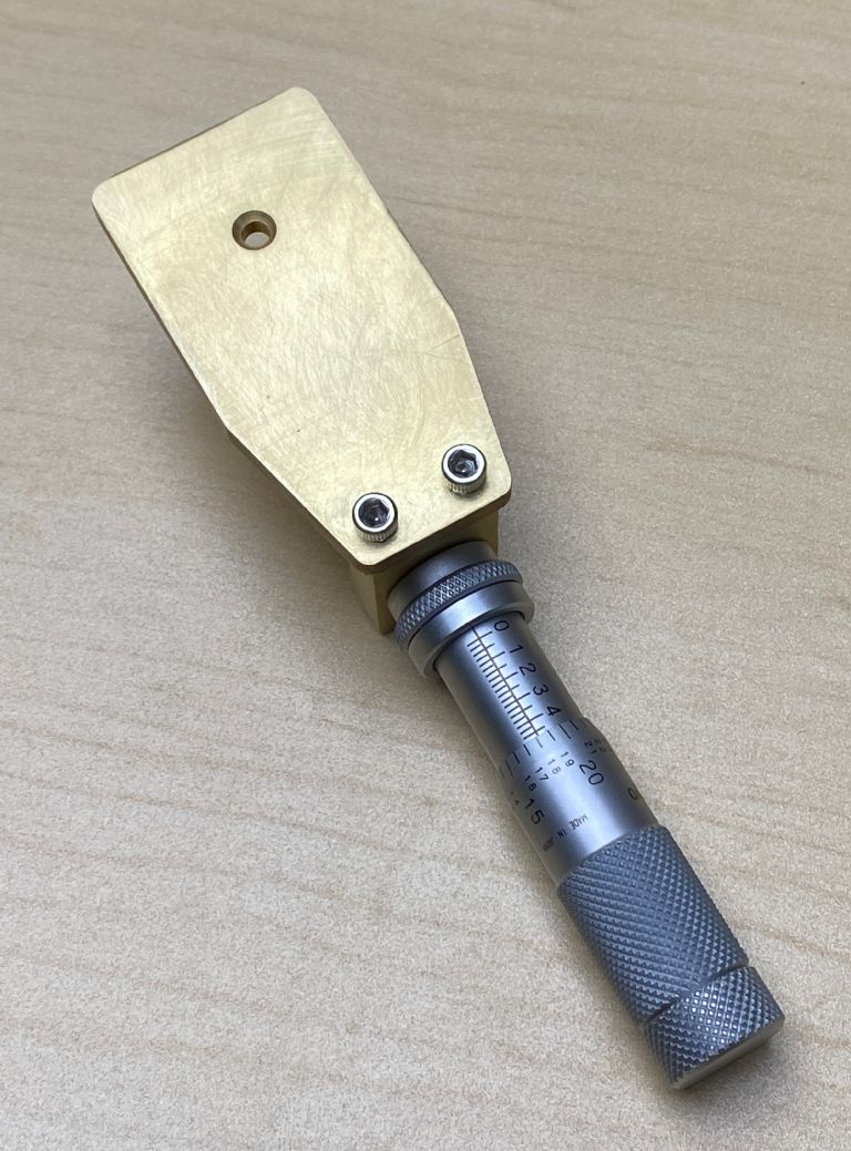

17/05/2023 22:15:06

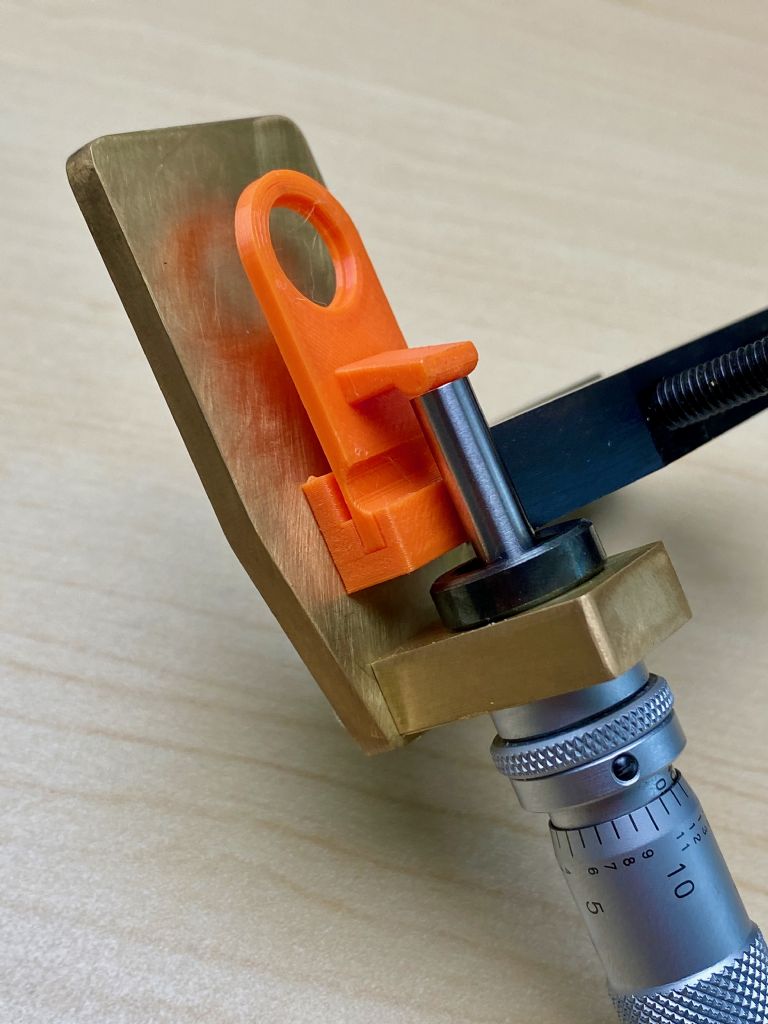

I printed out a hinged stage to see how well that might work, and it works pretty well. It's just clamped in place so I could test its behavior.
It's a simple technique, though it has the disadvantage of losing parallelism to the lens while focusing (the original had the same problem).
The translation ratio (stage movement / micrometer movement) is a little below 1:1 at the lens, so a small reduction, which is fine - I wanted to avoid amplifying the micrometer's motion.
I think the right strategy would be to position the stage tilted slightly up (higher) than the nominal focus point when no micrometer pressure is applied, but such that the stage is flat when the micrometer moves it to the nominal focus point.
One of the goals of this project is to gain some experience with machining, so I'd like to do this in brass, too. But the prints are very helpful to test ideas and work things out, including the important task of calibrating the point of focus.

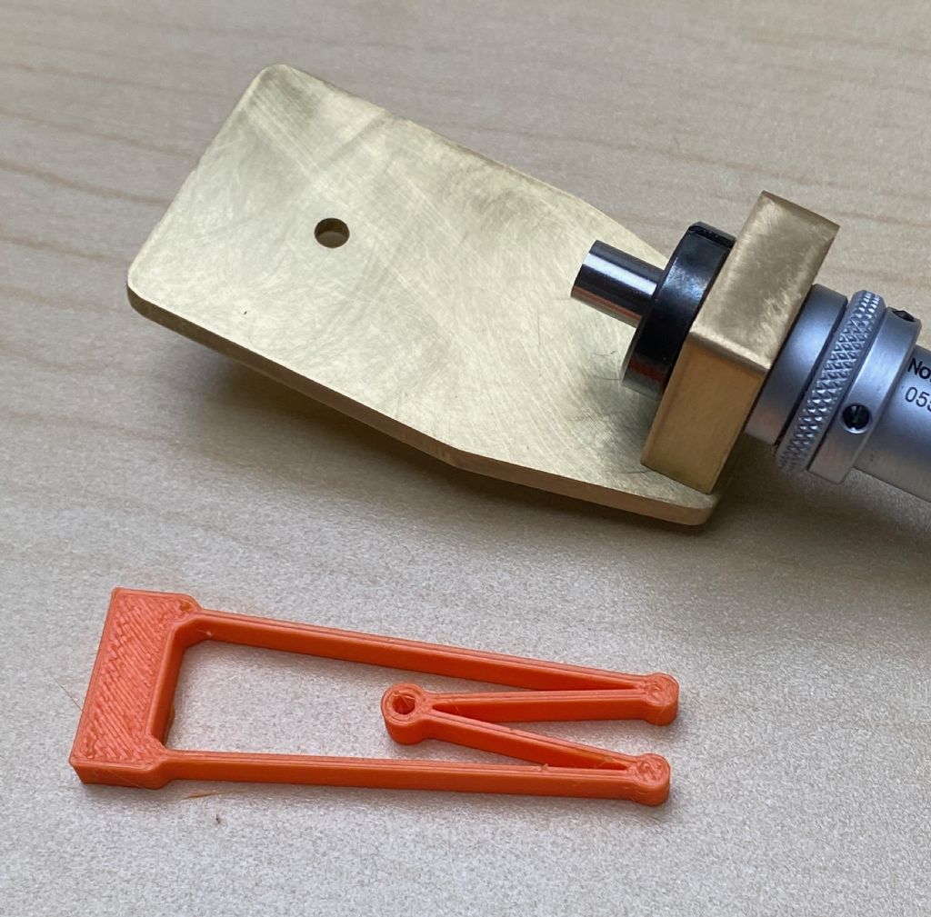

I printed a primitive flexure as a test. It wasn't printed to proper scale or with any real thought.
It certainly is flexy, but I'm not very happy with how it moves. It's actually too flexible and I think it would have to be stiffened a fair amount. It's printed in PETG, which I use for pretty much everything. Maybe PLA would be better.
It's also becoming clear that miniaturizing an entire table that moves properly on flexures will not be easy. I might abandon this approach and go with a much simpler hinge-type mount. That has the disadvantage of tilting forward or backward out of the plane of the lens as it's focused (as Leeuwenhouk's did), but it may suffice.

17/05/2023 02:18:19

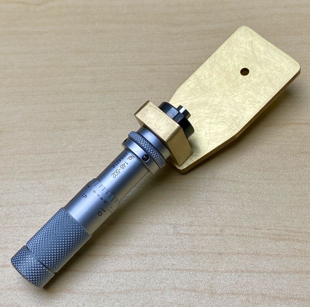

I've made some more progress. 🙂
I had a small 1/2" micrometer head in my drawer, and thought it would be a perfect addition. I'd like the micrometer to perform focusing rather than vertical translation as in the original. It may be sacrilege, but I think it works! 😀
The front, facing towards your eye:
And the back, facing away:
I will explore some sort of flexure for focusing, but I think I'll do that in 3-D printed form, at least at first.
Fun! 😄

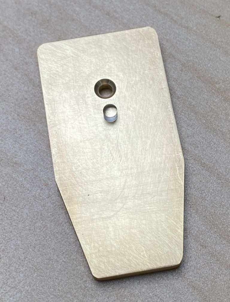

I've started a Leeuwenhoek microscope project. There have been many replicas made by others, but this one will be mine. 🙂
Leeuwenhoek did not exactly invent the microscope, but he is famous for the many original findings made via his instruments, enabled by his secret method of making superior lenses - a secret he took to the grave.
His instruments contained a single lens element of high power. They were originally thought to be tiny glass beads (spherical lenses), but some recent examinations suggests some or all were bi-convex in shape.

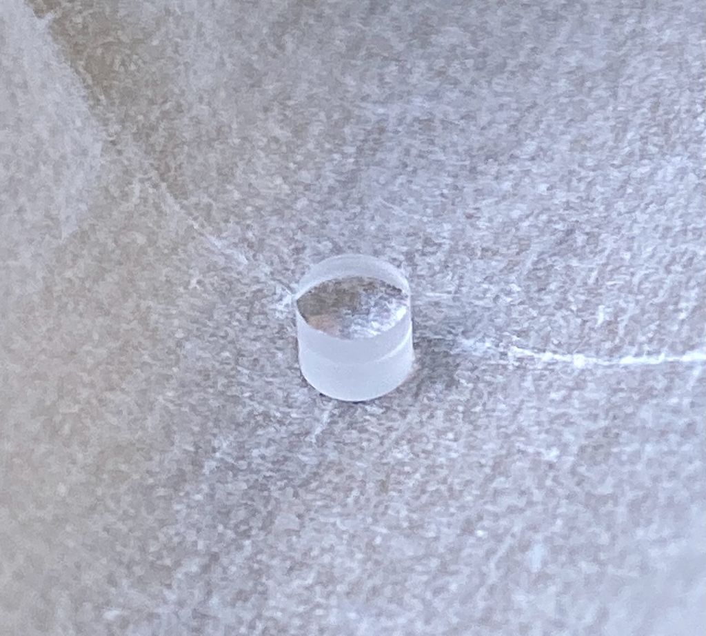

Instead of blowing or grinding a lens, I simply purchased one. It's a tiny 2-element optically-coated achromatic lens that is 3mm in diameter by 3mm thick, and with a 4.5mm focal length. This makes it very high powered at 222 diopters (a typical magnifying glass is 4 diopters), and is in the neighborhood of Leeuwenhoek's various iterations.
An achromatic lens is typically made from two different glasses (classically, "crown" and "flint" glass), usually cemented together, such that the two glasses partially cancel out chromatic aberration. This lens also has a magnesium-flouride anti-reflective coating. (It was not cheap!)
Using a 2-element coated achromatic lens is an unfair advantage, since achromats and optical coatings were hundreds of years into the future for Leeuwenhoek. But if he had these technologies available, he certainly would have used them!
Here's a picture of the lens. You can see where the two elements join.
I temporarily mounted it and managed to view things through it, and I have to say it's quite difficult to use, especially due to the very shallow eye relief. In retrospect, perhaps I should have bought a larger-diameter and longer focal length lens. But once you get it right, it provides a surprisingly high quality and highly-magnified image that I'm sure Leeuwenhoek would have enjoyed.
Leeuwenhoek mounted his lens sandwiched between two thin sheets of metal that were then riveted together. I chose to use a solid piece of brass, into which I drilled and reamed a 3mm hole as an exact fit for the lens. This avoids obscuring the lens' periphery. I'm a bit terrified with the idea of using a retaining adhesive on it, though!
As the brass was slightly thicker than the lens, I added a countersink on one side so the lens can sit a tiny bit proud on both sides. That way, the lens can hopefully be kept clean a little easier.
The body of the microscope is paddle shaped, about an inch by two inches. It fits comfortably pressed against your cheek and nose. This is essential, since with such a shallow eye relief you need to brace it steadily lest you poke your eye.
Here's the body in its final shape, with the reamed and countersunk hole for the lens. The lens is sitting on it.
So just a little progress so far in a relatively simple project. Still to be done are to add a translation and focusing mechanism, a clip of some sort for holding the subject, and a handle.
