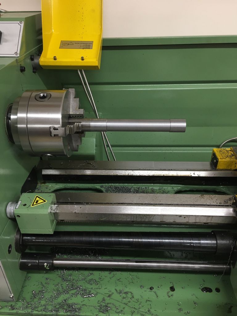

img_1231.jpgimg_1232.jpgSorry to raise this old chestnut again, but I have just bought my first lathe and need a bit of guidance regarding reducing concentricity error. I have installed a new Warco WM280V onto a Warco metal stand, which is in turn bolted down to a concrete floor, see pic. The floor seemed pretty flat, and the stand did not rock. I made a dumbbell test bar using 25mm mild steel secured in the 3 jaw chuck, with a 120mm central section reduced by 2mm, see pic. I then made a 30mm long 0.05mm cut on each of the dumbbell ends using a carbide tool (SWGCR1215H06) using powered feed at the lowest speed rate (0.07), and spindle speed of 400 RPM. Note the total length of bar beyond the chuck jaws was 40mm (to clear the chuck guard) + 30mm + 120mm + 30mm, so 220mm in total. I then used a digital vernier to measure the resulting diameters, with the result that the tailstock end dia. was 0.15mm larger than the chuck end. I repeated and got the same result again (yes, the definition of madness!). I then tried relaxing the fixing bolt at the front tailstock end, with the same result. Before I start shimming and so twisting the bed, I want to make sure I'm not doing anything fundamentally wrong. Key questions are: 1) is the overall arrangement OK, 2) is the bar too long 3) would it make much difference if I used an HSS tool. Another issue that I don't understand is that I used the DRO to measure the 0.05mm cut, so expected 0.1mm to be reduced from diameter, but the actual reduction was over twice that - so maybe I need to calibrate the DRO (thus far I've only switch it on), and may inadvertently taken taken cuts in the region of 0.1mm. I have had to stop tonight for reasons of domestic harmony, and plan to crack on tomorrow - any views / guidance / suggestions would be gratefully received!
