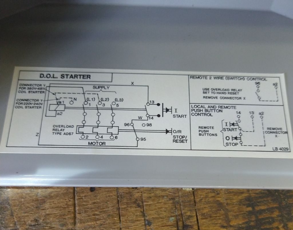

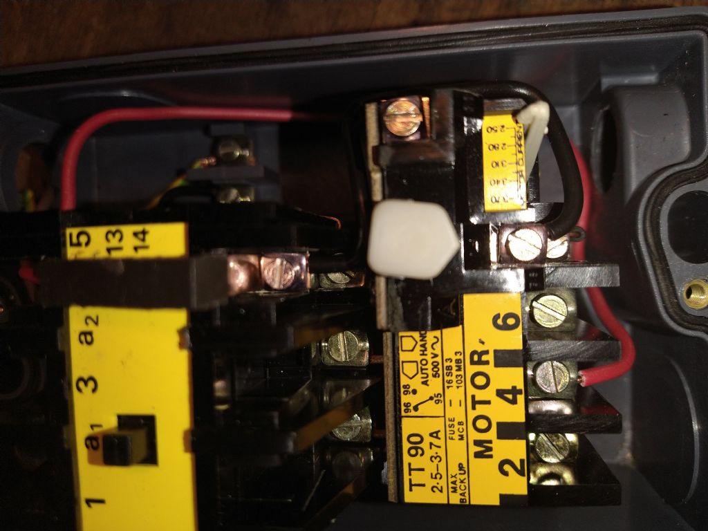

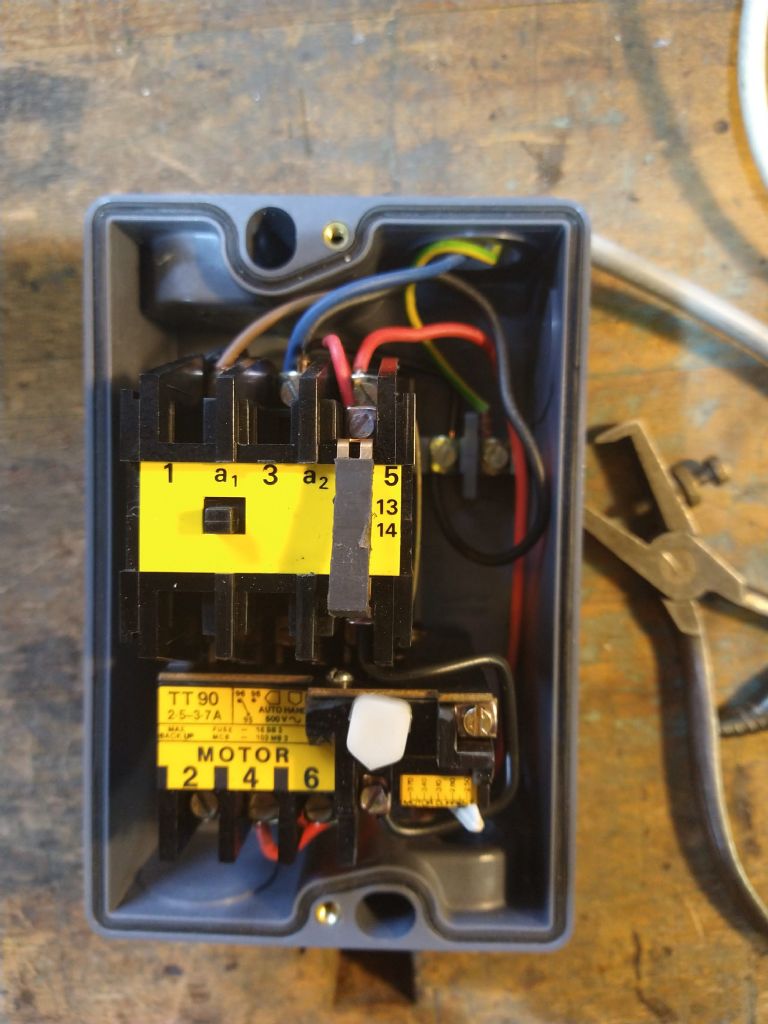

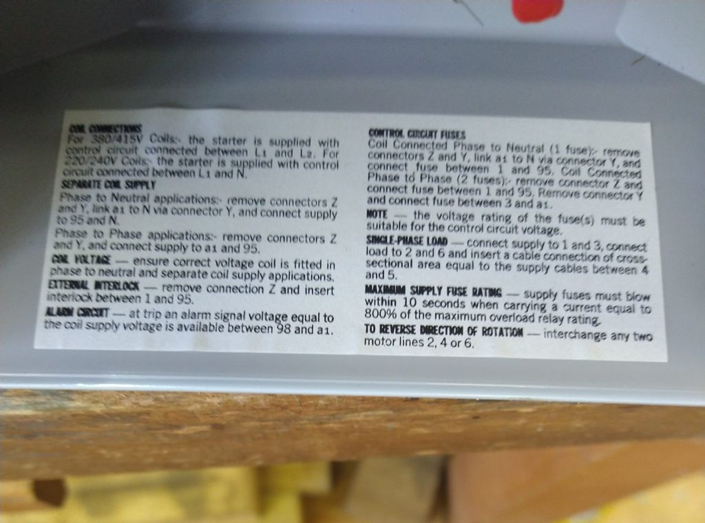

Thank you both, all working now. I connected neutral supply to the coil and left everything else as was. Motor connected to 2 & 6img_20210428_112554444.jpg
27/04/2021 17:28:02
I am trying to wire up this switch (above) to a small single phase lathe. I have followed the diagram, but the magnetic switch does not operate/energize. If I activate the switch with the manual button, the output to the motor becomes live as expected. Can’t see what I have done wrong, help!
27/04/2021 17:27:10
img_20210427_165153684.jpgimg_20210427_165129027.jpgimg_20210427_165113860.jpgimg_20210427_165057044.jpgimg_20210427_164918214.jpgI am trying to wire up this switch to a small single phase lathe. I have followed the diagram, but the magnetic switch does not operate/energize. If I activate the switch with the manual button, the output to the motor becomes live as expected. Can’t see what I have done wrong, help!img_20210427_164909776.jpg
