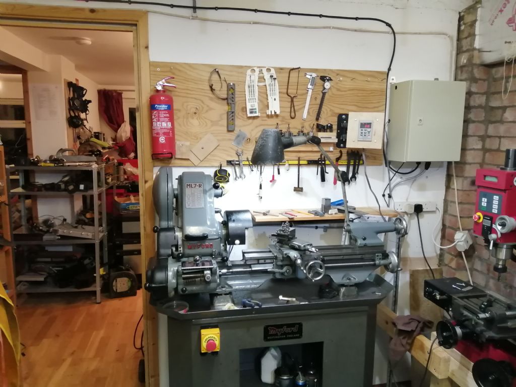

Just a quickie to say thank you to all who helped, and for your patience. It's working a treat, very happy bunnies!
16/09/2023 12:16:18
Thank you Noel - most of that went over my head but I understand the concern about somebody who clearly doesn't know what he's doing (me) trying to deal with a mains electricity problem! I'm pretty cautious by nature and recognise my ignorance, hence my endless questions
The one thing that I wasn't confident about was the plug wiring - when I did the screened cable, it all sat in nicely; the rubber encased cable we switched to was strangely more difficult to get to sit properly. I couldn't see any loose cables/ threads, but decided to rewire the plug - hey presto, it's now working perfectly, and the lathe is running beautifully!
In the meantime, I checked all the connections are secure, as per yours Noel.
I now need to set the parameters and we'll be ready to attach the enclosure to the wall.
Apart from the Estop, I'm going to set undervoltage to 180, overvoltage to 260, and reduce Main current overload to 2500 mA (following advice on a Myford forum) unless anyone here can suggest those aren't good settings?
I'll report back in due course

OK, problem.
I just tried a dry run before attaching the enclosure to the wall, and it tripped the consumer unit. The circuit I tried it on is very sensitive, so I ran an extension cable from the circuit supplying rest of the house, and on which I initially tested the VFD and motor (and which worked fine), but it now trips the power protection plug. So it trips on both circuits.
The only thing that has changed physically is the earthing, and the location of the 3-phase motor on the lathe. Should I now connect the earths from the single and 3-phase cables direct to the vfd to check it still works as before, ie before I did the earthing to the enclosure? That would pinpoint the issue as the enclosure earthing. Or are there other things I can check first?

Thanks all. We went back to the shop and bought a different type of earthing gland, the screen passes through the gland, is formed into a couple of pigtails and those are held in the two slots in the thread by a copper washer and a nut. It's now mechanically secure. The 240v input is now a rubber-coated cable, 1.5mm2, connected to the enclosure with a plastic gland.
Can you take a look at the setup within the enclosure and let me know if you can see anything obviously wrong? We still need to snip off the screen pigtails and the black cable yet to be connected is for the Estop.
14/09/2023 10:15:19
Also - I'm using an earthing block, but the connection doesn't look terribly good compared to a round crimp connector attached to the back plate by a bolt. Two earth cables will go in (from the in and out power cables), one out to the vfd. Does the earth block look ok, or should I fit a bolt and have three crimp connectors onto it?

Is this how you'd expect the screen to be connected to the earthing gland? It looks a bit scrappy to me, but the wires are held firmly to the gland. The gland was described as suiting the size of cable but was in fact larger, so I put an O-ring between the inner insulation and the screen wires to take up the slack.
