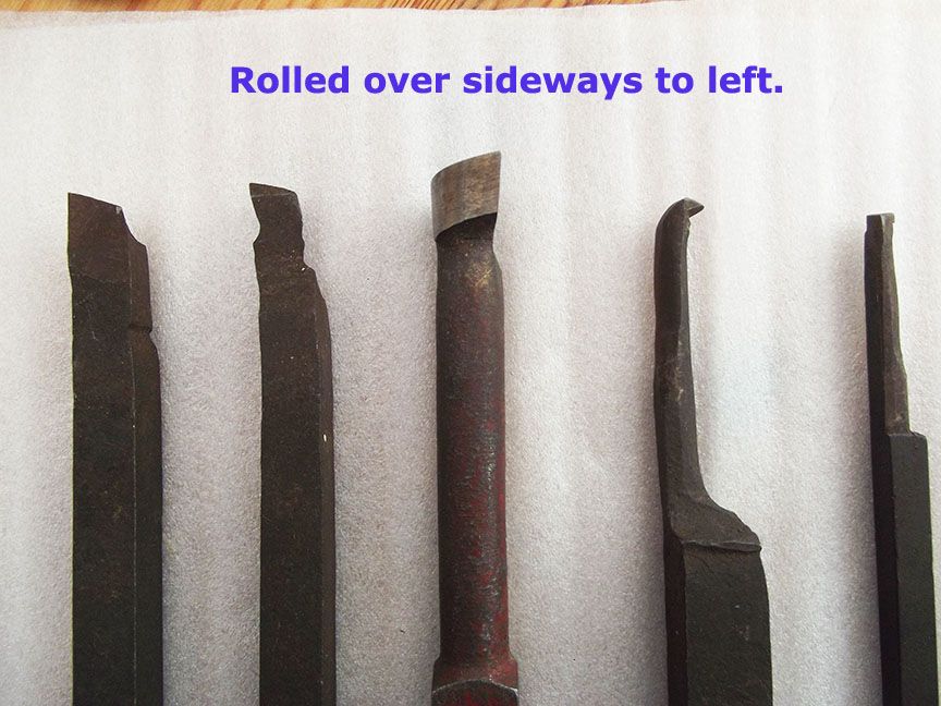

Thanks for the info on what the existing tools are guys. I have found a 6th tool in there now, which I initially thought was one with a broken tip but on closer inspection it is perhaps a regular turning tool, as appears to have three ground surfaces on there akin to the pictures in the link that Thor has kindly provided.

29/09/2019 19:20:14
These are the five tools that came with the lathe (thanks to David for telling me how to get photos on here.
I am guessing the left hand two are parting tools. The centre tool is unknown but with a 13mm square it going to be too big for the toolpost. The two right hand cutters have a tiny cutter at a ninety degree angle to the shaft so presume they for thread cutting.
