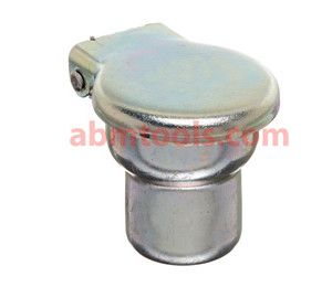

14/08/2019 17:22:12
Thanks everyone, I did look everywhere but I wasn't sure what they were called.
14/08/2019 13:04:29
Nice one, would you know the size for the motor (standard)
14/08/2019 12:57:46
I need two of these for my Brook Crompton motor.
