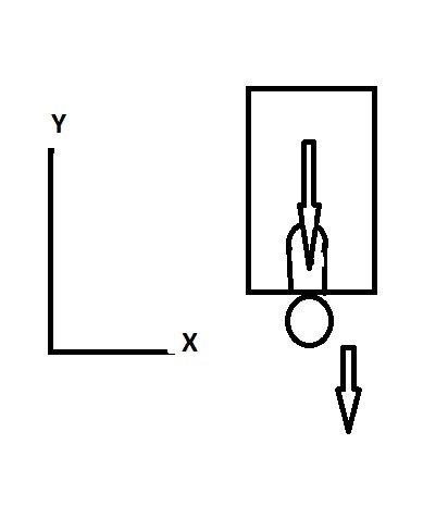

24/09/2020 15:20:05
Posted by Emgee on 24/09/2020 15:05:10:
Chris
My original comment was that they were both wrong because of the direction of cutter and relationship with the arrows that I mistakenly took as cutter movement, not workpiece movement.
The video link I uploaded starts with climb milling and then moves to back of the work to conventional milling.
Emgee
Edited By Emgee on 24/09/2020 15:09:05
Yes having a second look they are both right for work movement
Chris
24/09/2020 13:47:28
Clearly changing from tool movement to work movement turns it around.
Emgee
Would do if they were correct for cutter movement but I don't think they all are...correct me if i am wrong?
If the text that we cannot see states X axis is for cutter movement and the Y axis for work feed then fine, otherwise in error.
Chris
Edited By Chris TickTock on 24/09/2020 13:48:23
Edited By Chris TickTock on 24/09/2020 14:15:14
24/09/2020 12:25:48
Posted by JasonB on 24/09/2020 11:30:14:
Chris, the first hit on dave's web search gives a good image of cutter in relation to each sid eof work for external cutting.
Thanks Jason, when struggling to first get this understood the arrows can be confusing. Here they show cutter movement which translates to stock feed with cutter still. It is easier to understand with arrows denoting the stock feed direction. Not a problem now i get it (hopefully).
So a quick summary, please put me right if I go wrong:
1. Lead screw mills should use conventional milling as table forced with each flute against back lash)
2. if only light cuts are to be made you could mill in either direction
3. No baring on plunge cuts (hole making and slots)
4. If heavy cuts are taken opposing forces cancel each other out. (why on earth would you take such a big cut, not on my Sherline I think/)
Chris
24/09/2020 12:15:15
Just consider your own sketch, and what would happen if you decide to widen that slot by shifting left or right on the X axis.
Good point Michael. My sketch wrongly has cutter force represented as a single force. In the sketch as is opposing forces cancel out trouble. However it is an interesting point if I went to widen the slot. I could cheat and just take light cuts of course which is probably all that is needed. If a larger increase is called for then if I was to use the same cutter, each side would need to be positioned accordingly.
Chris

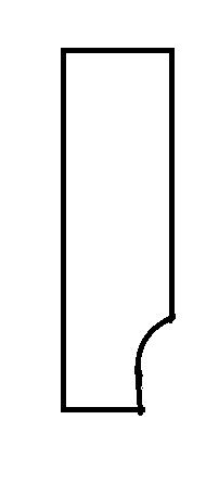

21/09/2020 18:24:18
radius sketch.jpgPosted by JasonB on 21/09/2020 18:18:32:
put up a drawing
Hope this helps. Remember this has to be fairly precise. As I said I would be minded to say put the 3mm dia end mill to the side of the stock, zero hand wheel, then raise the end mill move in the specific amount plunge cut and move forward to remove front remnant. Is this the wrong way to do this Jason/
Chris

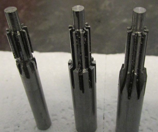

21/09/2020 16:51:50
Posted by SillyOldDuffer on 21/09/2020 16:41:51:
Posted by Chris TickTock on 21/09/2020 14:55:05:
Anyway I have attached a photo of my first, second and third attempt. The third when polished up would work, is a fair product but will hopefully get better with a tweek here and there in future.
If your No 1 were my first attempt I'd be pleased with it. Although I've picked up several tricks since retiring into Model Engineering, tackling a pinion like that would be a new challenge for me and highly likely to go wrong.
Expectation management is all part of the game. Sooper-dooper equipment and materials with a dash of good advice doesn't guarantee instant success; we have to develop skills. And recognise it takes time and they're unlikely to develop in a straight line. Not uncommon for second attempts to take a step back, and for number 3 or 4 to leapfrog ahead. Or for skills to plateau before improving again.
Main thing is to not be discouraged by poor results: take a break, ponder the problem, and try again.
Dave,
Wise words 'expectation management', I expected it to be easier than it was. Of course it will become so with practice, providing I learn.
chris
21/09/2020 14:55:05
Update after re think
I think it might be beneficial for me to post my thoughts after attempting and succeeding cutting a pinion.
Firstly it is not easy, take your eye off the ball and you will readily cock it up.
Secondly the method I used was given to me by Jerry Kieffer an American horologist and craftsman, some folk despise his machinist stance others like me admire him. Jerry has always been patient and polite and I respect him as I do to all who post with good intent. Having said that Jerry is really patient and kind to give advise but you have to learn to use your machinary well and think for your self at the end of the day.
This was a good example of a relative greenhorn taking on a fairly difficult task. I cocked up many ways until i thought why. The main reason was lack of experience and yes...tiredness.
Thirdly I have looked at alternative ways of making a pinion and in particular Mike Crossfield has been very kind in helping out on this. As far as I can best fathom from looking at Mike's way there are different ways to achieve the same outcome and I cannot see why one is superior to the other. Mikes cutter will possibly reduce vibration so will be something for me to try when I have a few spare hours to compare.
Regards to all
