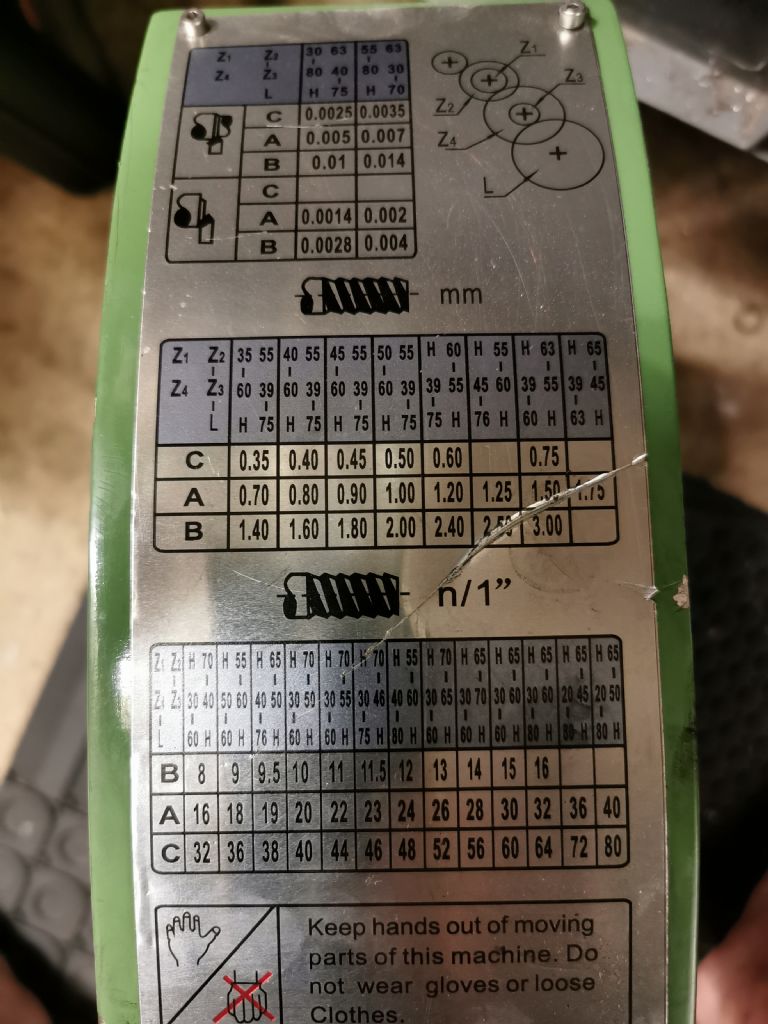

Back again
This is the illustration I have on my lathe, in charts quoted by your kind selves there are only 4 gears quoted when mine contains 5?
My understanding is z1 + z3 are drivers as they are transferring rotation onto other gears but where does this leave L as it transfers rotation to leadscrew?

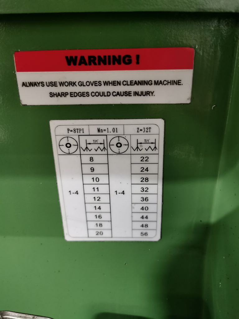

Also never fully understood this one either, does it mean I can literally select any point on threading dial to cut these thread ranges? What does Mn relate to and is z =32T referring to the gear on end of leadscrew?
07/07/2021 18:51:45
Aha the penny dropped, Nigel you were spot on with your calcs I have a 40T pinion.
Guys ALL your help is invaluable and very much appreciated.
I will get that book/books for sure and further my understanding. All these machines I have used for so many years and never given any thought to what was actually occuring within. Until now as you are all most probably aware it's been a simple case of following chart and selecting levers to correspond, and to be frank if Warco gave a better selection of change gears with their lathes then I most probably would never have looked any further.
Hats off to you gents, this knowledge will eventually wilt in the age of CNC and mores the pity cos once it's gone it won't return. Excuse my pesimism but I see it every day, young men today are not as skilled as previous generations gone by, not thru any fault of their own but via a massive leap forward in technology.
A massive thanks to you for taking time and explaining it all in such great detail.
