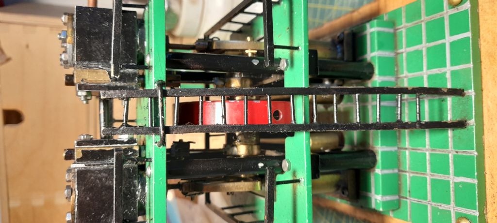

Thank you Jason, i see what you mean, i'll try a bit later to flip the valve chest and hope it lines up. It will eventually be steam run once the boiler is made.
Love your video, thats stunning. don't half get a move on doesn't it.
really appriciate your help
04/02/2023 16:00:54
appears to be an exhaust 'hole' right next to the inlet, but no fixing. did try running on a little air before the tools came out and seem to run correctly
04/02/2023 15:59:53
ty
04/02/2023 15:13:42
20230204_150027.jpgHi everyone, kinda getting back in to ME slowly. hope everyone is well. Have aquired a little twin cylinder pumping engine but it has no markings to identify and i have no plans. But seems to lacking any exhaust. any ideas or whats missing would be greatly appriciated so i can try and figure out where it exits from, appoligise i can't turn my pics
Mod edit, turned the pictures.  No need to apologise, wonky photos are a forum feature!
