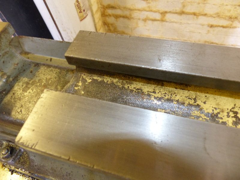

09/04/2020 15:29:37
Hi there!
Now, where was I.........
Ah, yes, time to get the headstock off:-
Loosen capscrew on locking collar and remove, undo grubscrew in back gear and drift out quill to the right ( must get some new heads on My mallet, only had it 40 years..........
(Don't forget to catch the Woodruff keys.....)
60 Years of crud in there, but managed to find the 4 capscrews and remove them ( very tight! ), and lift the headstock clear:-
Bed wiped down for inspection and carefully lifted off and put to one side:-
A few 'manual' parting off marks on the top off bed but I have seen worse!
Wear variation measurements as follows (taken at 5 points along bed):-
1:- Total width across both bedways- 0.011 mm
2:- Horizontal width of rear bedway- 0.080 mm
3:- Horizontal width of front bedway- 0.006 mm
4:- Depth of vertical shear front of front bedway- 0.087 mm
5:- Depth of vertical shear rear of front beadway- 0.214 mm
6:- Depth of vertical shear front of rear bedway- 0.164 mm
7:- Depth of vertical shear rear of rear bedway- 0.064 mm
I am reading this as the worst wear is on the 2 inside vertical shears.
Not being very knowledgeable about these matters, could somebody set Me on the right track here as to whether the bed is in need of a regind or is it servicable?
(I'm not sure if all the above measurements are required, opinions vary, so I took them all anyway!
Next job is sort the rising blocks, drip tray, switch removal and clean up the cabinet ready for stripping / re-painting.
Thanks for looking in!
Cheers, Pete
