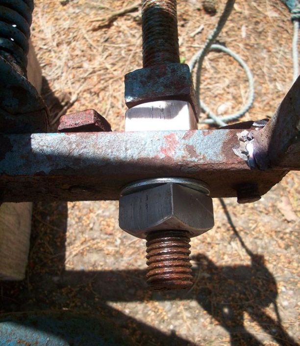

24/06/2021 12:41:13
Posted by Andrew Johnston on 24/06/2021 11:32:34:
Posted by martin haysom on 24/06/2021 11:14:12: Similarly you'll need a large workshop gorilla to drive the tap by hand, as well as the problem of keeping it perpendicular. It's simpler to rough out by screwcutting and then clean up with a tap.
I wanted to do the job without spending a lot on tools so I cut a test thread using one of the old nuts to check it. It wasn't till I'd made the test thread a little undersized that I realized that the sample nut was distorted so at that point I chickened out and bought a second hand tap to finish off. My gorilla was off that day so I had to do it myself and even though the tap was only taking off a smidgin I still needed 12" of scaffold tube on the end of a 12" wrench to turn it. Not the sharpest tap maybe but still, I definitely wouldn't fancy my chances of doing that way from scratch or getting the Boxford to turn it even if I could hold such a tap in the tailstock.
William.
24/06/2021 10:13:28
Posted by not done it yet on 23/06/2021 18:50:42:
I am wondering how William is currently cutting his 42mm pieces from his 50mm (42mm) bar.... and how he intends removing the 8mm (from the long bar, or a stack of short pieces clamped securely together🙂 .
All done now. Big cuts were to make big nuts for my brother in law's 1930s Ransome plough, 1 1/8" BSW 7tpi. He had some offcuts of 50mm x 25mm hot rolled (which were just too small to make 2 of course) so I started by rough cutting to length with an Aldi bandsaw. Then I milled to 41.5mm square 2 at a time using the aforementioned 60mm face mill. I did use the bandsaw to rough down the second side on some of them to see if it saved time on milling - it did. Final op on the mill was to centre drill then into the 4 jaw on the lathe to drill, bore and screwcut.
big square nuts 02.jpgbig square nuts 03.jpgbig square nuts 04.jpgbig square nuts 05.jpg
22/06/2021 16:45:11
Getting more confident using my first mill, a Chester 626 and experimenting with heavier cuts now the novelty of it all is being overtaken by a desire to get the job done in reasonable time. I'm wondering what people would recommend for shifting metal fast on a small mill? For instance I've just been making big square nuts for an old plough and needed to take approx 8mm off the edge of some 25x50mm hot rolled steel bar. I found I could take a 1 mm cut with the big (60mm diameter maybe) brazed carbide tipped shell mill that came with the machine but once that is blunt I'm thinking to invest in something with replaceable inserts but would appreciate any advice on how big to go, how many inserts and what type will give the best performance?
Thanks, William.
