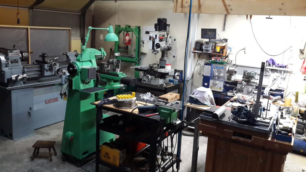

I am a Toolmaker by trade and basically make and machine up anything I am able to. Have my own way of doing the tricky bits that many may laugh at, but it works for me☺
I love old machines, or anything old for that matter and restore whatever I can get my hands on.
I rebuilt a Land Rover Defender from the ground up in 2 years. I ride an old 1981 model R80G/S.
Attached is a pic of my small shop..devil
