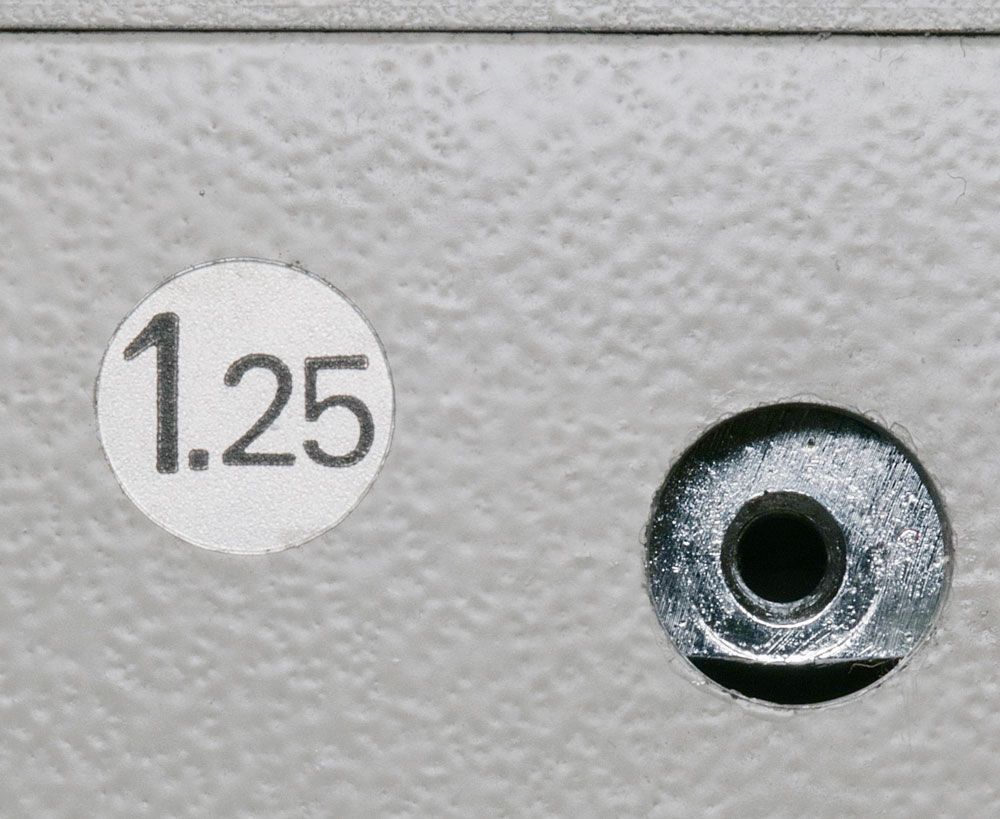

Not sure where you mean a sleeve.
There's no space between the surface which has a circular depression in it, and the inside of the end which has the 1.25 sticker on it. Maybe 1mm - enough for a washer is about all. Maybe there was a washer or washer pair once, but there isn't much thread...

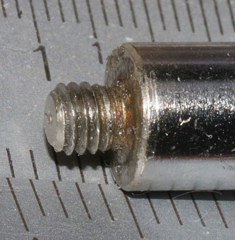

On looking closer
Tell you what, I've had an idea - why don't I drill and tap and cut off an HT screw and.....nerd
By the way if you think that threaded bit looks bent, you're right, it is.

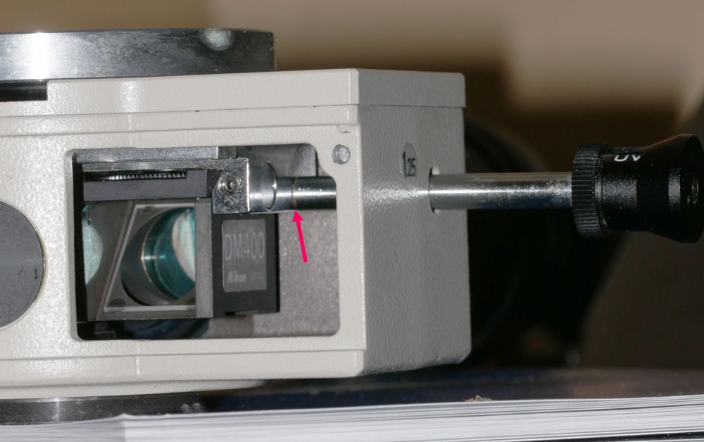

ANyway you asked for pictures:
This is the bit of microscope, the one existing rod is in place, screwed in a the point arrowed. It IS steel of some sort that it goes into. As you can see the rod goes through a large hole. Quite why they break I don't know.
It's moving a filter cube in the fluorescence illumination head of a 'scope. There are two filters and a dichroic mirror in the cube. You use light of wavelength X, which reflects through the objective lens onto the subject, which you preload with fluorophores which emit at a different wavelength Y. None of X gets up the eyepiece / camera, so you only see your excited bit of subject, emitting in its own colour. Then you use a different excitation wavelength and cube and different fluorophore, for a different bit of your subject. The light source is usually a mercury arc lamp, though LEDs are replacing them because they're made with a narrow colour bandwidth.
Normally you tag a protein or drug or whatever so you can see where it's got to. You can tag cancer cells or TB cells, or things smaller than a wavelength of light. They emit so you know they're there.

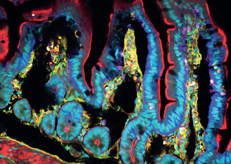

Here's a picture c/o Zeiss of a bit of gut, with ten different fluorophores and sets of cubes/filters.

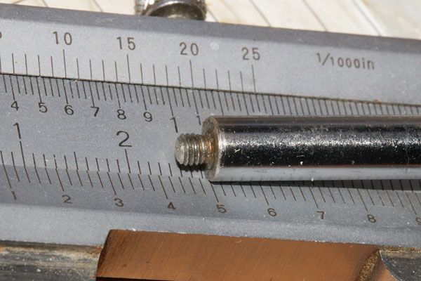

Woo, 6 answers, all a bit different! Thanks.
I reckon I'll try 303, no relief, and a couple of washers to bridge over the unthreaded mm or two..
I don't think the stuff it's screwed in to is tough. Good idea to make 2
Maybe I ought to waist part of the unseen part of the rod down to 2.5mm so I don't get another bit of broken off thread to winkle out  sarcastic 2

I need to make a 3mm male thread about 5mm long on a 6mm rod. It's an actuator on a microscope. It (originally) had a knob on the other end - not really necessary. The rod is about 100mm long and not well supported, so the original threaded part tends to snap off.
I have access to a small Chinese lathe in a makerspace, and dies.
What's the best material for ease of working, + strength. How about 303 stainless?
