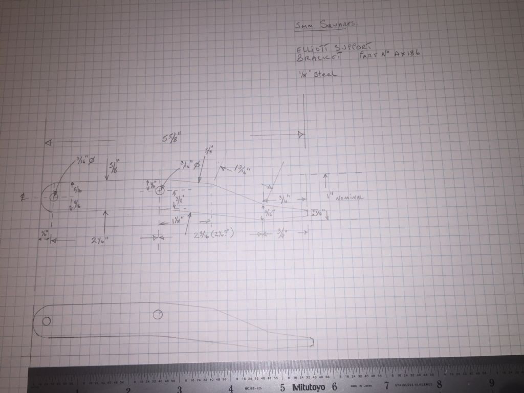

17/05/2021 08:34:10
These are the measurments from my bracket. The machine is imperial and the tolerances are reasonably wide for this bracket. Let me know if I missed something.

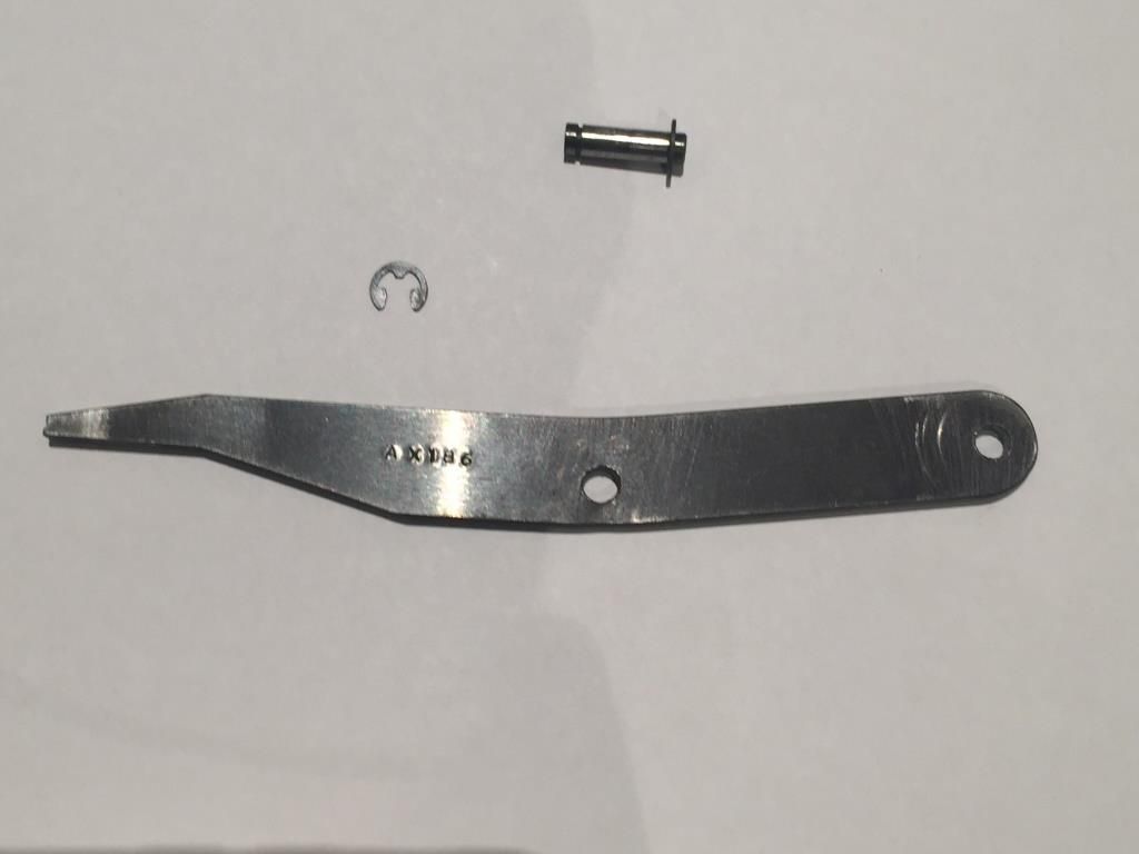

16/05/2021 10:48:17
Hi Zeek,
This is my support strap. I'll get it measured up for you and post the details.
