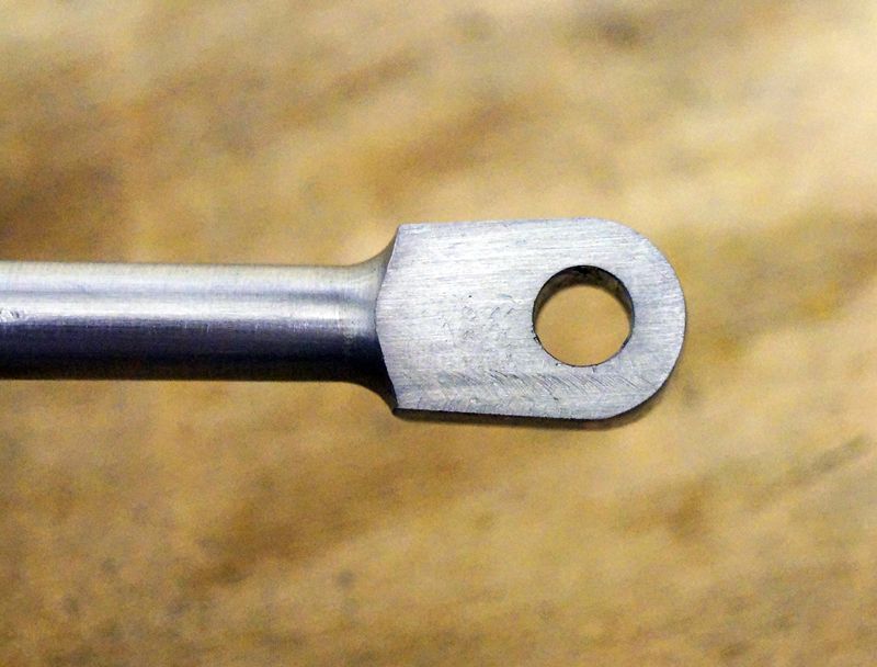

24/09/2019 17:50:46
Posted by JasonB on 23/09/2019 17:04:44:
That'll do. Hardly shows inside the cross head anyway.
Thanks Jason, its not the shape I had in mind but my error on the RT put paid to that, once I had it filed to something reasonable I called it a day.
24/09/2019 17:28:31
The conrod is not too far away made up the big end strap today, still have an oiler to make and fit plus it all needs a good clean up. I need some small head 4BA setscrews for the finished item but I made up a couple for now from a pair of small head nuts and some studding. The pair of big end bearings are a good fit and I used the boring head for that.
To be honest I am feeling a bit chuffed, a year ago I would never have thought I would be able to make something like this. I,ve had a lot of help and advice from you guys of course but I must have learnt a bit of something along the way.

23/09/2019 16:56:35
I had a mishap today whilst shaping the conrod small end on the rotary table, the part moved and the tool dug in. My fault, I found that I had only secured one of the two clamps..blush
I thought the part probably scrap but I set to with the files and shaped it by hand, its the best I could do in an attempt to save it. What do you think, acceptable or bin it and start again ..?
