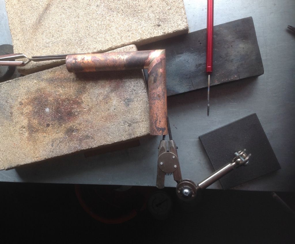

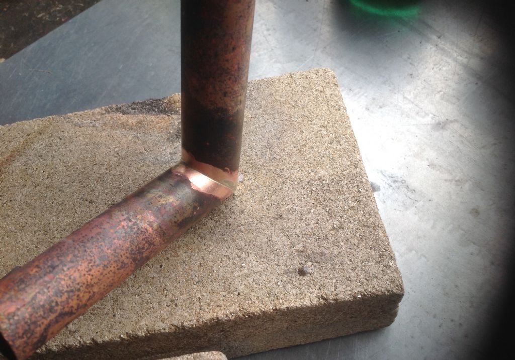

Thread: Soldering a mitred tube?
30/04/2021 17:07:04
Yes, I turned it over, after pausing for 30 seconds, to run more solder down the other side.
The setting up was rather fiddly; making sure the two parts were sitting where they needed to be in relation to one another and not under any tension that might work to drive them apart once heat had been put into them took a lot longer than the actual soldering.
30/04/2021 13:18:26
img_0544.jpgBit of a rush job preceding a hospital visit, but this is how I held the work:
Edited By Bill Phinn on 30/04/2021 13:19:39
