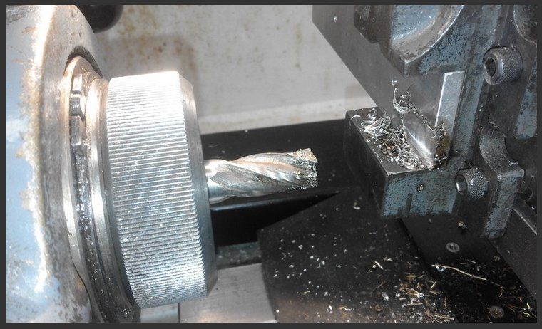

Thank you Neil, that advice is spot on. I discovered that the technique is to gently tighten the ring until it is "just" possible to move the lever fully to the left (it feels just like an over-centre cam action). The cutter is released by moving the lever to the right.
I was tightening the ring too much by hand which ironically meant that the collet was never gripping the cutter fully. Most of the collets have no markings at all, a few are marked Hardinge. Some are clearly well used, so a new set may be in my future!

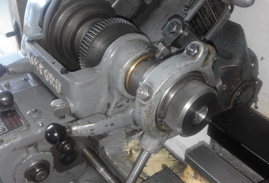

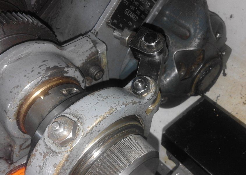

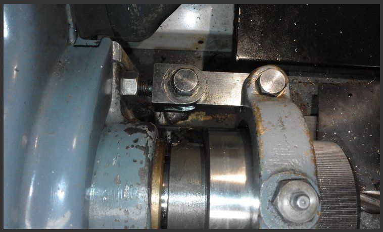

Thank you all for the very helpul responses. As suggested, I removed the capscrew (it was only finger tight) and fitted the stay in its place:
However...
The chuck doesn't hold the cutter very firmly. Tightening the chuck by hand as much as I can (gripping the ring with an old towel) the cutter pushes back into the collet even whentaking a light cut on some aluminium. I tried various cutter and collet combinations. I assumed that the purpose of the handle is to release the cutter, but when I tighten the chuck up as far as it will go, there's very little movement in the handle.
What am I doing wrong?

Thread: Myford collet chuck - how to fit it?
30/07/2017 09:04:19
Hello to all
I've recently purchased my first (new to me) Myford S7 lathe together with a very comprehensive kit of accessories. Setting up the vertical milling slide was straighforward, but when it came to fitting the collet chuck, I ran into a snag. There's an articulated stay on the side opposite the handle which has a threaded section and a locking nut. I can't see where this should attach to the lathe itself.
It's no doubt obvious to anyone who's ever used one, but not to me! Can anyone point me at a copy of the instructions for this chuck?
