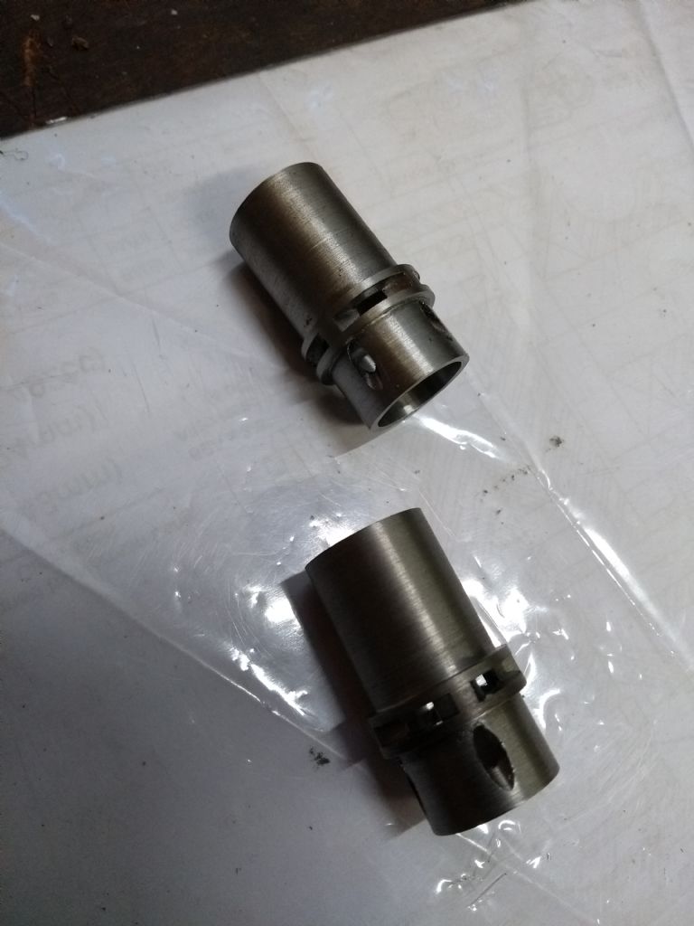

02/01/2020 11:44:05
Tug, both liners have the ports cut, my drg, as Jason's, shows to use a 1" x3/32" slitting saw plunged to 0.134" deep. Managed to find the right size saw at Castle Hardware? in Sheffield, last one they had and made both liners using that, hope the drg is right or it'll mean starting over.

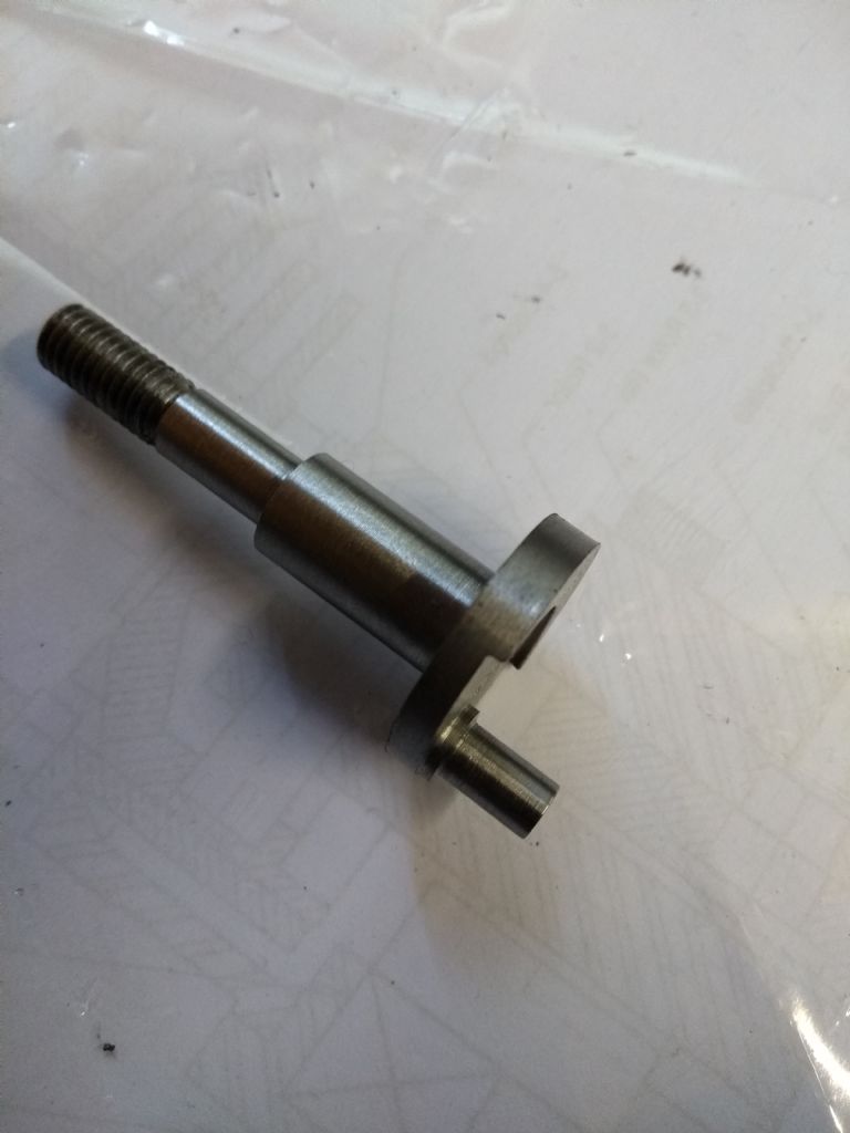

11/12/2019 19:23:15
img_20191205_181415751.jpgPicked up again after doing some work on my Velocette. Made the rotor, backplate and needle valve and the liner. Made the first liner from what I thought was EN1 but was tougher to machine so made another from known EN1A which machined more easily, also machined it in a slightly different order, both turned out OK, left the bore 1 1/2 thou undersize ready for lapping. Plans show cast iron for the liner but advice was to use mild steel which I must prefer as it's not dirty to machine though the pistons will have to be cast iron, Will need to source a 'tired' mini lathe to do the lapping in as I've decided not to use the Myford for that job.

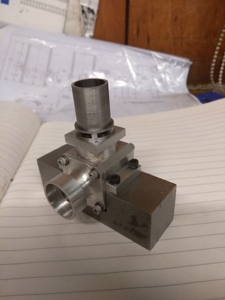

29/10/2019 18:16:25
Finish turning the crankshaft up today then rear housing next, doing the less difficult bits first.

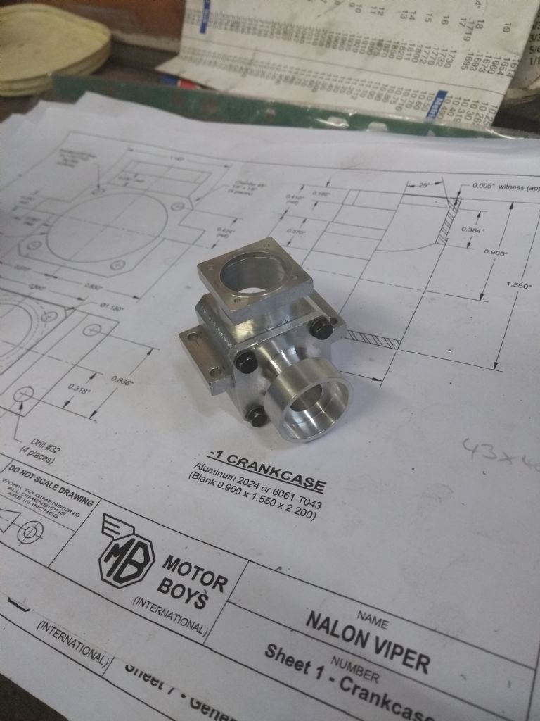

28/10/2019 15:09:15
progress so far on the engine. been searching for 6ba cylinder holdown studs but nothing at length needed (1 3/4" so most likely use 3mm.
