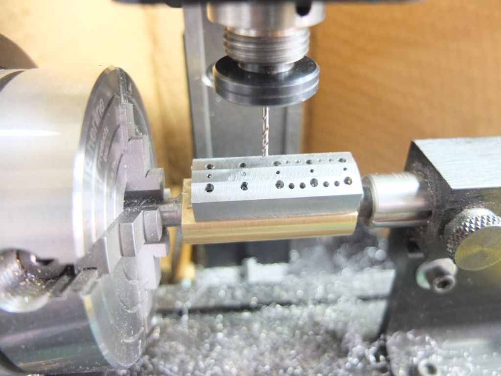

27/11/2020 15:34:42
I made this gadget (mandrel?) to hold the cylinder heads while I milled it and drilled and counterbored the inclined valve holes.
It is basically a 18mm diameter brass bar with 4mm removed on the flat. The silver steel rod is 8mm so I can hold it in various tool holders and collets.
The idea behind this is that the 16 degree inclined valves converge at a point 5mm below deck height, the bottom of the cylinder head. If I axially centre a cutting tool, I can do all the operations just by rotating 16 degs. either way.
The above photo were taken after I'd used it, hence the square pattern of shallow holes where the drill (intentionally) broke through.
Here it is set up and the flats being milled.
It took me a long time to set this up. I had to clock it axially and make sure it was centred both ends. It seemed like hours with a little rubber hammer tapping things true before I was happy. This was done before I attached the workpiece.
After that it was drilled 1.6mm through, c/bored 2mm for the valve guides and c/bored 2.7mm for the springs.
This worked a treat. My Y-axis remained locked for the whole process.

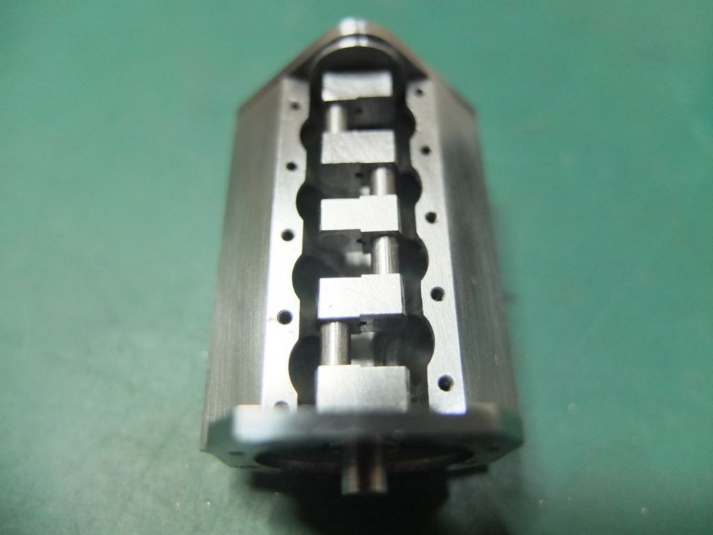

Before I went any further, I thought I'd test fit them on the crank.
A fiddly job attaching these but everything fits and moves nicely with minimum play. The middle one at the front looks like it isn't straight but that's the camera angle.
I then tried the whole assembly in its bearings in the block.
The conrods do foul the block in parts but this is because they are no liners or pistons in yet so the rods are rotating more than intended.
I've got to say that it doesn't look like the bottom end of a racing engine - more like some late Victorian marine engine. The thickness of the conrods is massively overscale. This is a consequence of using the smallest screws I had.
Even then, I had to turn down the heads to 1.8mm and dome them for clearance.
This is also the reason why there is only two bearings. There just wasn't space for other journals.

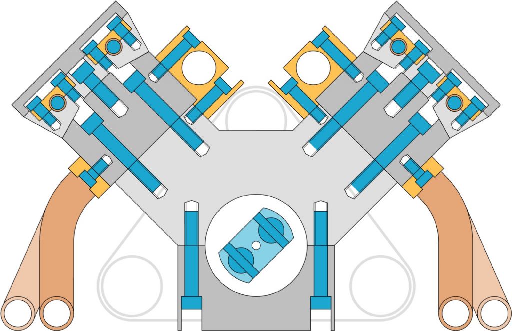

03/11/2020 17:53:20
Here is another cross-section, this time between the cylinders.
When designing this, I had a bit of a headache making sure the screws didn't clash with anything or each other. The problem is, even using the smallest economically available, the screws are grossly over scale.
I'm using M1.6 allen screws with the head turned down to 2.35mm to hold the sump, block, heads and cam carriers together.
12 BA cheesehead screws with the head turned down to 1.95mm for the con rods, exhaust and inlet manifolds and also the cam covers.
I will use either M1.0 or 14 BA cheesehead to secure the cam shaft. I want to find a good quality supply of steel screws first(non-stainless, I'll be blueing them). When I find them, I'll buy the appropriate taps. If anyone has any advice on this, I would be grateful.
Steve

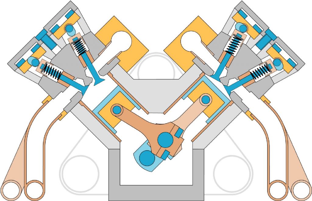

02/11/2020 19:46:56
Here is a drawing of a cross-section through the cylinders. It is sort of colour coded. Grey is EN3B, light blue EN1A, dark blue are screws and silver steel and orange or brown are brass except for the exhaust headers which are copper tube.
The air is fed from the two brass vessels (plenums?) in the vee.
This a hypothetical cross-section as there are 4 valves per cylinder and the banks are staggered.
Edited By Steve Crow on 02/11/2020 19:48:28

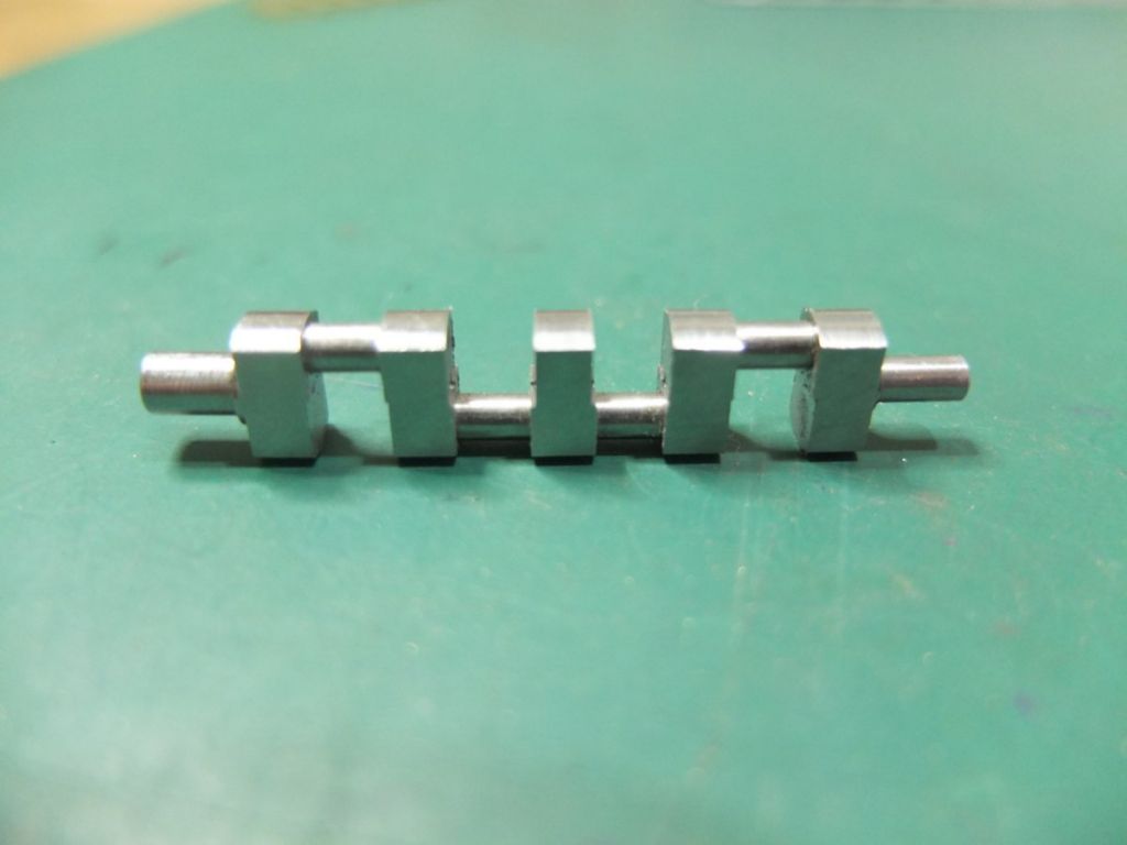

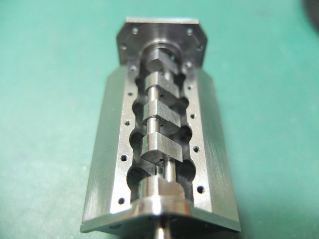

01/11/2020 16:33:20
Posted by Nicholas Wheeler 1 on 01/11/2020 16:21:54:
When I read you started with 1" square bar, I thought you were crazy.
I've just pulled a bit out of my stash, and now I know you're crazysmiley
It already looks cool. Are you going to fold a monocoque out of foil to mount it in??
I've actually thought about making a 1:12 English wheel to form beer can aluminium for said monocoque.
Has anyone heard of this being done before?
01/11/2020 16:27:11
Here is some of the crank in situ.
Steve

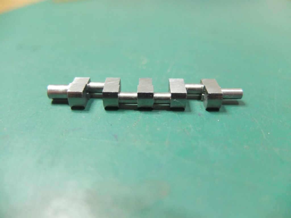

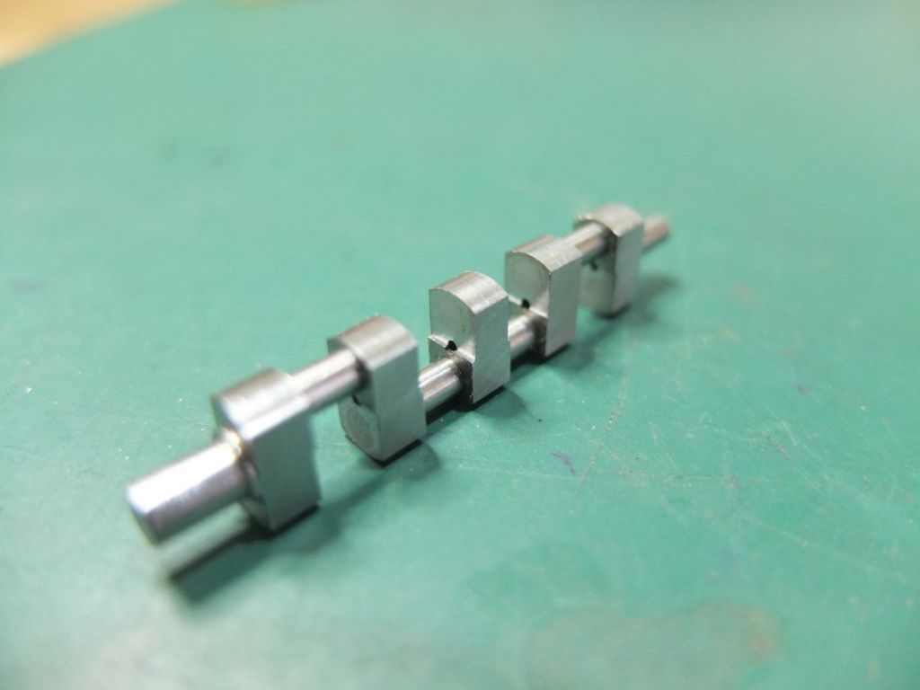

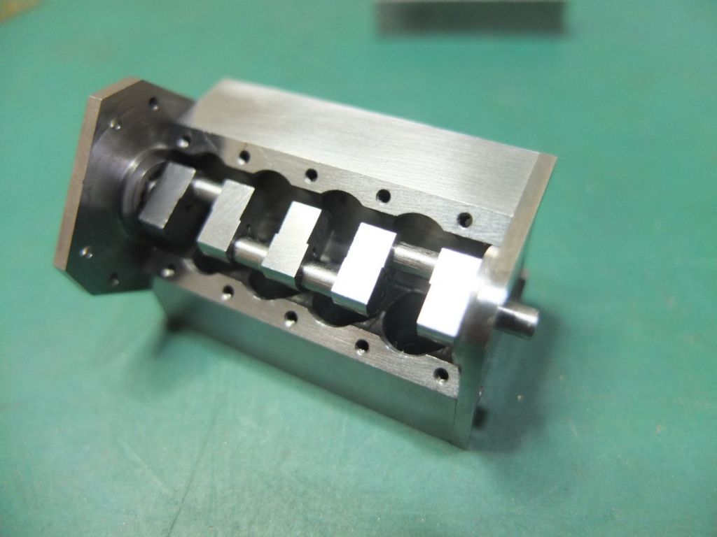

01/11/2020 16:22:12
The flat-plane crank is assembled from EN1A webs and 3mm silver steel journals.
The assembly was a tight friction fit then drilled, countersunk, pinned and riveted. 1mm mild steel pins were peened into the countersink then filed and polished over to render invisible.
The unwanted journals were then sawn out and the gaps between webs cleaned up on the mill.
This still needs a bit of cosmetic fettling.
Steve

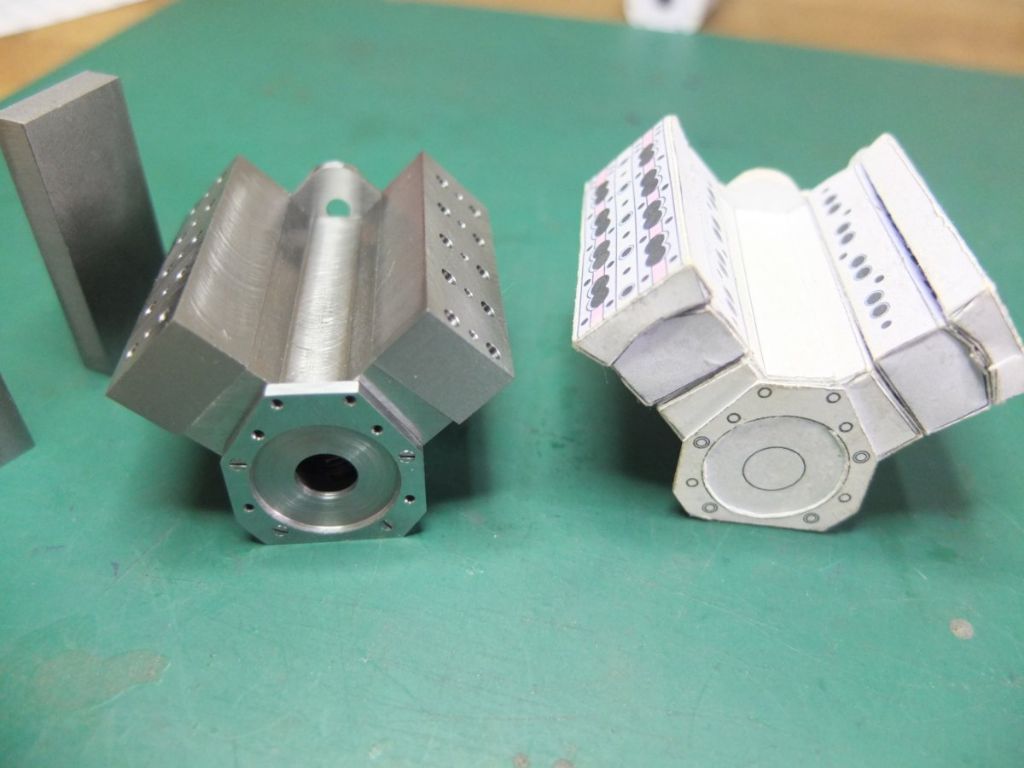

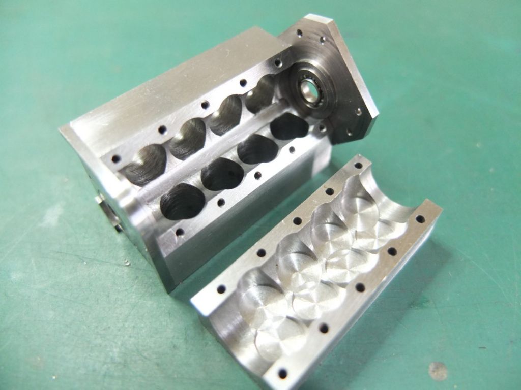

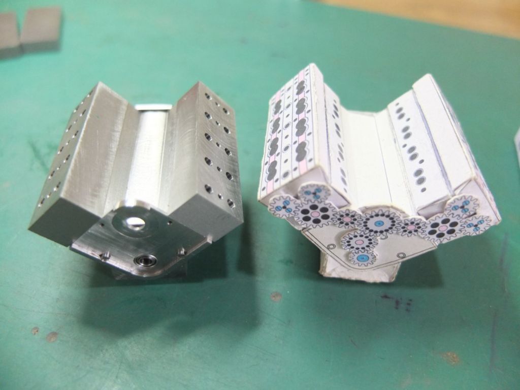

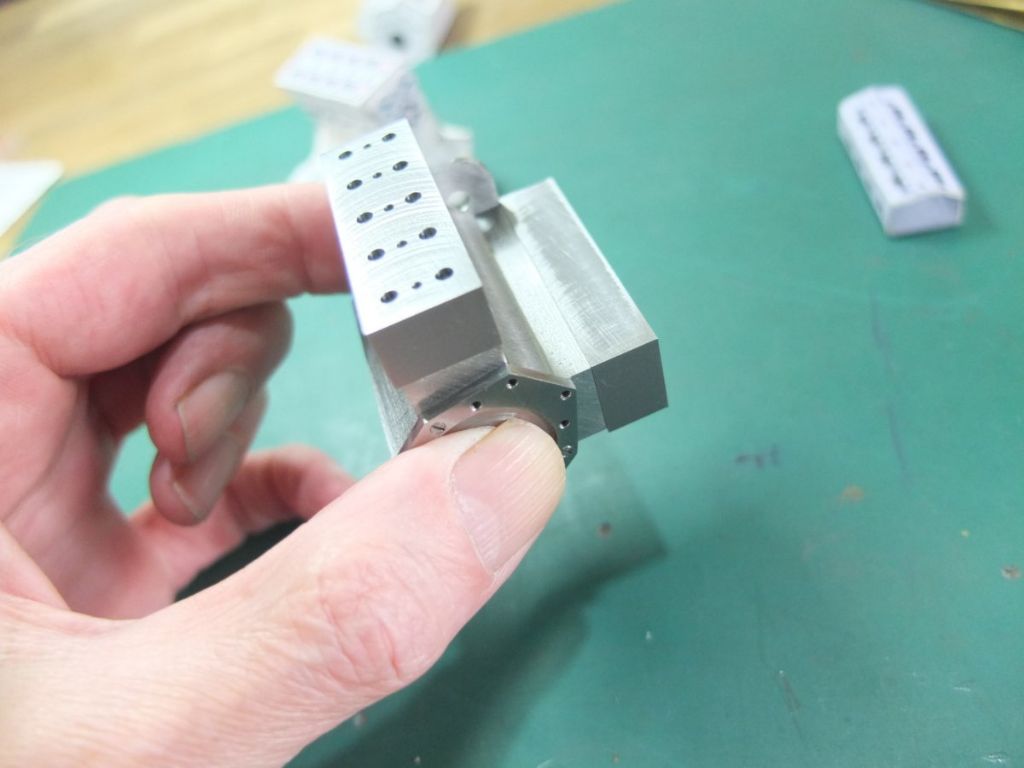

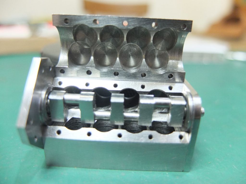

01/11/2020 16:03:55
I then fly-cut some steel to size for the cylinder head blanks and drilled and counterbored to suit the block. All in all, I had to tap 30 blind holes to M1.6 in the block. A bit scary.
I also cut to size blanks for the cam carriers. They can just be seen in the background.
Another shot.
Steve

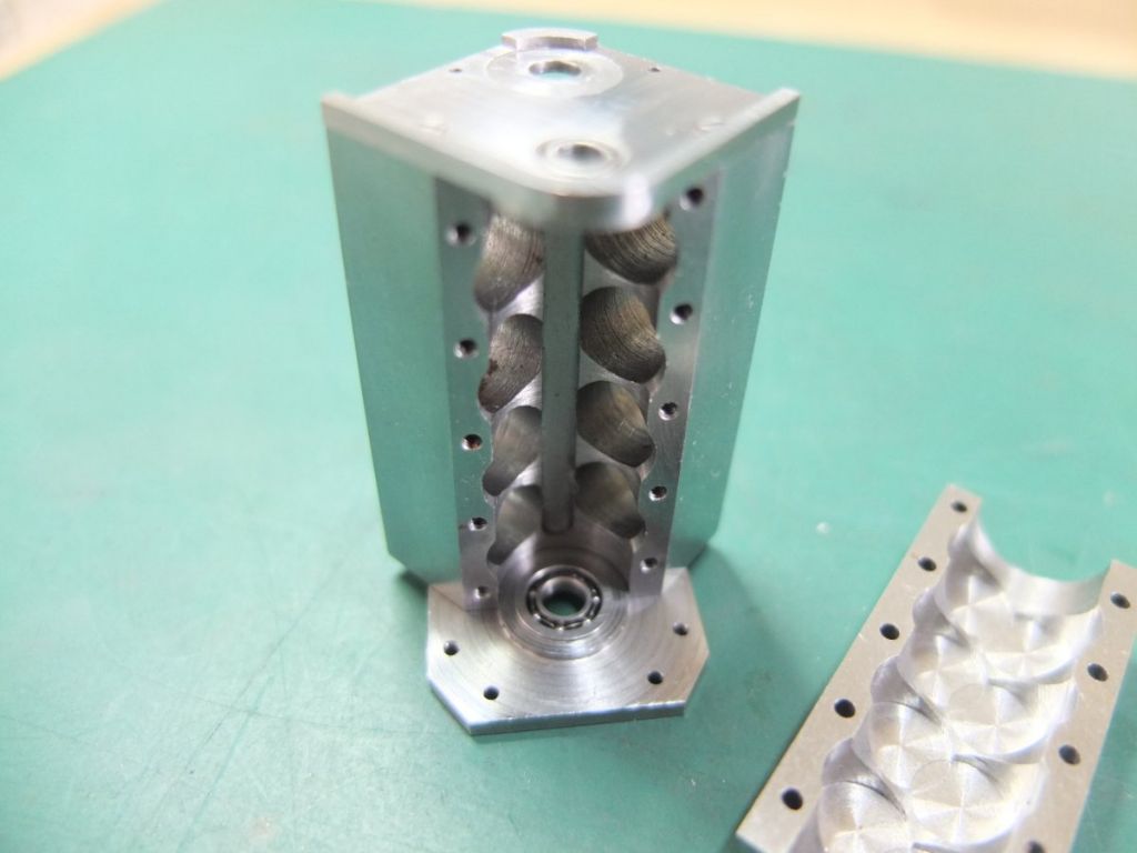

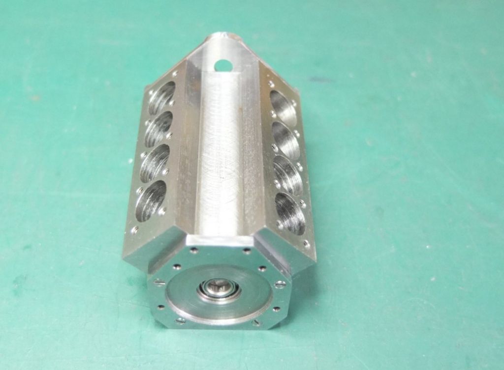

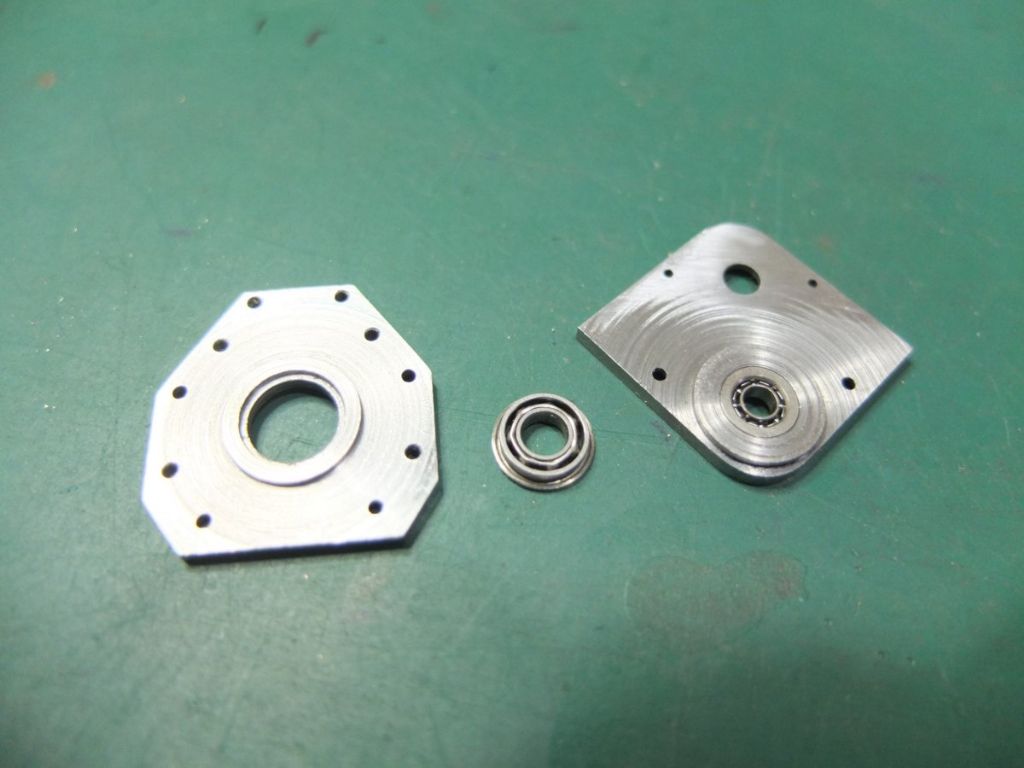

01/11/2020 15:48:00
I made some endplates from 1/8” mild steel flat bar. These hold flanged bearings for the crankshaft, 4mm at the gearbox end and 3mm at the cam-drive end. There is raised boss on the back of both which are a snug fit into the crankshaft bore to keep thing nice and true.
The one on the left will house the flywheel and the one on the right, the cam gear train.
The sump and block were drilled and tapped 12BA to secure the endplates and everything was assembled.
