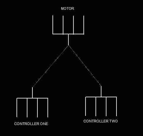

It would need to switch the 4 wires of the motor between the 4 outlets from controller one and the 4 outlets of controller two. I don't know what the name of such a switch is which makes it hard to find out where to get one. Can anyone tell me?

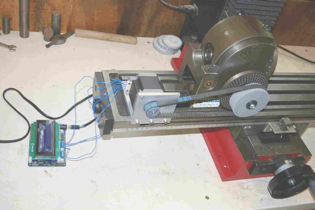

I think I've come up with a working digital dividing head. I stripped out most of the Freetronics example sketch, leaving me with only the instructions required to run one motor a specified number of steps in one direction. The modified sketch is:

I slowed it down by increasing the pulse duration to 500 uS and set the motor to rotate 3 revolutions by setting the steps/revolution to 4800. I disconnected the USB connection to my PC and the external 18V supply to the controller. I found that when the external power supply was reconnected, the stepper motor rotated three revolutions and stopped. This is what is needed to turn my dividing head.

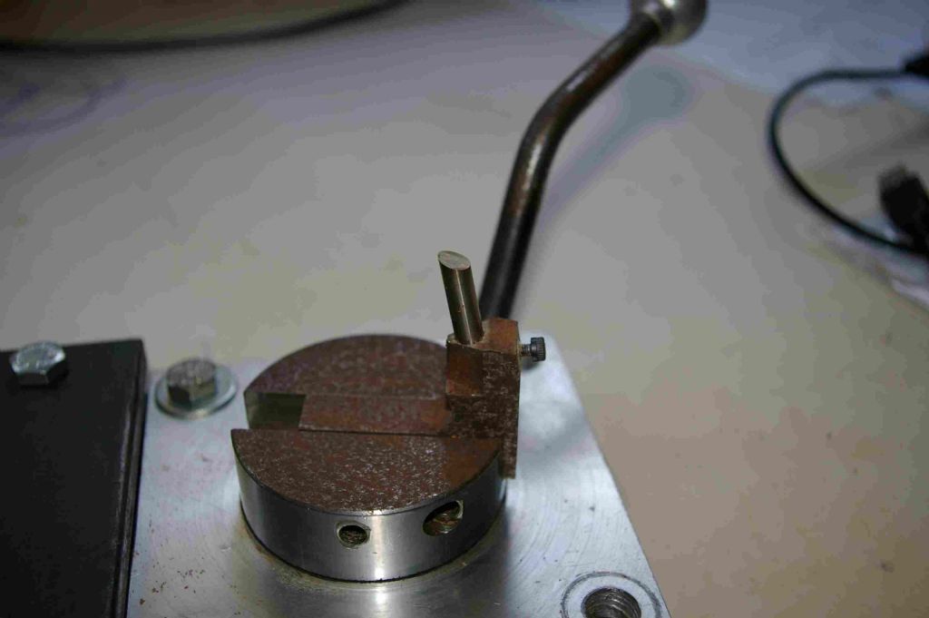

I connected the motor to the dividing head using a toothed belt and a 15 tooth pulley on the motor and a 45 tooth pulley on the dividing head. The gearing in the dividing head is 40X so the three revolutions of the stepper motor resulted in the dividing head rotating 9 degrees. I've included a couple of photos of the setup.
There is a indexing plate on the head with holes every 10 degrees which can be engaged by a pin on the main body. After setting the dividing head to 0 degrees, I applied the power to the controller from the battery 10 times and found the pin engaged the indexing plate perfectly at 90 degrees. The same thing happened at 180, 270 and back to 0 degrees again so the stepper motor is as accurate as the indexing plate.
This setting enables a 40 tooth gear to be cut. I can of course change that to any number of teeth I want by connecting the Stepduino to my PC and changing the number of Steps/Revolution in the sketch. This is probably not much more time consuming than setting it using the LCD screen with all the complications with the sketch and the hardware this would entail.
One thing worries me a bit. Given that it takes 1600 pulses to rotate the stepper motor 1 revolution and the gearing between the stepper motor and the business end of the dividing head (120:1) it requires 192,000 pulses to rotate the work one complete revolution. If, for example, I wanted to cut the ever popular 127 tooth gear, the number of steps/tooth required would be 1511.8 pulses. As the input to the sketch needs to be an integer, the StepsPerRev would need to be set at 1512. 1512 X 127 = 192,024pulses which is 24 pulses too many. This doesn't sound much but is 1.6% of the 1512 pulses/tooth. In other words, the final tooth will have 1.6% of its thickness removed and this will be worse if multiple passes are made when cutting a gear or if the decimal is closer to 0.5 rather than the .8 in this example.
One way around this would be to cut 103 teeth at 1512 StepsPerRevolution, then cut the remaining 24 teeth at 1511 StepsPerRevolution which would reduce the error to 0.07% for the last 24 teeth which is probably negligible. This can be done by reprogramming the sketch after cutting 103 teeth or, since I have the dual output stepduino, reactivate the Stepper Two output with the StepsPerRevolution set at 1511. After cutting 103 teeth the motor would be unplugged from output one and plugged into output two.

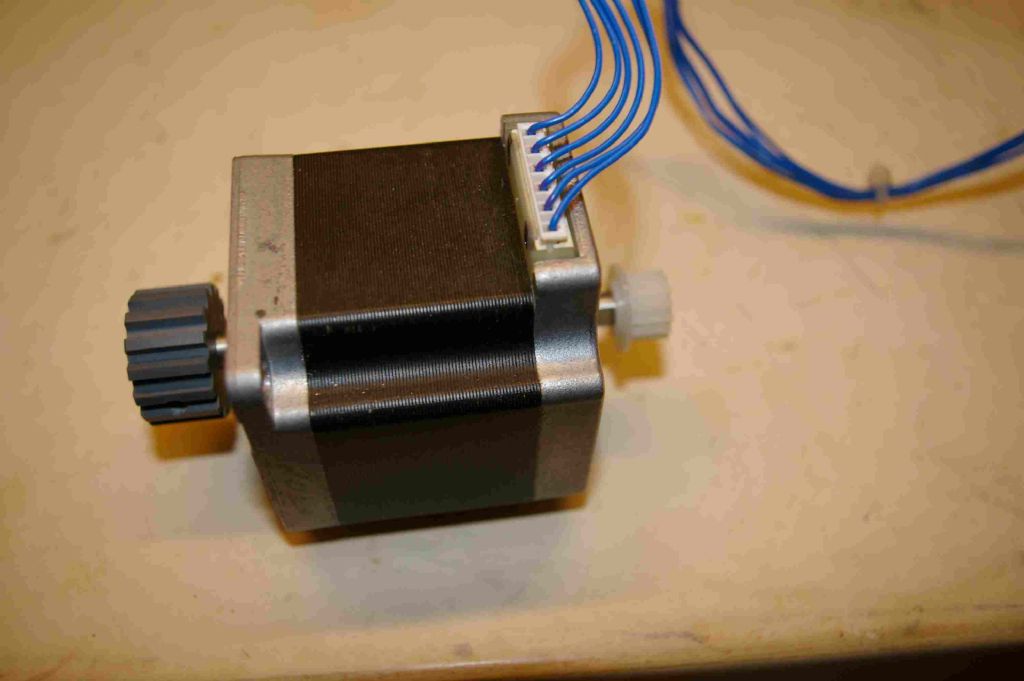

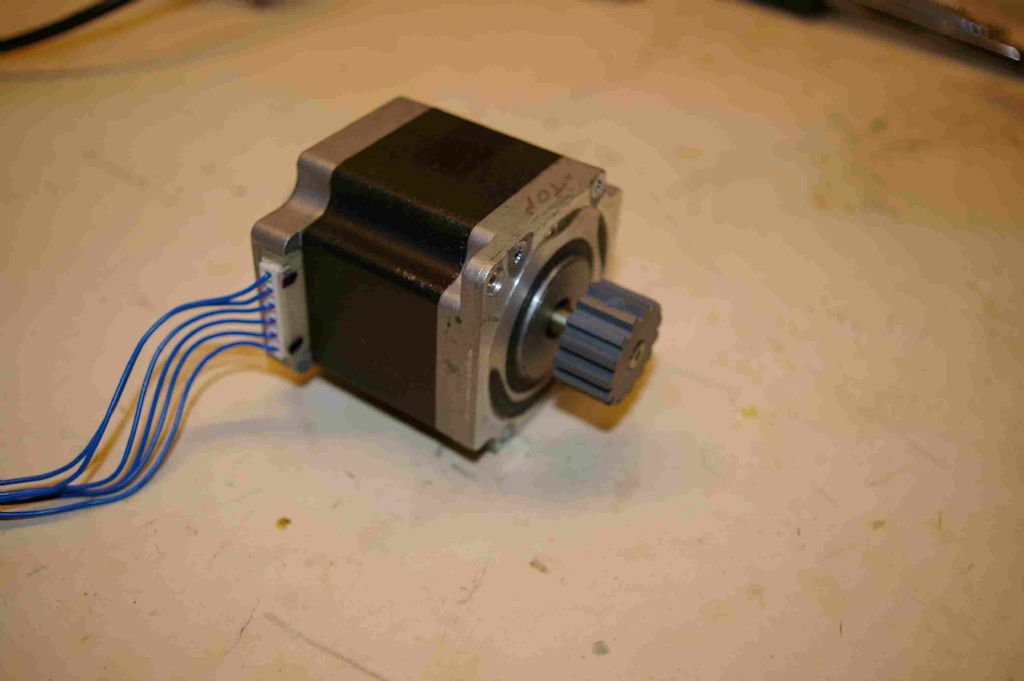

I've managed to get the shaft of the stepper motor to spin using the example sketch shown on the Freetronics website!
The sketch wouldn't compile but I think the problem was at the end of the sketch where there was a section which froze the shaft in one position. I deleted that part of the sketch and the bit that was left which turned the shaft one revolution forward followed by one revolution in reverse compiled OK.
I had a bit of a hiccup when connecting the motor to the controller. There are six wires coming from the motor so it can be used as a unipolar motor. The controller has only four connectors so the motor needs to be connected in bipolar mode. I assumed that the centre tap wires would be ignored but the motor data sheet showed the connections to be from the centre taps to one end of each of the windings for bipolar operation. I tried this and the motor just buzzed so I connected the ends of the windings and left the centre tap wires loose. The motor then did what it was supposed to and rotated back and forth. I had a bit of a play with the sketch and changed the speeds.
Anyway, at least I've got the motor to turn, I know the motor works and how to connect it to a controller so I'm making progress. I think I'll take John's advice and revert to using a standard Arduino for the time being. When I get more proficient I may be able to make use of the Stepduino.

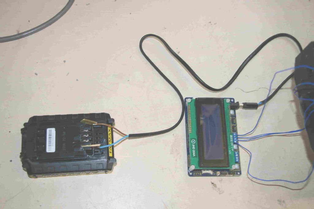

I've been to the Freetronics site but for a beginner like me it's not much use. I bought the Stepduino because I thought it would be easier to use for controlling a steeper motor because that's what it is designed to do. That doesn't seem to be the case.
Thanks John. I think I'll try hooking up the battery and using the sample sketch on the Freetronics website. If it works I'll have at least managed to get a stepper motor shaft to turn which will be a great leap forward. After that I think I'll use my standard Arduino and follow the multiple tutorials around on how to run stepper motors.

You seem to know a bit about the Stepduino so I'd like to pick your brains if I could.
I've managed to get the Arduino IDE talking to the Stepduino.
As I understand it, I'll need to provide an external power supply as the USB supply hasn't got the power required. I was intending to use the spare battery for my drill which is 18V. Is this OK? From what I can gather, the Input voltage can be 7 - 28V.
Can this power supply be connected when the Stepduino is connected to my PC via the USB port? I need the USB connection to download a sketch which will start to operate as soon as it is uploaded which will need the external power supply.
Do you know what the display screen is for? I can't see the point of it.
I may have made a mistake getting a StepDuino instead of using a basic Arduino with the required add-ons. There is virtually nothing around explaining how to use the StepDuino but heaps of information on how to run stepper motors using an Arduino.
If I can get the external power supply sorted out I may be able to run one of the sample sketches on the Freetronics website and maybe proceed from there.

Thanks John. I've measured the resistance across the coils and figured out the configuration which happily coincides with the data sheet. Now for the bit I'm not looking forward to - relearning how to use the arduino. I wish people wouldn't keep on about how easy it is to use - it's not.

A couple of years ago I bought a second hand stepper motor with the intention of using it to position my vertex dividing head and speed up cutting gears. I have a StepDuino to control it. It is a KH56 series motor with the first part of the serial number being KH56KM2. I have found a spec. sheet on line for this model but the last three numbers quoted are -911, -912 and -913 whereas the last part of the serial number on the motor is U037. I presume the U stands for Uni-Polar (there are 6 wires coming out) but the 037 doesn't correspond to what's on the spec sheet. The difference between the last three digits seems to be the motor voltage which changes from 2.3V (3.0A) to 3.6V (2.0A) and 6.71V(1.0A) with the power being about 7 watts for the three options.
Can anyone help me determine what voltage I should be applying to the motor? I'm a complete novice with these so don't assume I can see the obvious.
