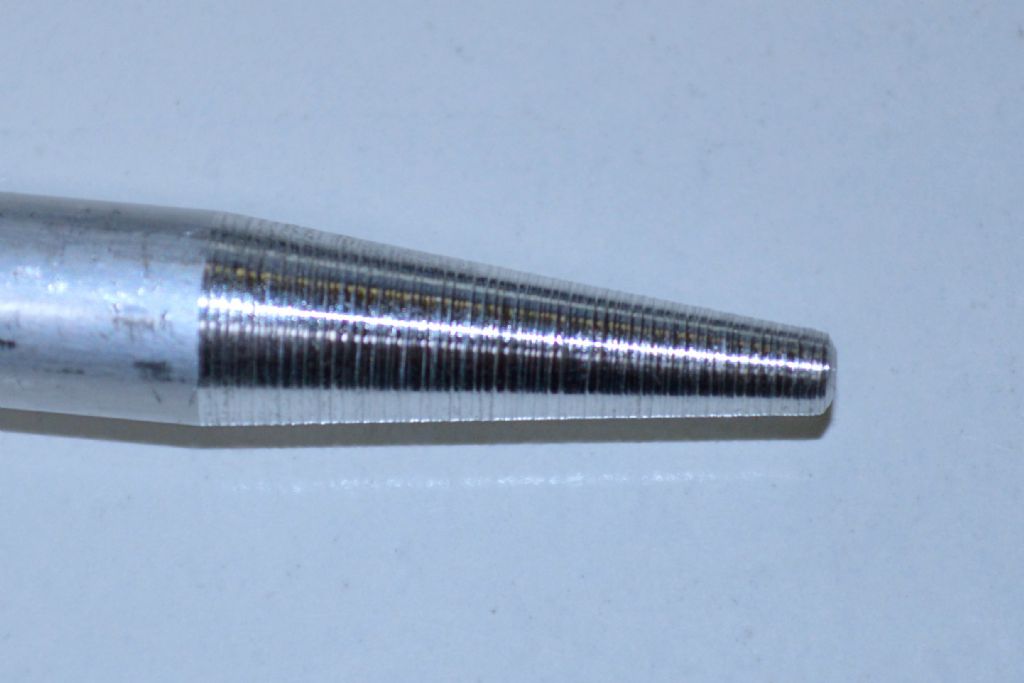

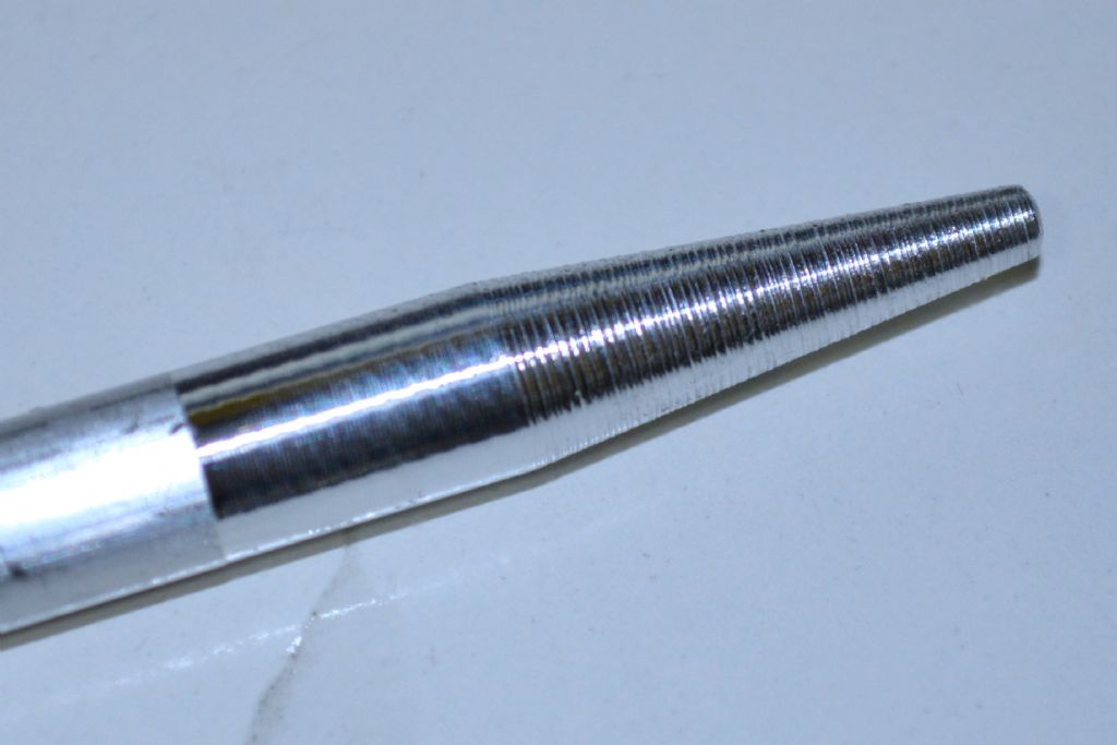

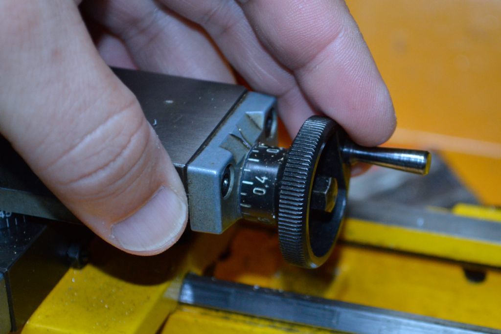

Thank you all for your help. I am convinced that the problem is not being able to achieve a smooth and continuous movement. I will disassemble, clean, lubricate and reassemble everything with care. I've also been training my hands and it's a little better. Soon I hope to have a better result and a photo to post.

20/11/2016 22:14:53
It is the feeding that is the problem. It does not have a smooth movement at all and it is very difficult to maintain a constant movement.
Maybe I'll fit a small stepper motor. First I will try to fine-tune the movement (and the hand)
An EMCO Compact 5
Vasco Reis
20/11/2016 21:54:45
It seems like I'm going to have a lot to practice. I've tried the power feed and the finish is perfect.
It is not easy because it does not have a smooth movement, I guess it needs tuning...
Thank you
20/11/2016 21:28:02
I'm doing my first experiences with the lathe. This aluminum part was machined at 1500 RPMs lubricated with WD40 and with CCGX09T304 for aluminum.
As you can see in the photo the finish is not the best. Any clue to what I'm doing wrong?
